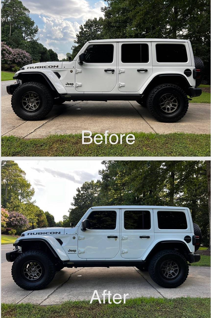

Jeep Wrangler JL Leveling Kit for '22 392 XR - Looking for advice/experience A65C3A81-3ADA-465E-A977-2402857532F7
After the Clayton 392 Performance Coils were installed, the Jeep gained 1 1/4” in the front (measured to the flare extension 40 1/4” before, 41 1/2” after) and just under a .5” in the rear (flare extension at 40 1/2” before, 40 7/8” after). Still a slight rake of about 5/8”, was 1 1/4” before (I do have a Warn Zeon 8S on the front). Finally looks like it should’ve from the factory.
Handles a lot better and doesn’t feel as soft when you get on the throttle and take turns. Also feels a lot more planted down the highway. Would 100% recommend to anyone considering them.
