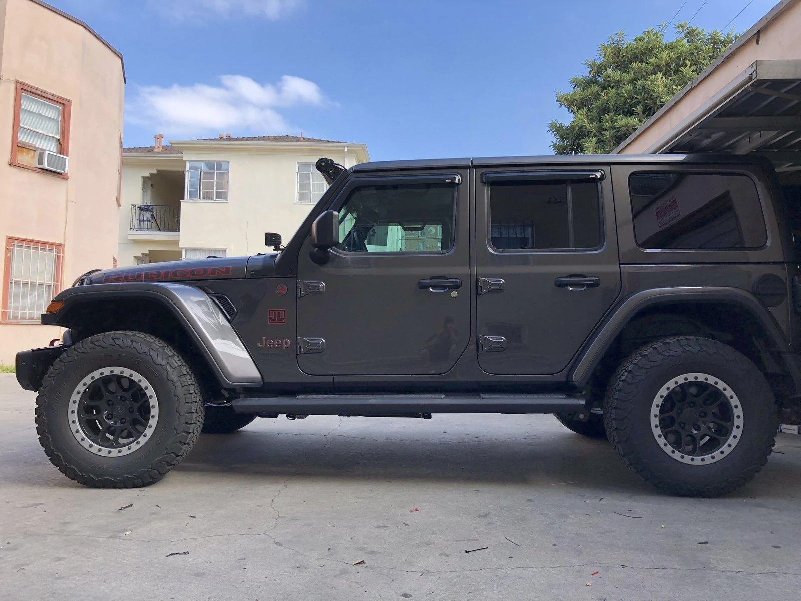

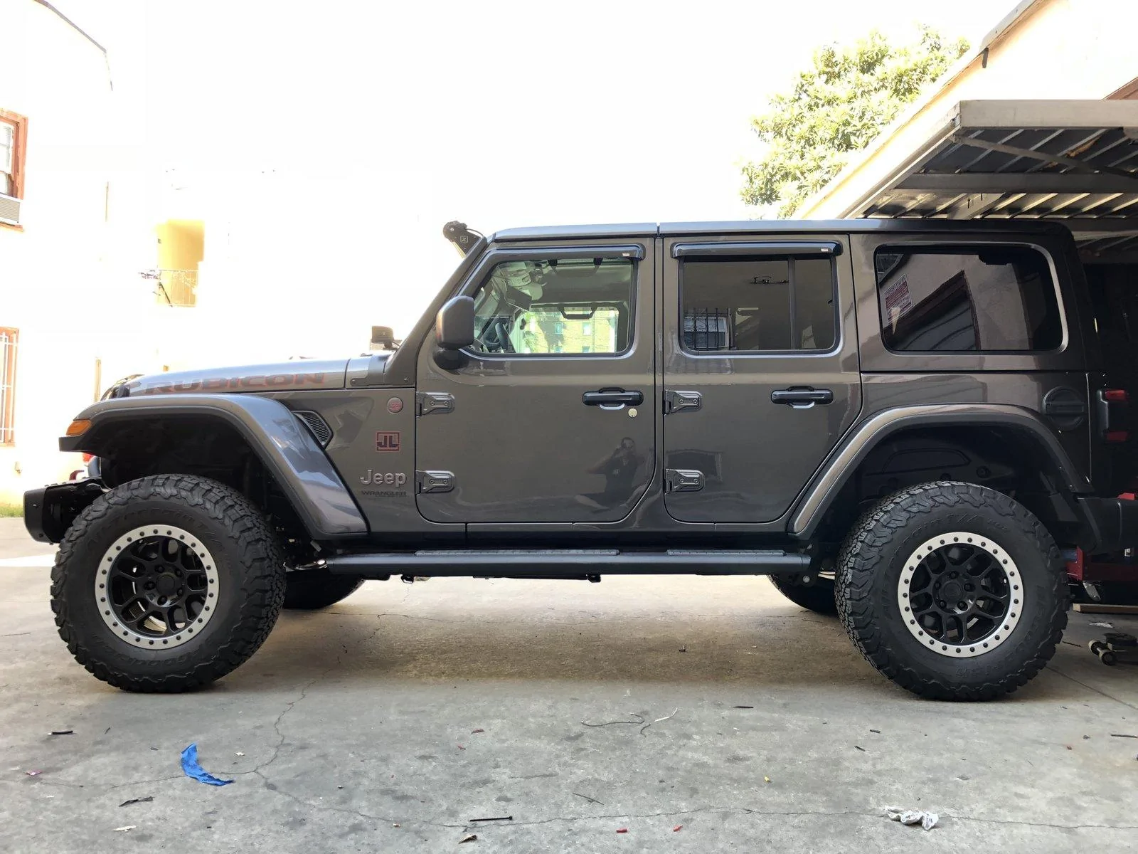

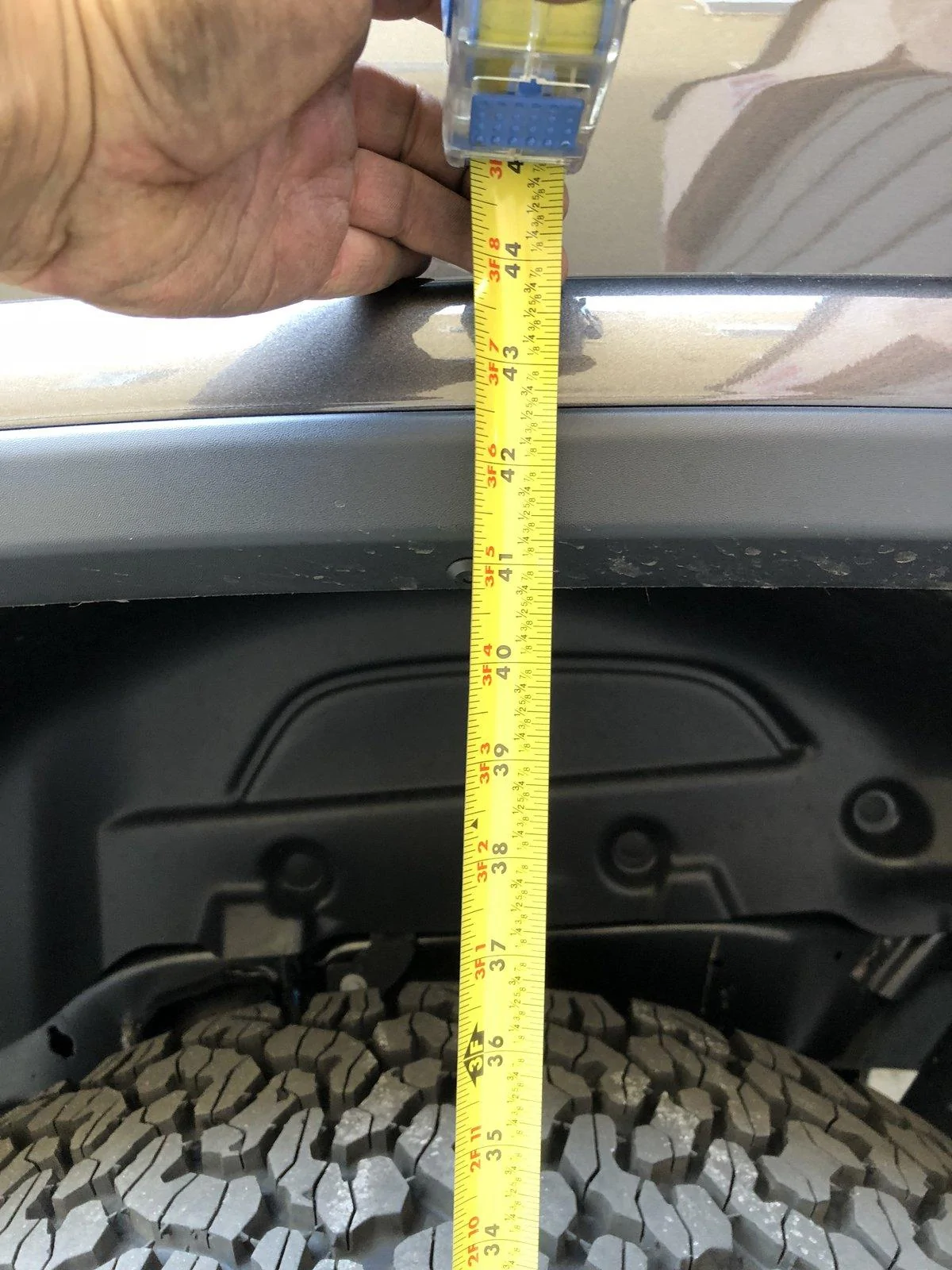

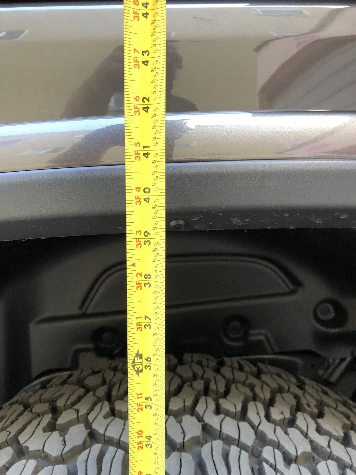

Hi members just like to share my experience with Teraflex Leveling kit
install was straight and easy rear was piece of cake i cheated with springs compressor haha
front had to drop the axle but don't need to remove everything from manual
install took around 3 hours by my self no help was need it
no other plans yet for more lift :) , enjoy pictures
