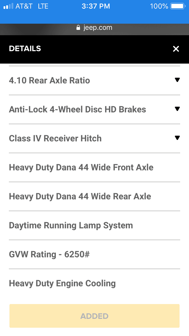

FCA is even giving non-Rubi Gladiators the option to get the Rubicon's front and rear wide D44's with 4.10 gears. That is beneficial. JK special editions had a rear locker or e-disco available to help bridge the gap between Sport/Sahara and Rubicon. For whatever reason they decided to not give the Moab anything.
Dana 44 will be standard across the board on the Gladiator, not optional. 3.73 drive ratio will be standard on the Sport and Overland, whereas the 4.10 is standard on the Rubicon and is part of the Max Towing package on the Sport.
