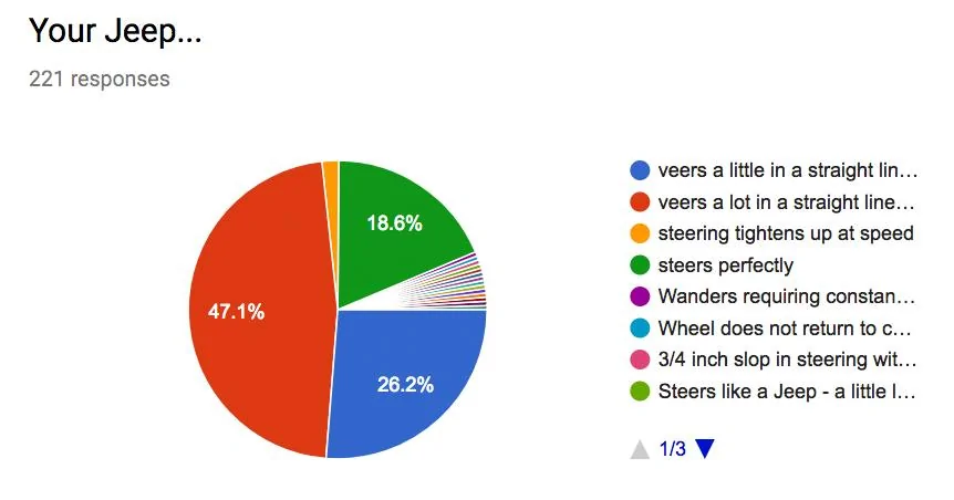

Steering problems go way beyond tire pressure issues:
1. Steering survey results: https://docs.google.com/forms/d/e/1...xM0ZQzjhMVaXo8TICWUZN3xrsSpGo3g/viewanalytics
2. To add your data into the survey: https://goo.gl/forms/uWOyTgyqG6AnNdEY2
3. Spread sheet version: https://docs.google.com/spreadsheet...AMpdgKt1oA5sT_aXI-hoYMCg4/edit#gid=1437013635
4. I found this steering survey info here: https://www.jlwranglerforums.com/forum/threads/wrangler-steering-issues-survey.12343/

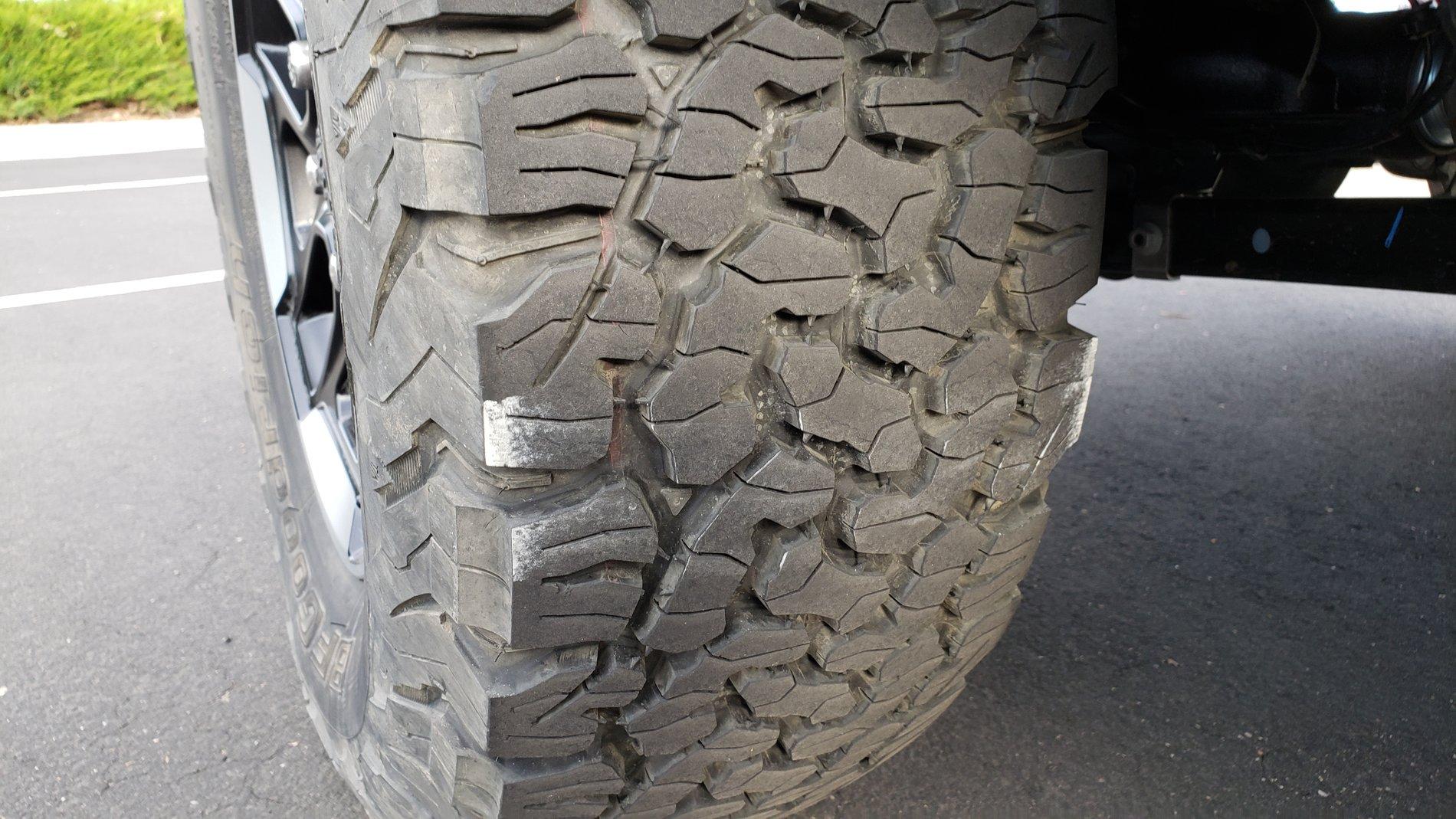

I realize this thread is a year old but I didn't find a current one for this subject. I got my new 2 door 2020 Rubicon last Saturday and have been driving it a lot both on/off road since. What I've found with regard to the factory specified tire pressure (37 psi) is that the steering is too sensitive and the handling is outright difficult at highway speeds (75). 2-door Rubys are more sensitive than 4-doors but I thought that highway handling was just not acceptable.
Off road, I've dropped the pressure to 20-23, depending on the terrain, which was perfect.
When I aired the tires back up I set the tire pressure to 31 psi, and the drive and handling got so much better. At highway speeds the tire pressure rose to 33. Today after reading this thread I got concerned that my tire pressure may be too low for the road so I decided to do a chalk test. With the tires at 30/31 psi I ran the chalk test twice and this is what I got on both front and rear tires:
Jeep Wrangler JL Rubicon Steering & Tire Pressure? 20190904_172536
This is the first time I'm doing a chalk test but having chalk left untouched on almost an inch on both sides of the tires tells me that the tires are definitely not under-pressurized and possibly still a little over pressurized, right? I mean, the center of the tire will wear out before the sides will. So, I don't understand why is the factory specifying a tire pressure that is way too high for this tire/load combination? Is there any downside to driving with 30/31 psi?

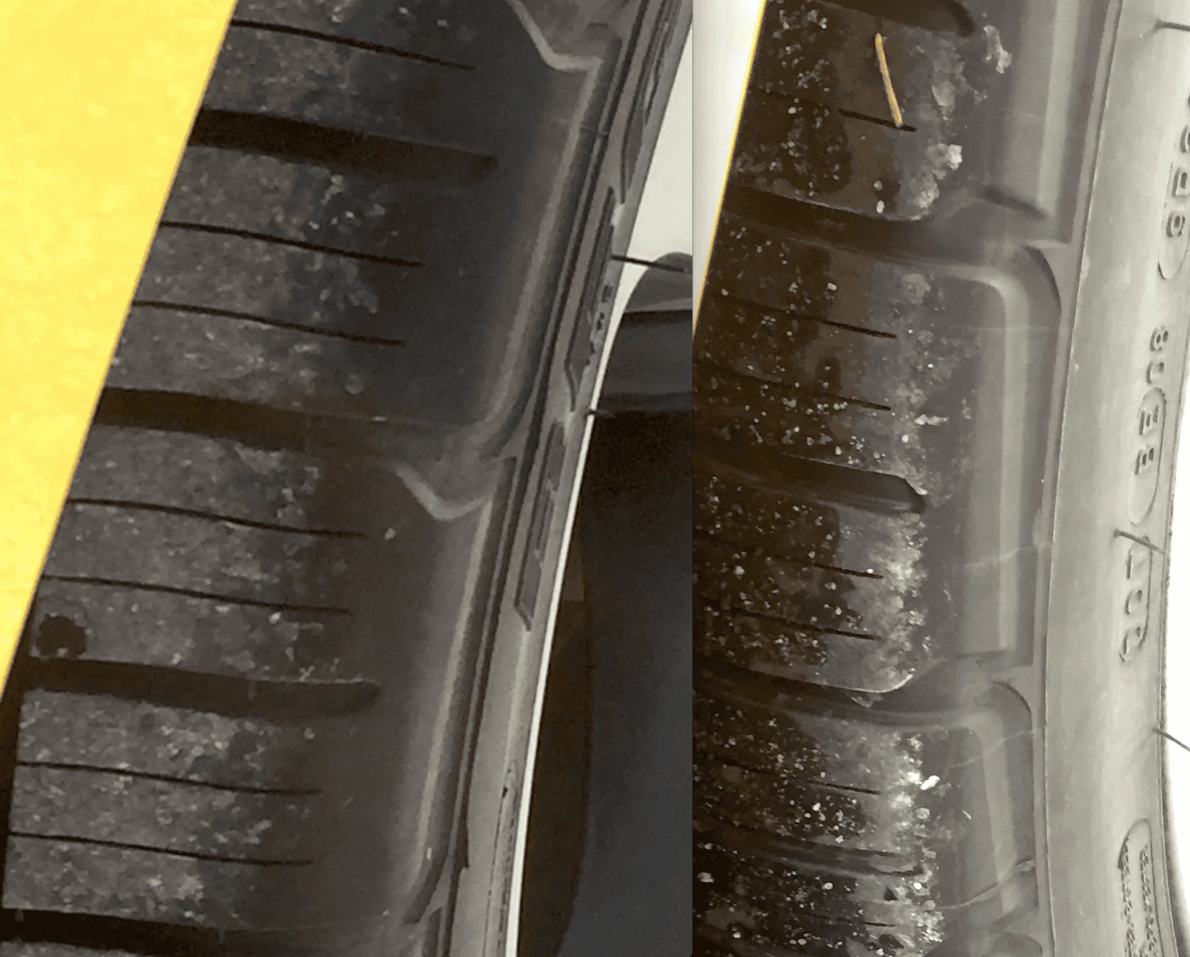

My advice is to chalk both a F and R tire and adjust as needed. Here is a pic of my Challenger with the tires at spec/same psi in all 4 tires. The back tires are wider than the front. You can tell the rear tire is not fully on the ground compared to the front. I ended up increasing the front psi a few psi and decreasing the rear a few. The back tire is on the left (less weight on it, and bigger contact patch. (notice the contact patch goes beyond the siping lines on the front tire and much less on the rear tire.
The spec'd psi is also a balance of MPG vs. tire life. I prefer to favor better tire life and better ride over MPG.
You might find you want a few less psi in the rear than in front.

Can you describe how you performed your chalk test to get the results in the photo?
