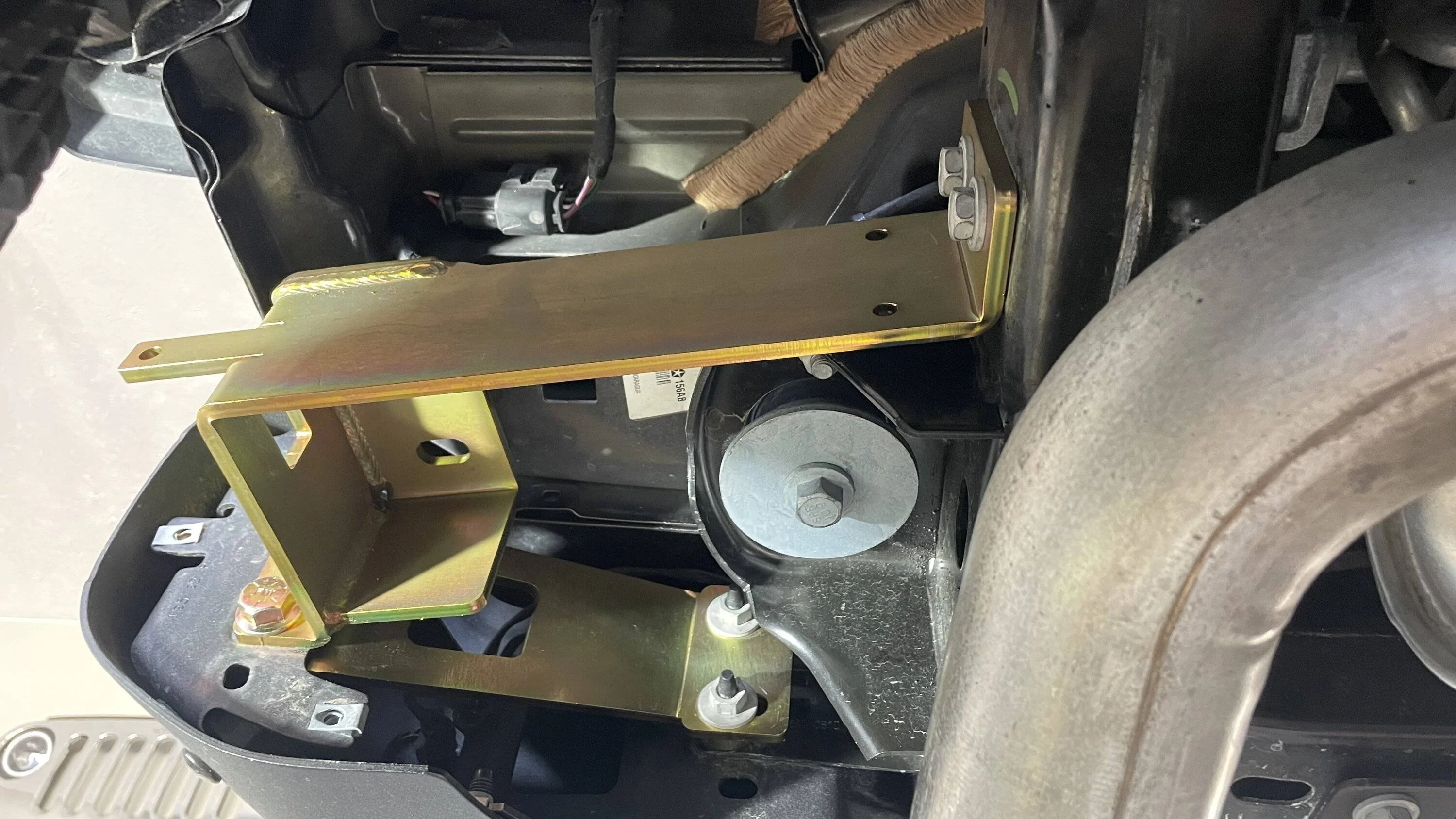

Hi Justin! Good seeing the new steering/track bar beef on your Jeep. I know that's not the easiest of installs.
Did you notice any difference in steering feel after the Track Bar Reinforcement/Sector Shaft Brace went on?
https://www.youtube.com/channel/UC5HJ5REOo6XbFuakJem6TTw
-Steven
Yes, I sure did. Really tightened up the steering wheel feeling. I have the drag link, tie Rod and falcon nexus stabilizer to go on here when I get more time too. It’s nice to do it stages to appreciate the little things one at a time.
I also added the MC rear bumper support brackets. Did you ever consider those? I figured a little insurance incase I catch a corner coming off something.

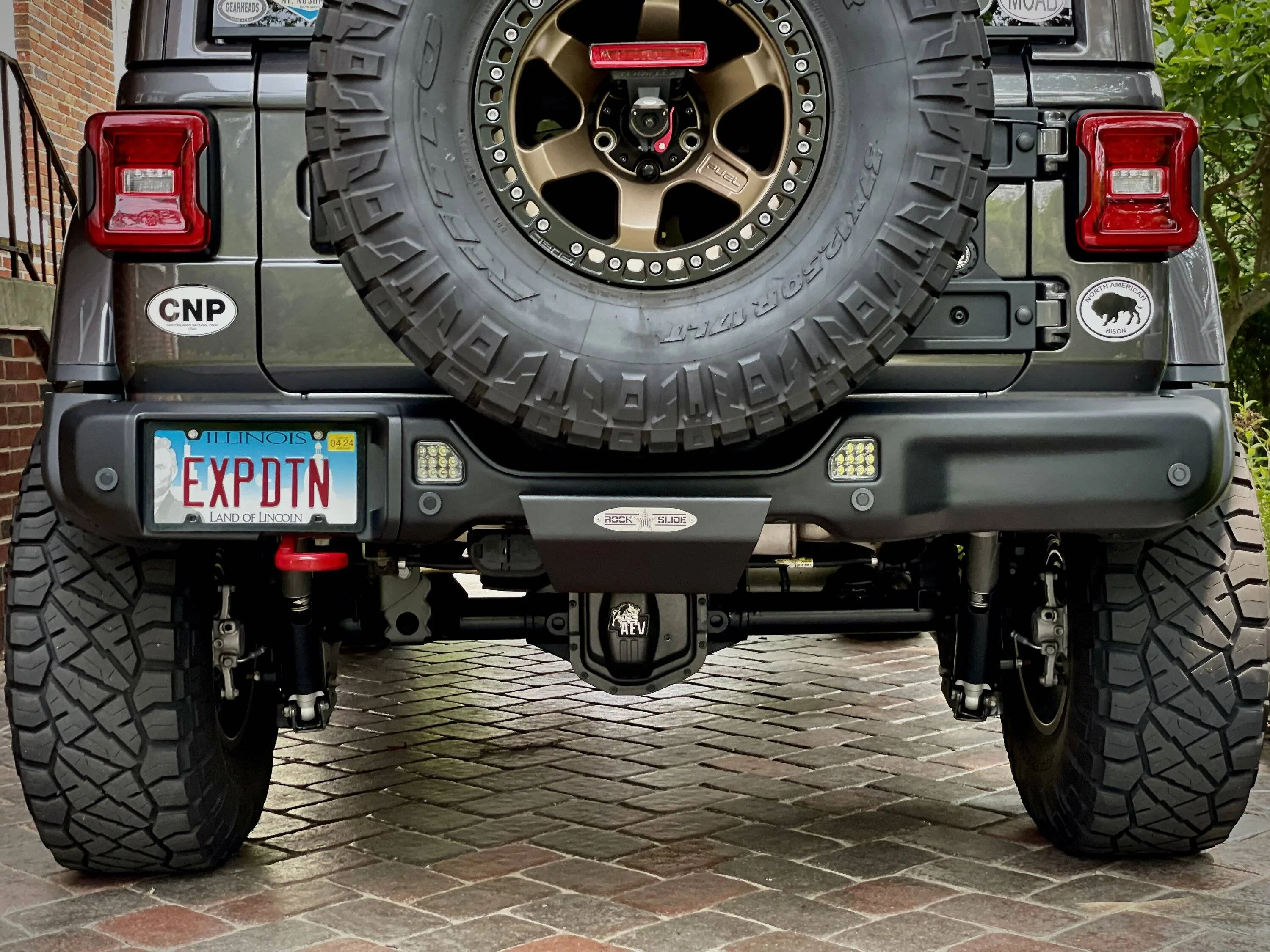

I'm running OEM steel bumpers on my build, love the integrated look and overall I feel Jeep did a pretty good job with the design and execution on them.
Like a lot of aspects with the new JL, keeping things as light as possible for efficiency reasons doesn't always translate nicely to the off road environment. We have seen body damage if you land hard on the rear bumper corner(s). Inside that steel bumper resides a very lightweight corner brace that will allow the corner of the rear bumper to flex up and into the body if you land hard enough on it.
Jeep Wrangler JL Rubi Recon IMG_8215
MetalCloak to the rescue. They designed a new rear bumper corner brace to provide additional strength and rigidity for their ARS Rack System. Turns out, the additional strength/support these brackets provide will be good insurance for running the OEM steel bumper off road, giving those rear bumper corners some much needed strength. Here's a video on the install. Enjoy✌?

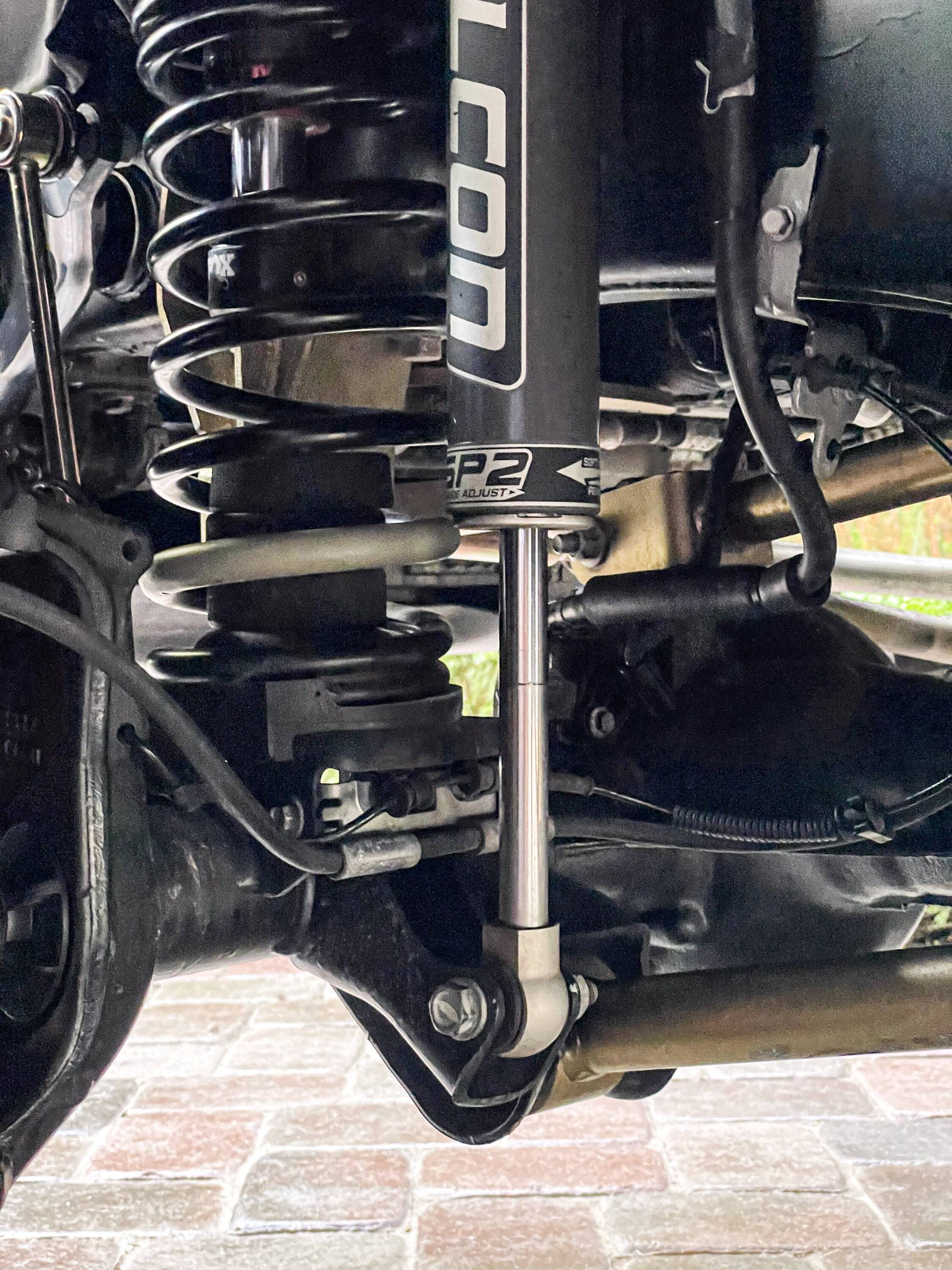

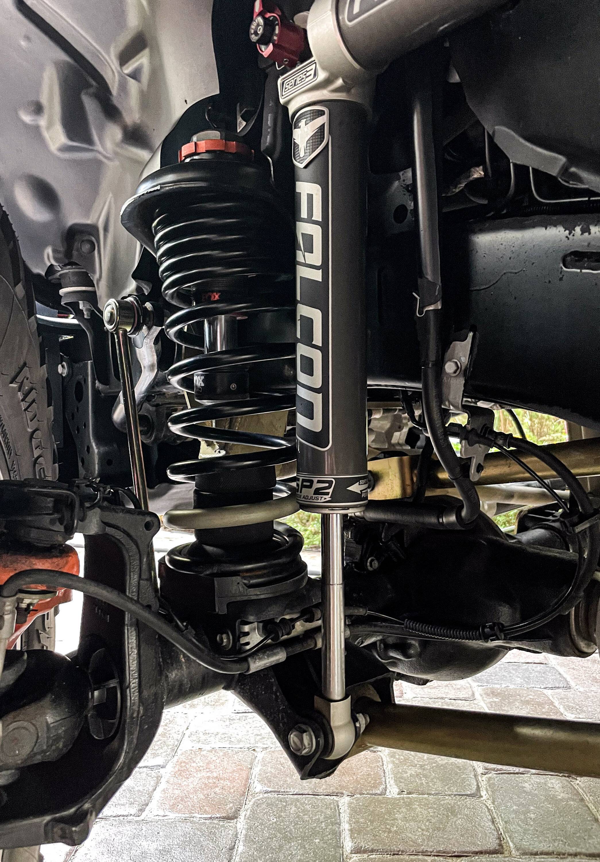

Hi Justin. On my 3.5" MC Game-Changer lift, you run the stock brake lines. On the rear, you bend the brake line bracket upward which gives additional slack to the line. let me know if need pics of anything?
Jeep made the OEM long on the JL...they must have known we would be lifting them.

I think I understand the rear ok. I was more curious on the front. Did you leave the bracket at the bottom of the spring perch and just remove the bracket that was attached to the lower control arm? Or did you do anything else? If you had a pic from behind one of the front tires with the tire turned out that would be great.

Let me finish up what I'm doing and I'll get you a pic. Give me a about an hour or less.
