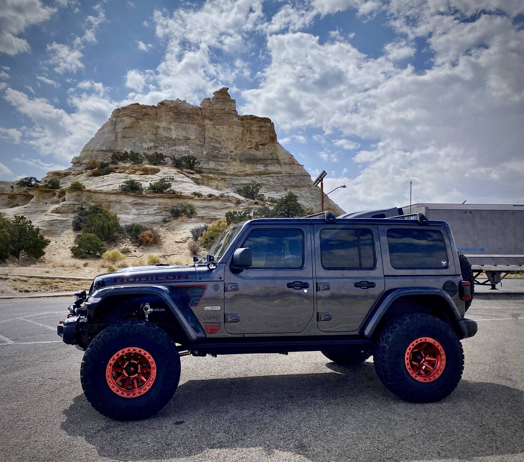

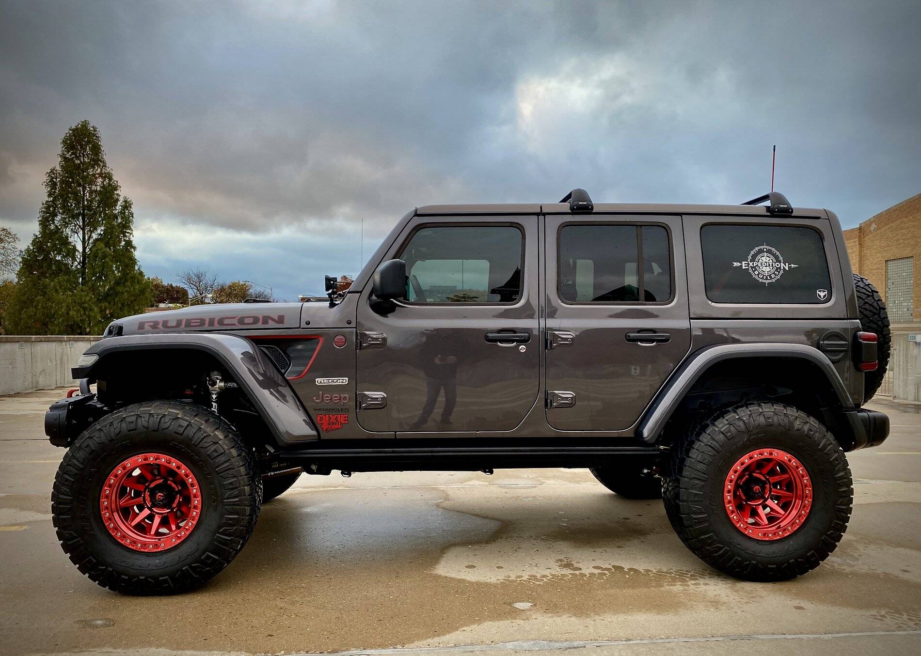

@MSparks909 I was just remembering that I went back and added a 1/2" TeraFlex rear coils spacer to my MetalCloak 3.5" GC. It's not that the lift results in a 'nose high' attitude (the Jeep sits slightly nose down as measured at the rock rails). The new higher clearance/higher up Rubicon fenders give the Jeep a nose high look.
If I was to do it again, I'd use a 1" spacer at the back so when trail loaded, the stance would be perfect(in my opinion). Small thing, but you'll be in there when the springs are off.
https://teraflex.com/shop/suspensions/jl-0-5-coil-spring-spacer-load-level-kit-rear.html
This pic was a couple of days after the lift install...
Jeep Wrangler JL Rubi Recon IMG_0977
This is with the 1/2" spacer install on the rear coil...
Jeep Wrangler JL Rubi Recon IMG_1442
https://www.youtube.com/channel/UC5HJ5REOo6XbFuakJem6TTw
-Steven
Thanks for the reminder! I’ll add those to the list. Ever have any problems with coil bow or any kind of lean with your Jeep? I see Metalcloak sells lower spring perch correction pads for like $30, wonder if I should just add those too and do it all at once.

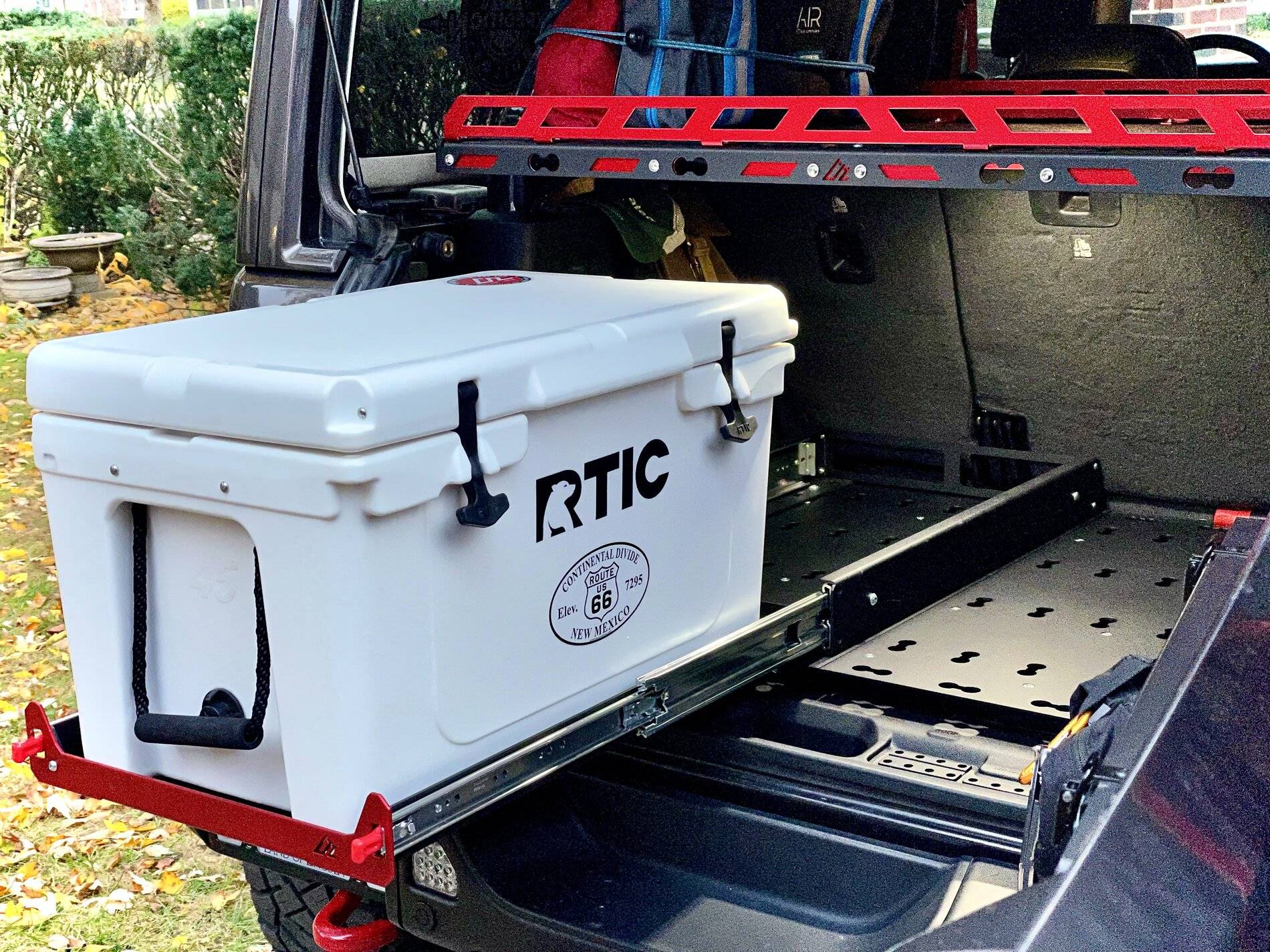

Here's the AAL Fridge Slider installed in Rubi. The 45qt. RTIC cooler fits perfectly on the slider. The slide runs absolutely quietly. I'll be doing a complete walkaround video on my AAL products soon.
Really enjoy having them on the Jeep.

Can I see it slid out ? Would like to see how far it comes out, thanks……
Here you go. It slides out to a 'locked' position', allowing enough room to open the freezer, or in my case the cooler.
I'm not at a point where I can really utilize a dedicated fridge/freezer. I was happy to see that the 45qt. RTIC fit the slide as well as clearing the passenger seat when it's upright. With the slide closed, the cooler just touches the back of the seat.
I have a full walk around video coming on the AAL systems I'm running. Look for that soon.

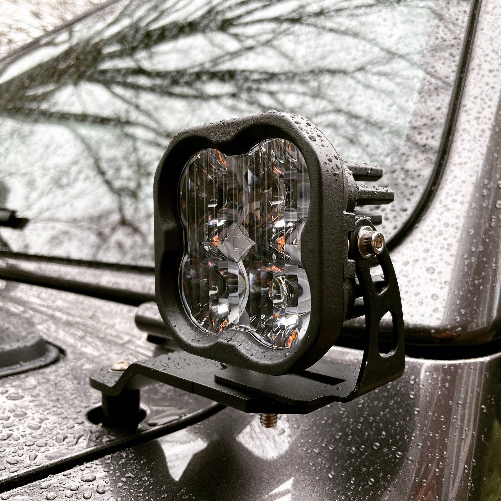

I've been running this A-pillar light set-up for a while now. I started with Diode Dynamics SS3 Pro's mounted on KC Hilites mounts.

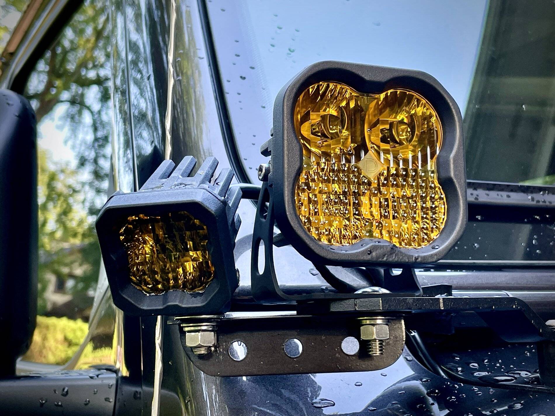

I then added Diode Dynamics SSC1 Pro's-Wide beam as a 'ditch' light. I fabbed some simple custom brackets to allow me to position the C1's right where I wanted them.
