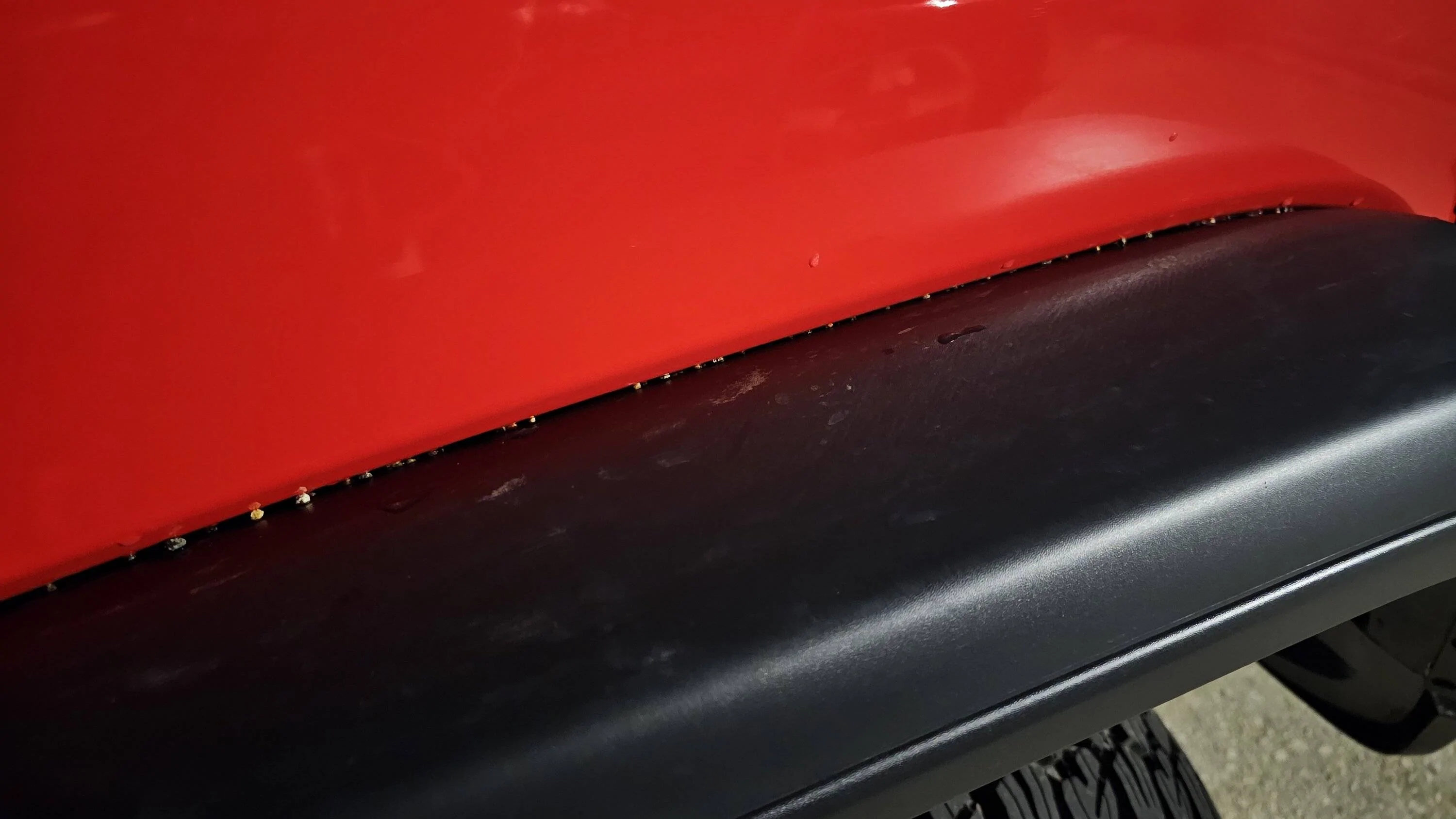

Any tips or tricks for cleaning these out and/or prevention for future trail trips?

I used the tube shown in the video above. Been in place since June 1st and has never come out. Great mod for your Jeep. To remove the small rocks when installed I gently pushed the fender down and a used a point pick to flick the rock out without damaging the paint. Emphasis on gently

I dont get too many stuck in there. I bought the foam strips awhile ago but didn't like how it was going/staying in. I just keep a skinny pair of tiny needle nose pliers and use something skinny like a bamboo skewer to flick out stubborn rocks. Like the prev post said. Just apply a little pressure to the fender and they come out easy. I'm actually surprised none of the little rocks have scratched anything yet.

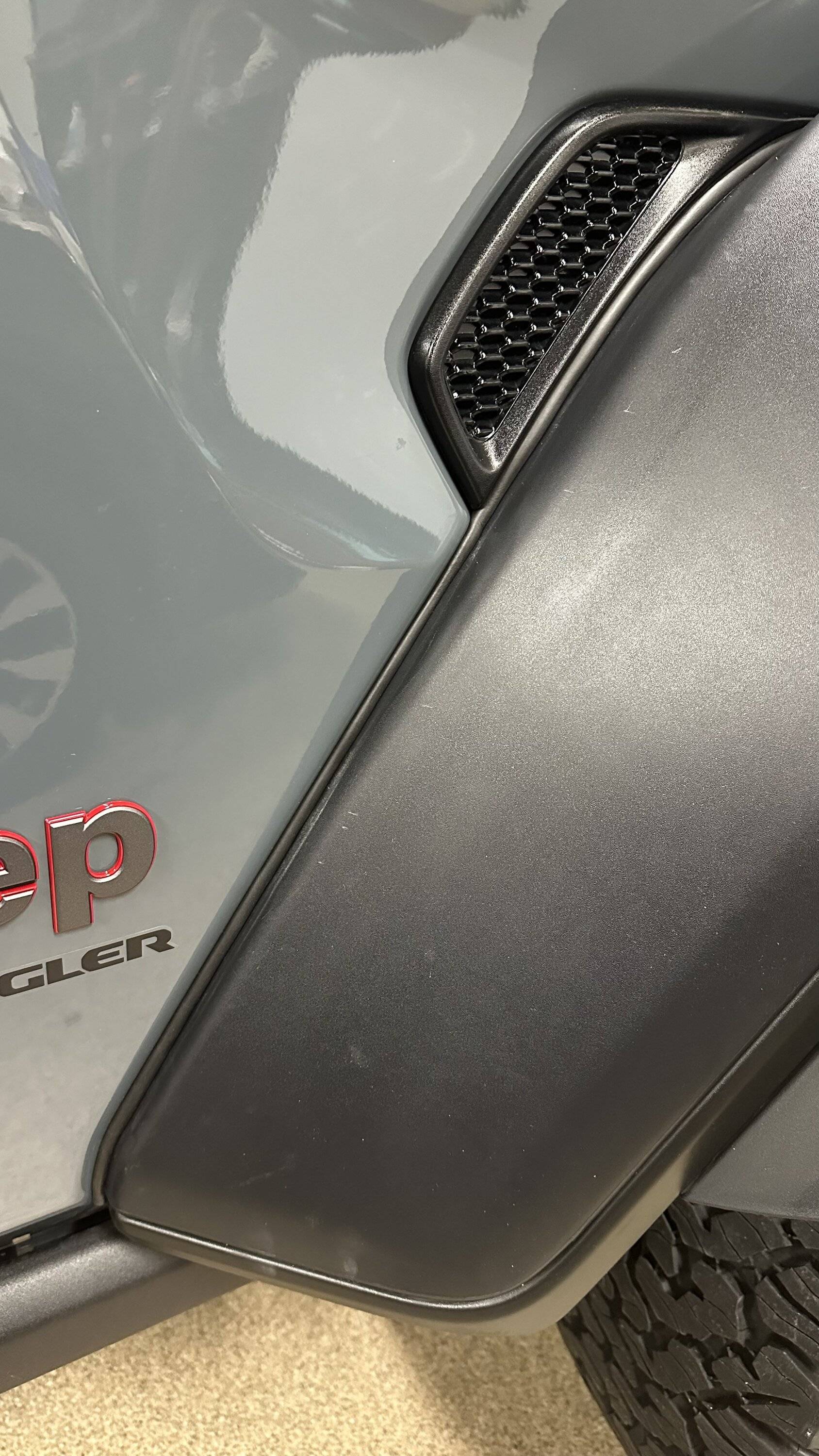

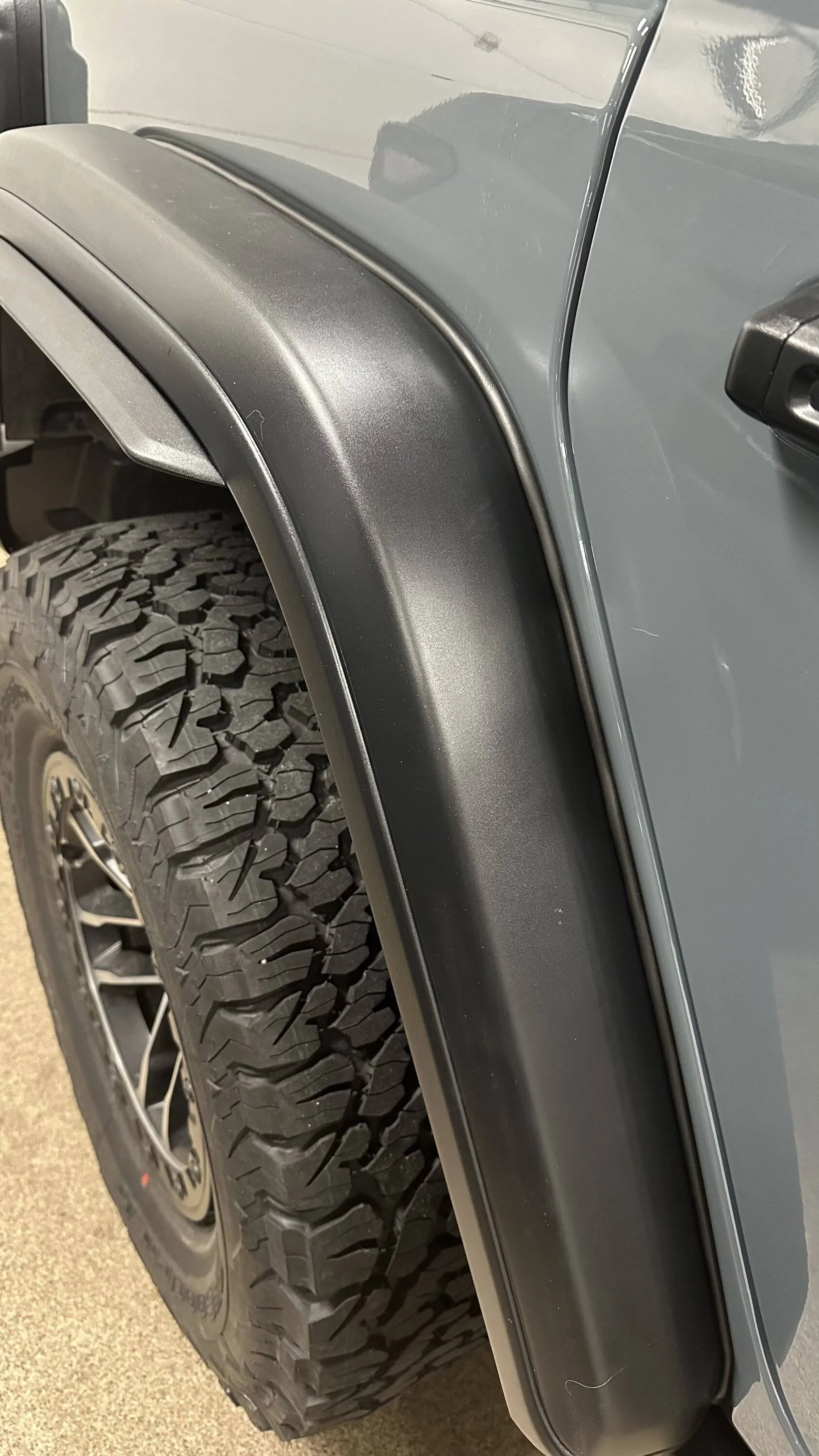

I became frustrated with this terrible design on my first JL, so the 392 now has the rubber beading. I ordered the tubing and it has remained in place through many pressure washings etc.
