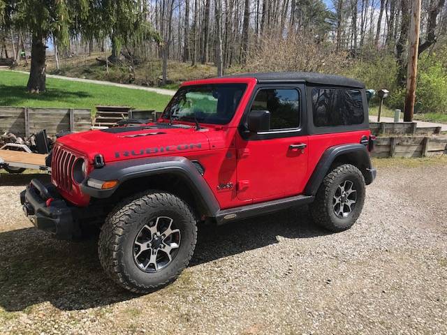

I have Shrockworks installed on mine. They mount to the frame and stick out a bit for a step
This is the direction I have been leaning as well, I just wish they covered the pinch seam better. They look a lot better in your pictures than others I have seen.

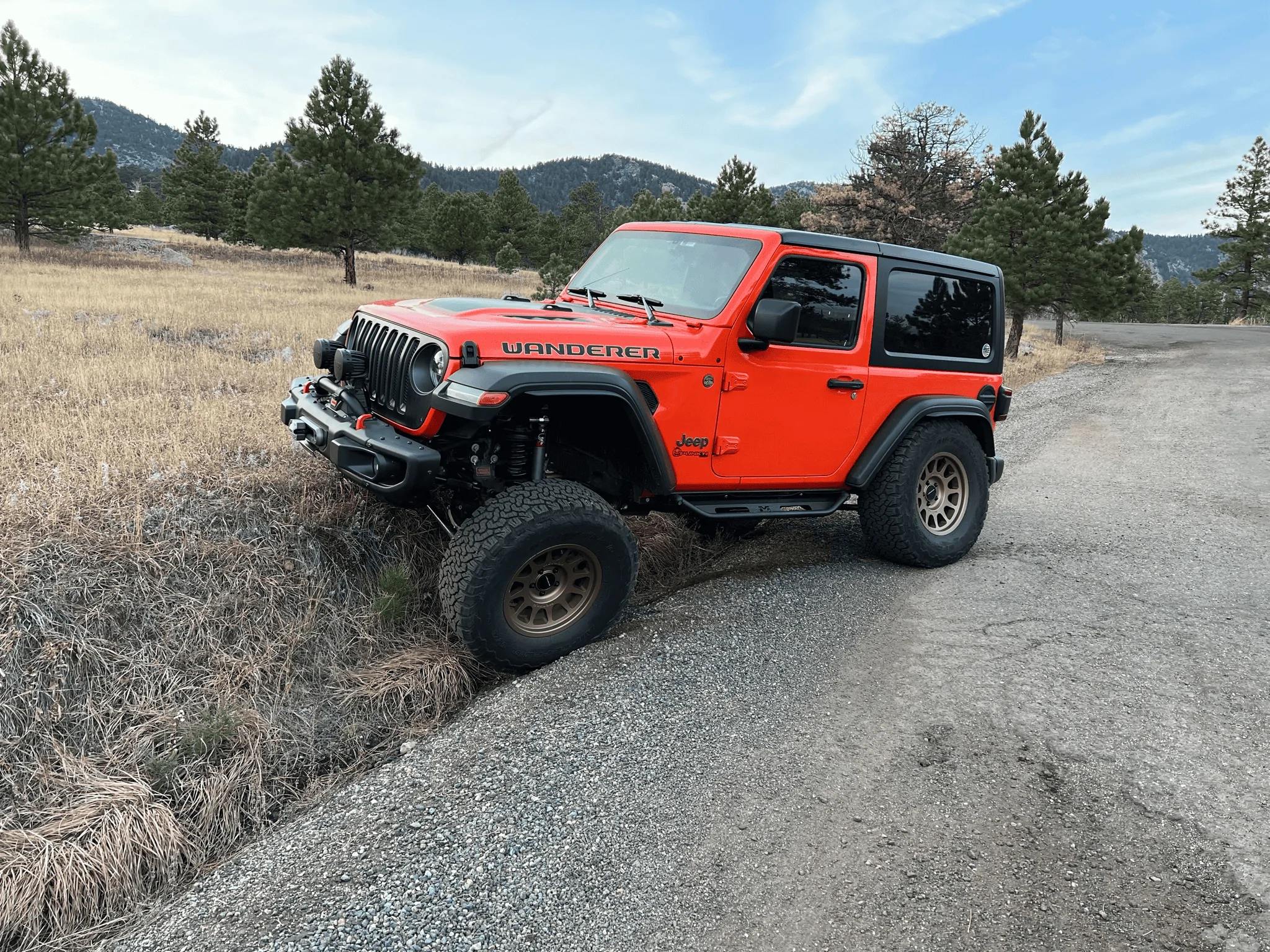

Rockslider Engineering. I got the heavy duty outer armor and have slid and hit rocks with them without harm.
They cover the pinch seam except about 1/2 inch on each end. They said this is to accommodate larger tires, in case trimming is needed. I know pinch seam trimming was needed with the JK, but not so sure about the JL. Anyway, they are stout and are frame mounted, which was important to me.
Some people still trim for larger tires but I think it is more in the rear wheel well than anything. Also, I meant cover the pinch seam vertically up towards the door sill. They sit a bit lower than other options, but that makes sense because they mount to the frame.
