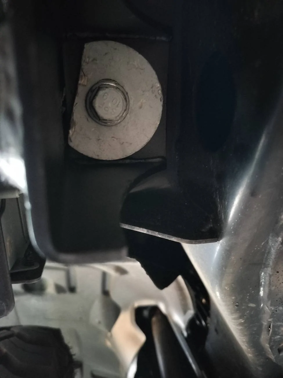

I have the ace sliders on a MY18 4 door and they are solid. I bought the same sliders for MY24 and the sliders themselves are solid, but they do flex a little. I also had to cut one of the washers for them to fit. I think the mounts on the MY24 and up are different which is why they say they only work up to MY24 and up. They work and have supported the weight of the vehicle but I am slightly concerned about the movement. Time will tell, I guess.
Well, I was going to post pictures but my phone is being weird.

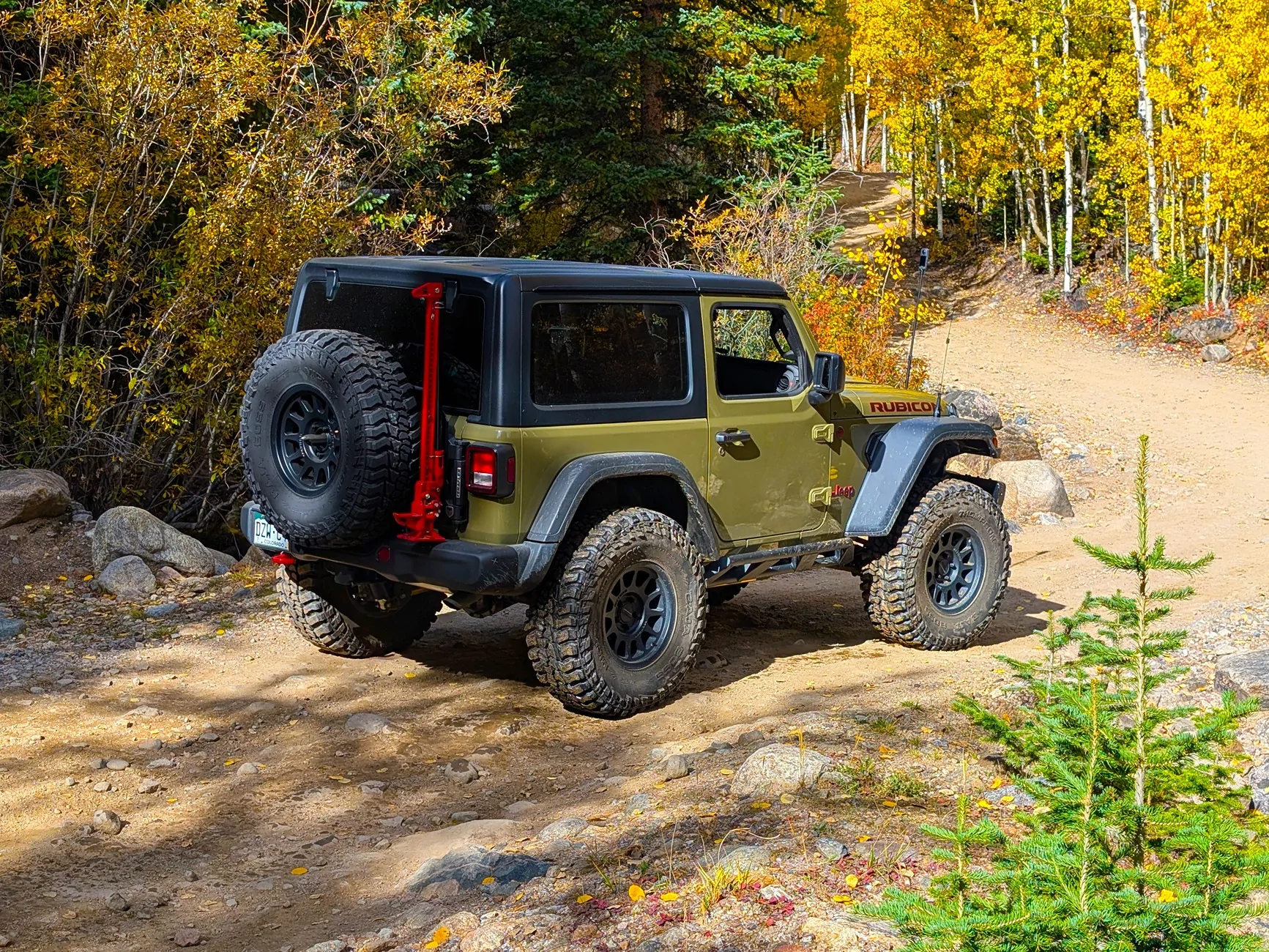

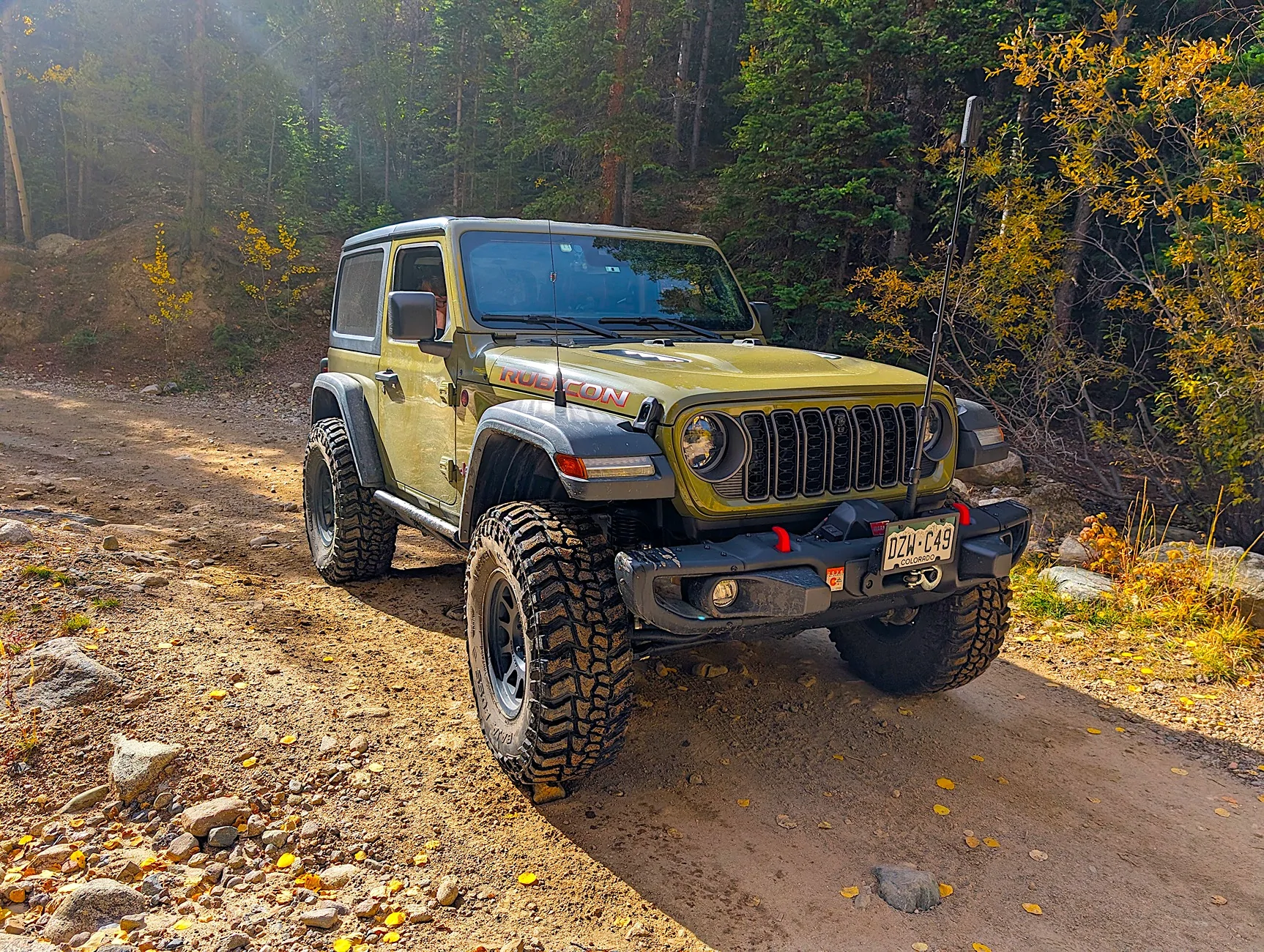

I realized I never posted a pic of these (Motobilt sliders) installed, so here's a couple recent ones...
Jeep Wrangler JL Comparing rock sliders for 2 door 2025 models PXL_20250928_155541527
Jeep Wrangler JL Comparing rock sliders for 2 door 2025 models PXL_20250928_155650023
They've only made contact with rocks (and dirt in washouts) a few times, but no issues and I've been happy with them. As an added benefit I can stand on them like a step which is handy in some situations. Occasionally, I'll here a rock coming off my tires hitting the sliders.
