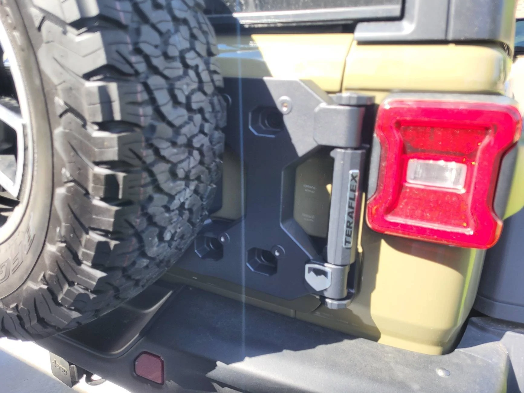

Add a Teraflex hinge gate reinforcement (in preparation for upgrading to 37s later)...
Jeep Wrangler JL DirtWheeler '25 JLR Build plan/status 20250521_154323
Jeep Wrangler JL DirtWheeler '25 JLR Build plan/status 20250521_154313
This was a DIY install and it went pretty smooth. There were some minor differences between the instructions (included in the box and YouTube) for "my" Jeep, that I assume was mostly attributed to minor differences in 2025, but I'm not sure (it's the only JL I've ever worked on). I'm wondering how necessary the "third brake light" is and considering just removing it completely. It looks cheesy and I can't imagine it adds that much safety versus the two standard brake lights. I also don't like how the wires are exposed and that you have to take it off to change the spare. Not a big deal, but it also doesn't seem like a big deal to just get rid of it.
I would have just had this installed by a local shop while they're doing a bunch of other work, but they quoted me $600 for the install and it looked pretty easy to do. It was a little more difficult than anticipated, but not worth paying $600 to have a shop do it (IMO).
It's a teraflex reinforcement for the gate (new hinges integrated with a frame that extends to a new tire mount). Overall, I'm impressed with the quality of this hinge gate reinforcement. I paid $1200 even for it. I have no idea if that's a good or bad deal or how it compares with the $675 (IIRC) Jeep reinforced hinge gate option, but I'm happy with it so far. It still has the stock 33" tires, but I set the stud position on the tire carrier for 37s. The stock spare barely fits. With the tire mount hardware fully extended the tire touches the tailgate frame reinforcement. My guess is that this will not be an issue when I get the 37" spare on my new wheels with a more aggressive offset. But I will not know for sure until I get them. I might have to readjust the tire mount position for the wheel/tire size and readjust the tailgate hinge angle for the weight when I get the new tires. But hopefully it "just fits right" (not counting on it).

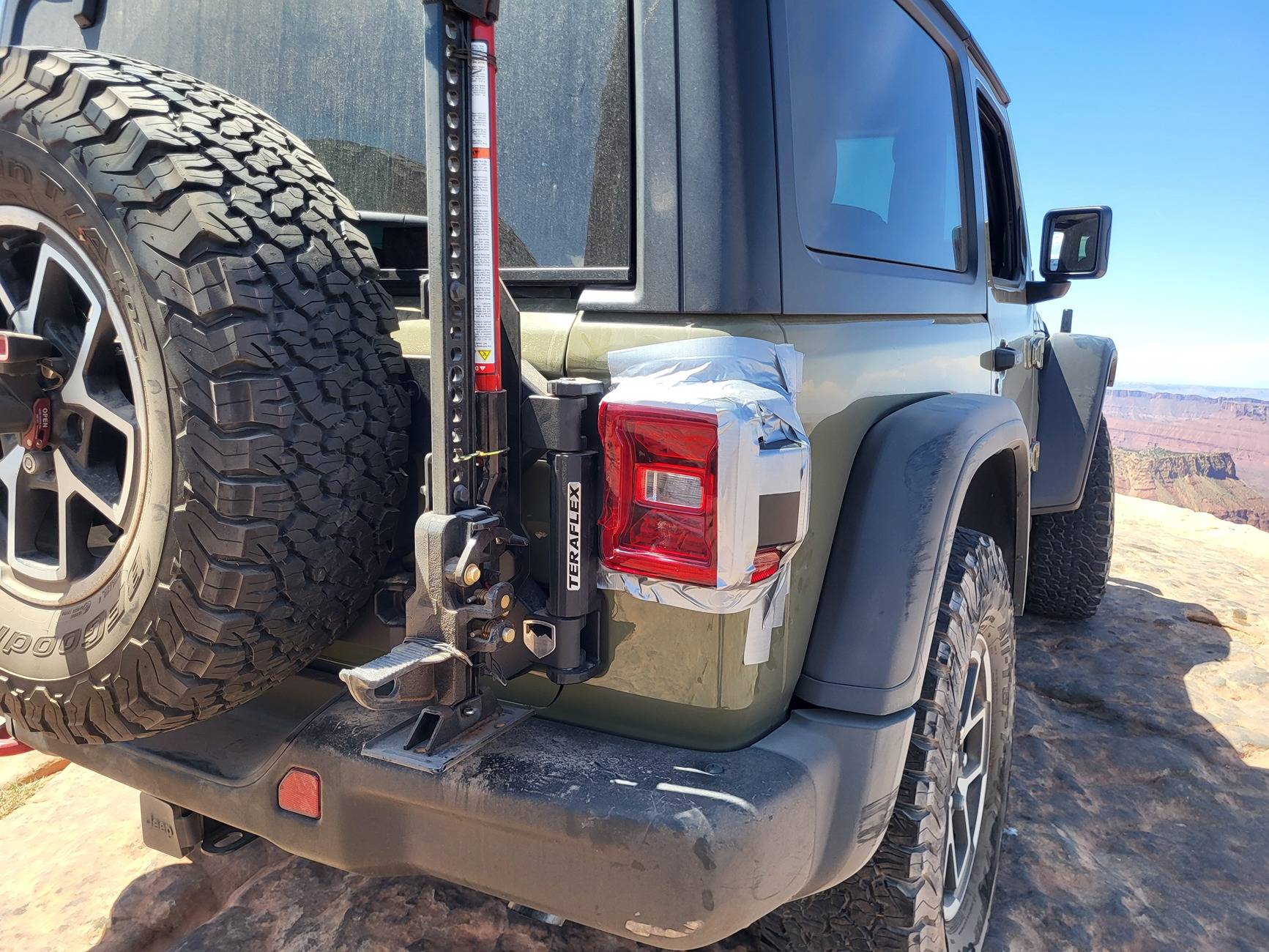

My tail light and mounting bracket got destroyed off-roading today. Had to duct tape it on to reattach temporarily. Mopar mounting bracket and nilight replacement tail lights on order.
Jeep Wrangler JL DirtWheeler '25 JLR Build plan/status 20250528_115147

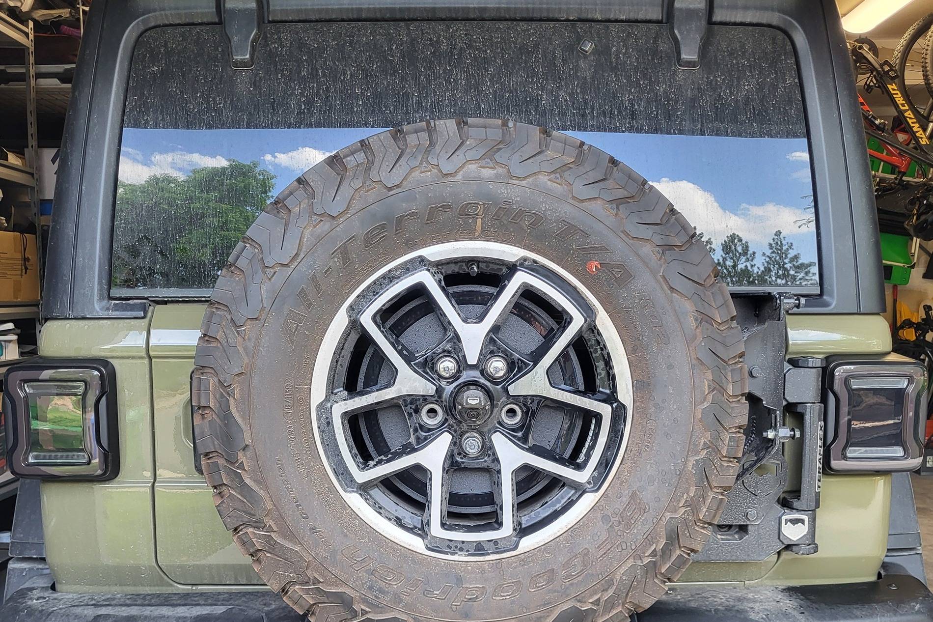

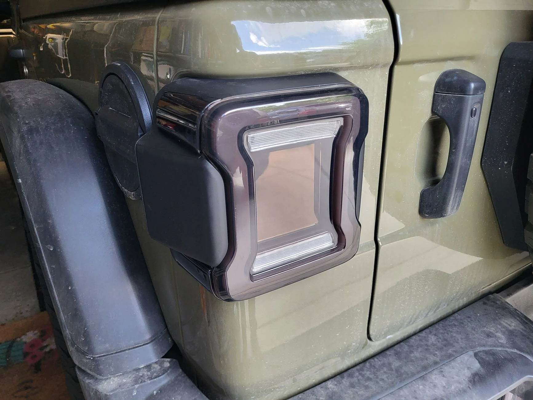

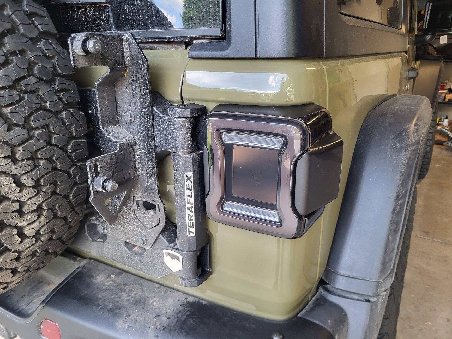

Replaced the tail lights (and the tail light bracket on the passenger side)...
Jeep Wrangler JL DirtWheeler '25 JLR Build plan/status 20250604_163809
Jeep Wrangler JL DirtWheeler '25 JLR Build plan/status 20250604_163803
I also replaced the center brake light with one that's a "behind-the-spare" style...
Jeep Wrangler JL DirtWheeler '25 JLR Build plan/status 20250604_163757_2
I also installed a tail-gate limited to prevent the tailgate from swinging the hi-lift jack into the tail lights.
I thought about getting some flush mount lights, but these were cheap and quick. If I break them again I'll probably get flush mount lights the next go round. I've also got a 42" hi-lift on order since my 48" hi-lift sticks about 6" over the top of the vehicle (enough to hit my garage door after planned lift/tire upgrades).
