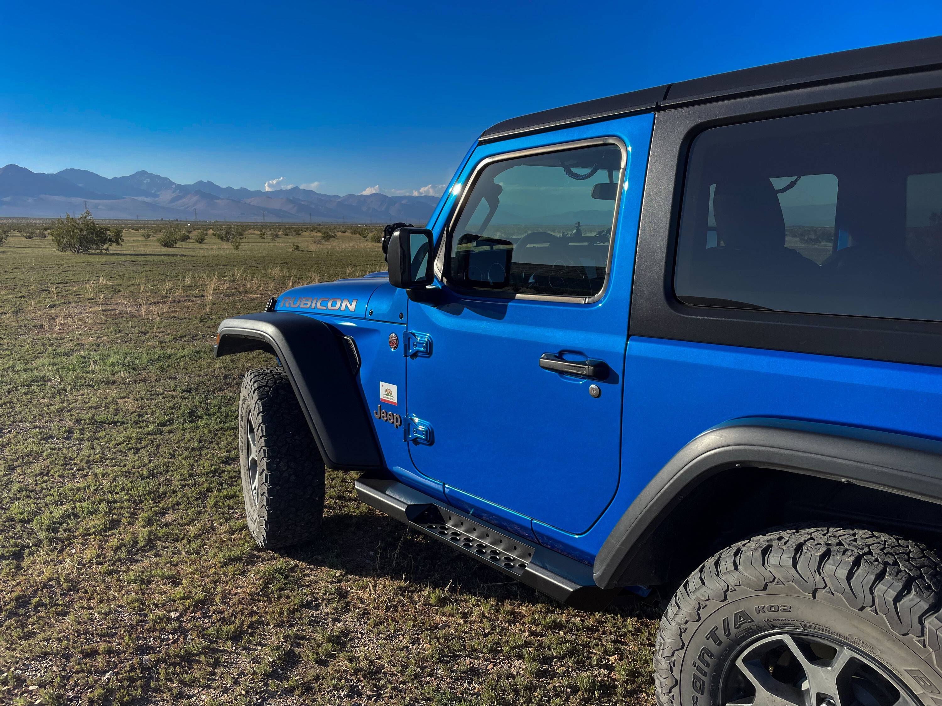

There's not a lot out there as far as writeups for the 2 door LOD destroyer install. And the lack of which made me hesitate for a while before buying. So, now that I've done the install, I figured I'd put a writeup out there to help others--especially since it differs fairly significantly from the 4 door install.
Background
I did this install in about two hours by myself. For context, I am a rather petite woman with rheumatoid arthritis. If I can do this, anybody can. I did make use of an impact wrench, which makes life so much easier, and only used a socket wrench to hand finish them off when bolting back on. You'll also need something to cut the skid plate, an angle grinder or a particularly powerful dremel with a cut off wheel should do the job.

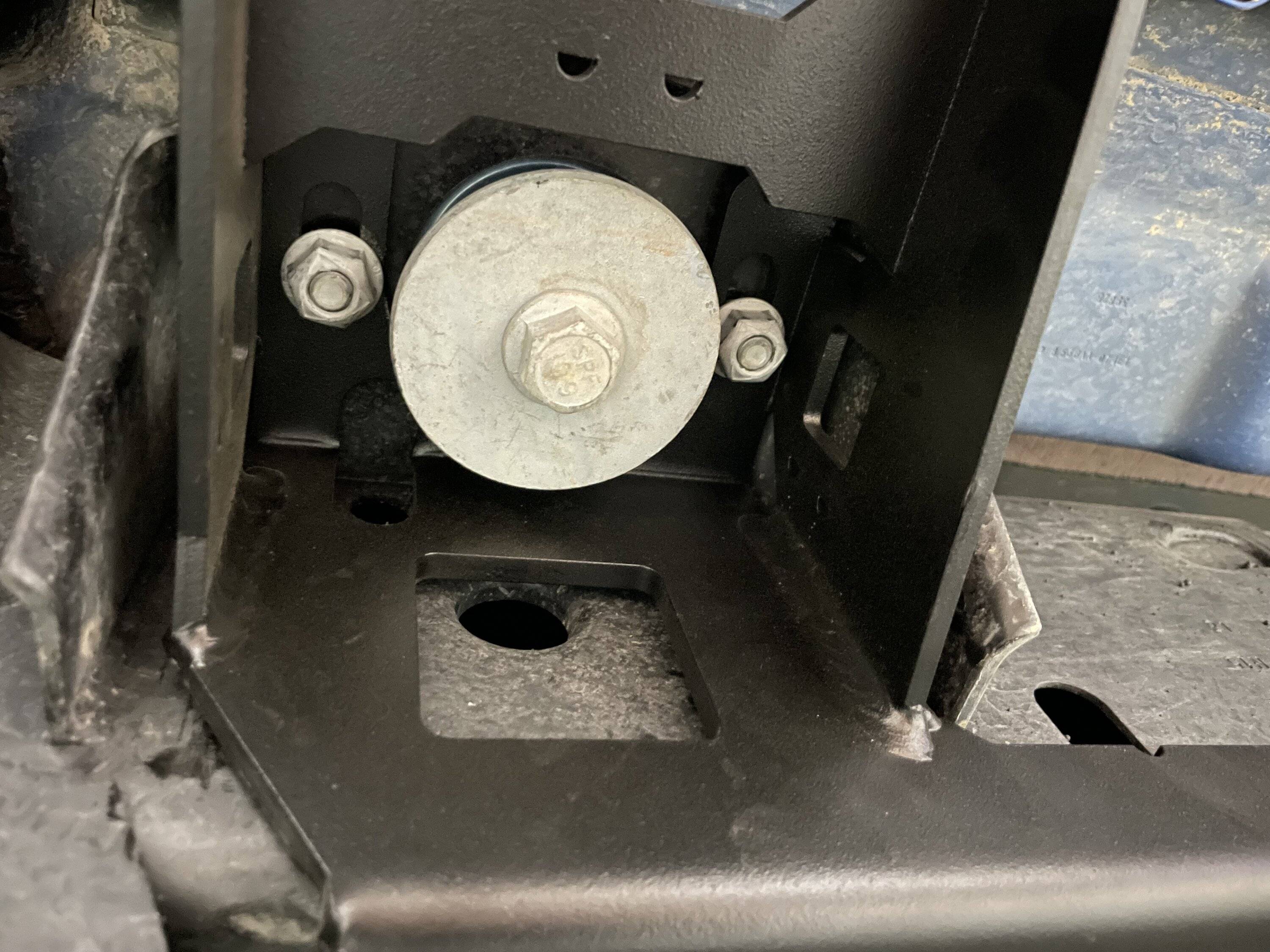

For the rear mount, you'll be using the existing skid plate hardware and the two bolts next to the body bolt. Remove the skid plate bolt and the two nuts on either side of the body bolt. Do not touch the large body bolt itself.
Now you're ready to install.
Place the slider on a support. I used a cooler and a piece of spare wood as a shim to get them at the perfect height.
Slide them up to the Jeep. Get the rear mount lined up first, as you will need to angle the mount a bit to get it around the body bolt washer.
Worth noting: The instructions show the mount has a closed circle around the body washer, but that must have been an old design, because mine was open ended and thus MUCH easier to slide around the washer. This completely removed any need to loosen the notorious body bolts.
It took a little wiggling to get the angle right, but the mount slid over the body bolt washer fairly easily. Note that the rear mount should be on TOP of the skid plate (unlike the front, which goes between frame and skid). Line up the two small bolts on either side and loosely thread the stock nuts back onto them to hold the rear mount in place, but still allow enough movement to line up the front. You can loosely reinsert the stock skid plate bolt and washer and the optional self-tapping bolt as well. Just make sure you have enough maneuverability to get the front lined up.

And now you're done! Enjoy your new sliders! Go forth and get it dirty!
