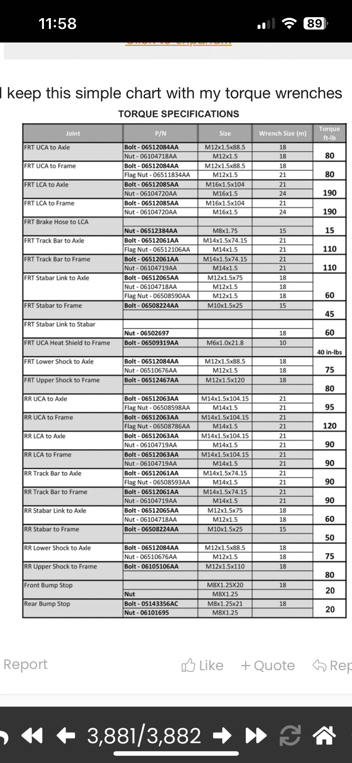

The torque specs are easier to understand using the Mopar suspension install sheet.
I am literally now starting to re-torque everything, so this Information is most welcome! Thank you Victor! ??
