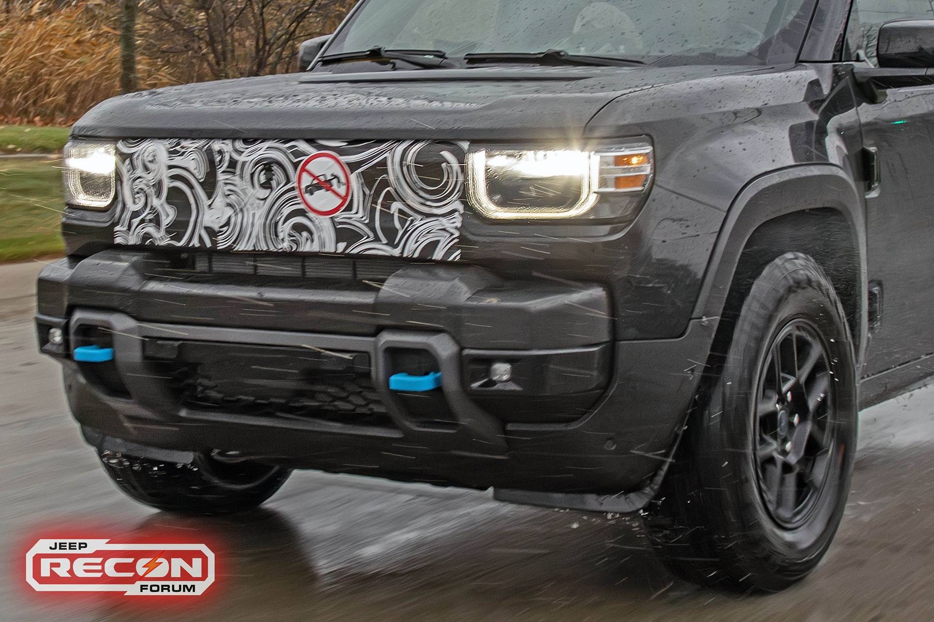

Lots of vehicles nowadays have mismatched wipers. Here's a pic of my wife's 2017 Subaru Crosstrek.
In fact, here’s a newfangled Recon:
Jeep Wrangler JL Riddle: Why are 99% front/rear diff covers a nice, matched pair? IMG_1488
(attribution in the linked-peer forum; it’s not my image)
Engineered asymmetry clears a bit more of the windshield. Honda’s been doing it for decades.
