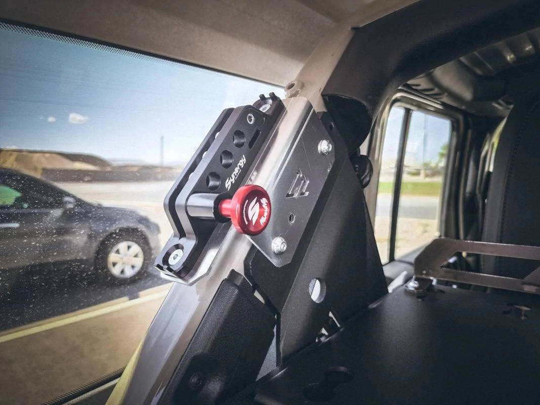

I suggest a larger fire extinguisher. I know 2.5 pounder seem to be pretty popular but personally have a 5 pound one mounted in the same spot with a synergy hard mount from American Adventure Labs.. When bought from AAL it includes a small adapter that uses factory bungs on the rear roll bar that normally support the soft top mechanism.
The picture shows the trim panel completely removed because they are also highlighting their shelf in this picture. If not running a shelf, the trim piece can be marked with a piece of tape and carefully cut with a utility knife or dremel with a cut off wheel to give a very factory appearance.
While the hard mount is quite on road, I do get rattle when off road.
