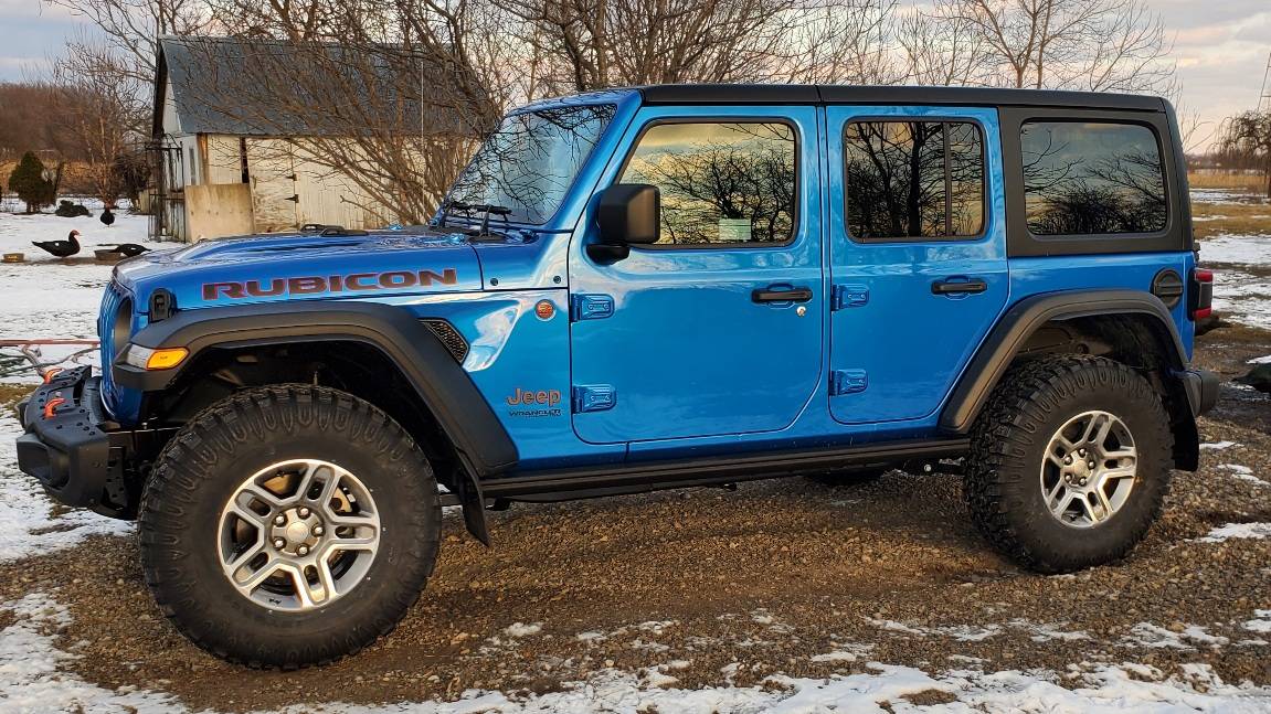

Hi,
I also have a JLUR 6mt ordered with 4.88's added 35's (Trxus MT) and xr flares, +12mm Mopar Performance rims, haven't done any offroad, but fit fine and no issues, I did add the longer LCA'S and that helped with tracking.
Jeep Wrangler JL Xtreme Recon - Build Out 20220313_190849
Regards,
Jim
