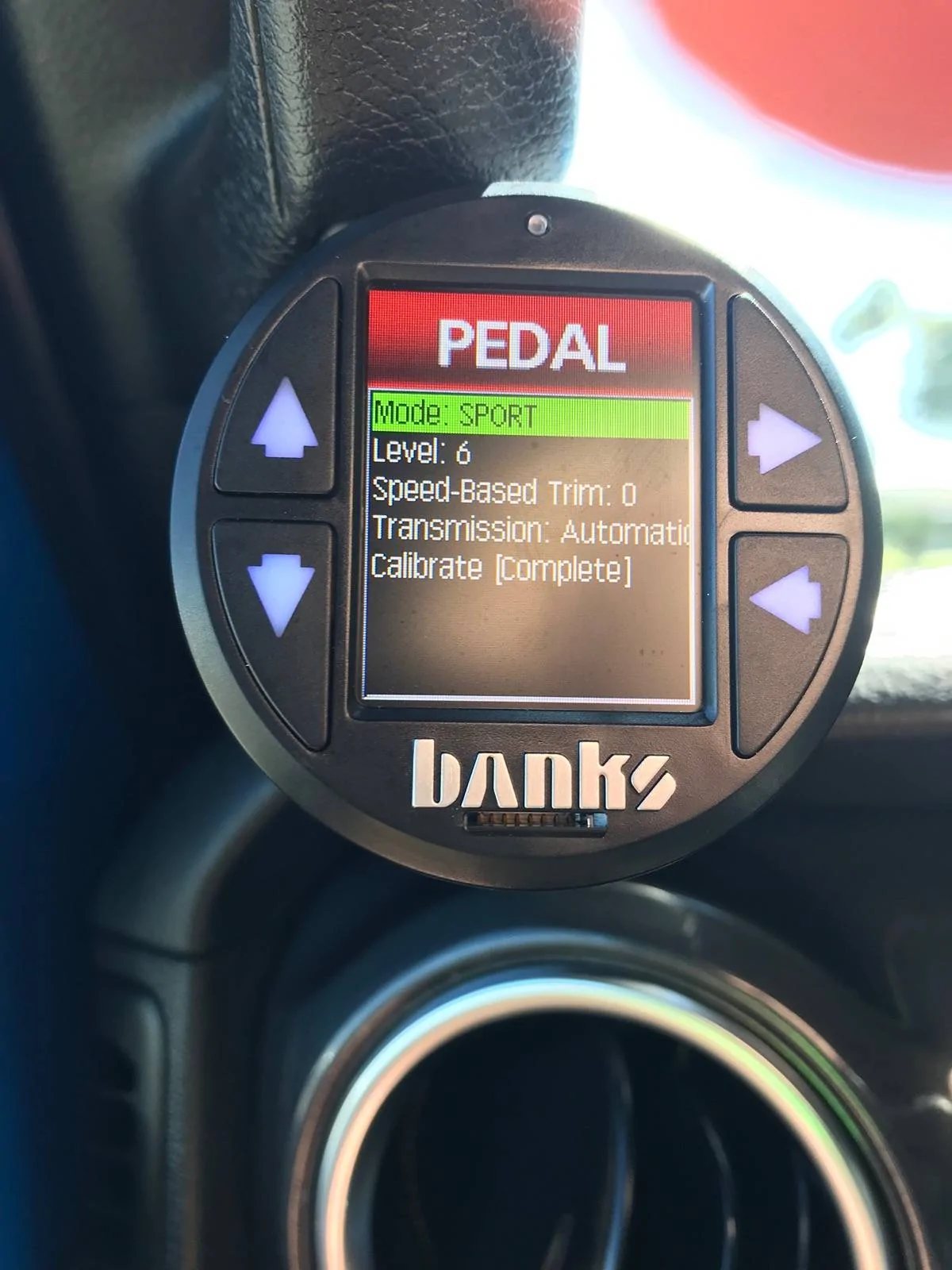

You will initially be like WTF and will need to probably be in "City" mode to start, but you will find your setting (I have mine set at Sport 3, these all make sense when you look at the device).

My Goldilocks setting- Race mode and also Sport mode above level 6 to hot, stock, and city modes too cold. Just right ??? ?
