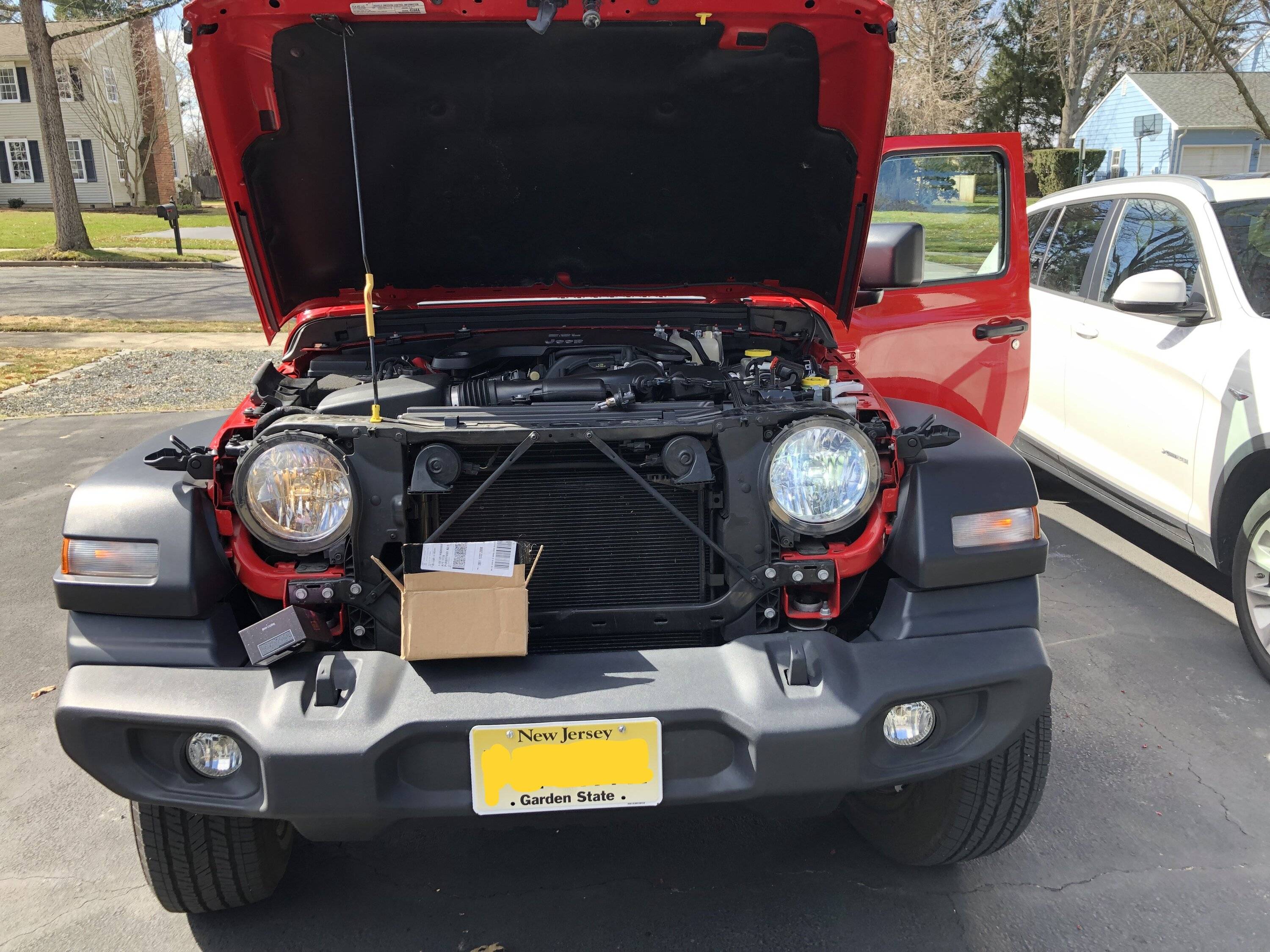

I just helped another forum member swap bulbs. It took all of 30 minutes for the headlights. The hardest part was tucking the heat sink and extra wiring in the housing. LOL
So any H13 bulb is compatible?
Yes. But remember. You get what you pay for. Go with the Beamtechs, if you just want a bulb replacement.
