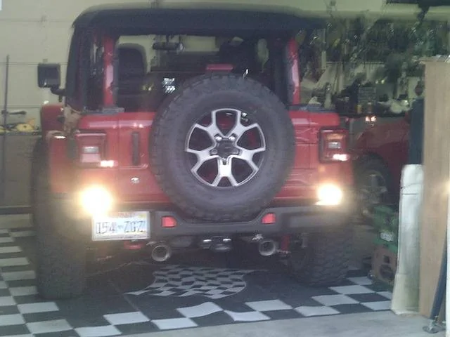

Well, from what I've read, the ECU/CANBUS system in the JL is very sensitive to circuit RESISTANCE CHANGES and won't allow lighting changes without various changes and I'm not familiar with those--
Since my RUBY has the AUX SWITH SYSTEM I added HALOGEN REAR LIGHTS using that--

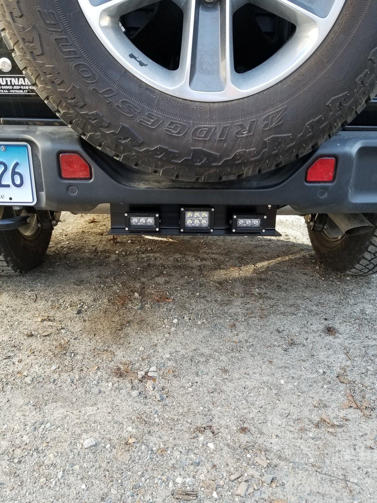

Whelen Nano's wired into aux4. Plenty of light.

I did the exact same thing. Gives the option of not blinding people behind you under normal conditions but lighting up the world when you need to.
