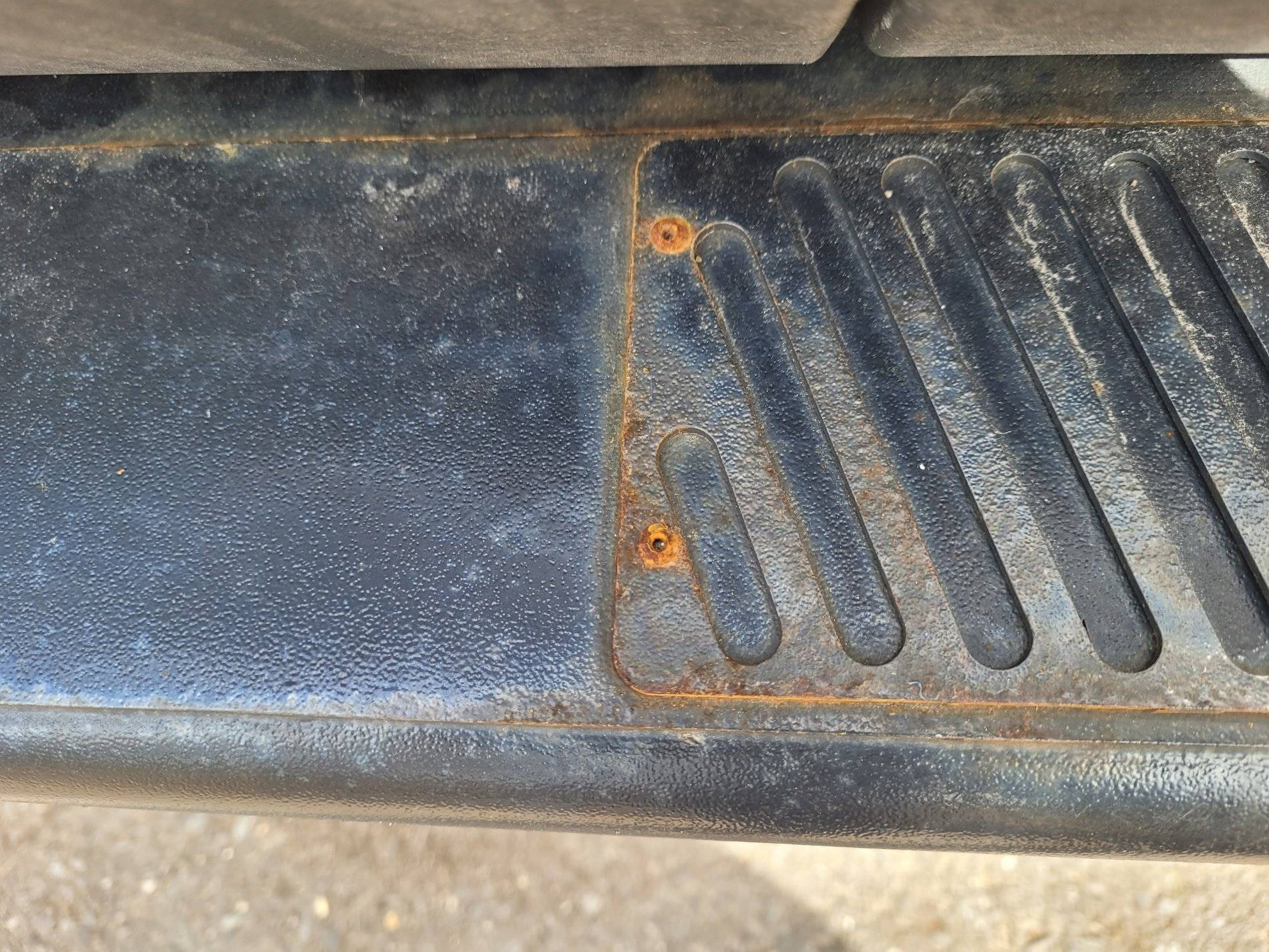

I'm not going to mention the company but this is the response I received via email when I mention that I had their rocker slider/steps on the jeep since last fall. I asked them about all the rust and this is what they said. "Best to replace the rivets of course then sand and respray the sliders."
Replace the rivers? I guess I need to drill out the rivets and go buy a rivet gun? I try to keep my 2020 Rubicon looking halfway nice but theses sliders are now an eye sore. I didn't think I'd be replacing rivets and painting something that is six months old. I guess to do it right I need to take both sliders off the jeep and paint them. Any suggestions on the type of paint? Thanks for letting me rant.

Ok, good point, you are correct... Rockhard 4x4. They had what I was looking for, sliders that attached to the frame and acted as a step as well. I ordered the black plate that has their name cut out of it, I'm not a fan of the silver/chrome look option. When I got them the first thing I noticed is that the rivets that holds the name plate were plain metal (silver) while everything else was black. It didn't look right. I was going to spot paint the rivets in the spring so they didn't stand out so much but now they are all rusted along with other parts of the steps.
Yeah, their Customer service basically said ...deal with it. I wish I would have ordered the ones that came with the rivet gun.
I like the idea of the bed liner material. Thank you. Once I remove the name plate it won't be going back on. What a pain.

It's not all that unusual though. Rock sliders are made of steel to take the use and abuse. They're also directly in the line of fire of water/salt spray from the front tires. Rock sliders simply are very prone to paint scratching and rust. That said, the bare rivets were definitely an oversight. Bedliner paint is likely your best bet and thorough surface prep goes a long way.

Don't replace the rivets. Wire brush, 3M pad then coat with POR15. After you apply the POR15 use the Raptor coating mentioned above. Or you could pant them with brushed on Rustoleum. Cut the can with 10% mineral oil first and the paint will level out smooth as it dries, if you use a halfway decent brush. It will take 3-4 days to fully dry since it is oil based. I use it on my utility trailers. If it was mine though, I'd use the Raptor coating. Or stop by a LineX place and get a quote. You'll get a better deal if you leave them there and ask them to spray when they still have some product left in their guns after doing a job.
Edit: On second though, I would drill out the rivets and pull tose steps. Looks like there is corrosion under the step plates. Wire brush, 3M and POR15, the put a coat of ratttle can black down before you re-rivet the steps on. The finish as described above. I used to work for Ranch Hand, dealing with finish issues was one of the things I did there.

i use rustoleum bed liner in a rattle can for all my skid plates and sliders.

First, you have to stop the rust. The cost of those might dictate you get them sandblasted, after removing the rivets. Then prep the bare metal, and use whatever bed liner you want. If you just spray over the rusted stuff, the rust will just keep growing, under the liner.
