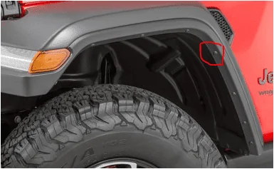

Has anyone ever popped these out? I need like 6 of them and dont want to destroy the ones that are in there due to how expensive ALL rivets are :(
Jeep Wrangler JL Where can I find these rivets? upload_2019-1-7_11-23-48
The cheapest rivet to replace is the one you bypass breaking:

I don’t think these are in some type of case....
Thanks. I am planning to add Aux switches which to get the wire through, I can either remove the passenger side fender fare or drill out these rivets to peel back the inner piece. It seems it might be easier to remove the fender.

You don’t need to drill them out. Use a hammer and paint scraper. Put the scraper between the flair and liner. Hit the scraper with hammer will cut it in half. I work at a body shop found for me that’s the easiest way for these. TheWelcome are on alo of Mopar/Jeep stuff.
