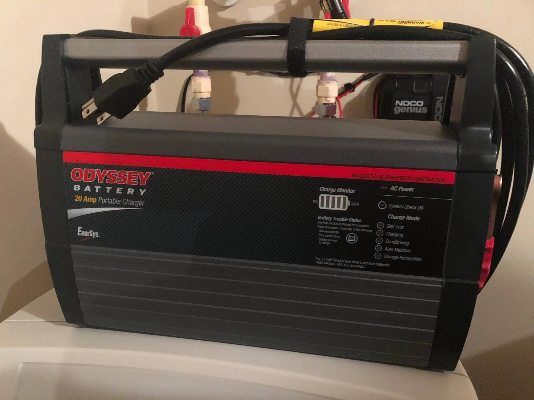

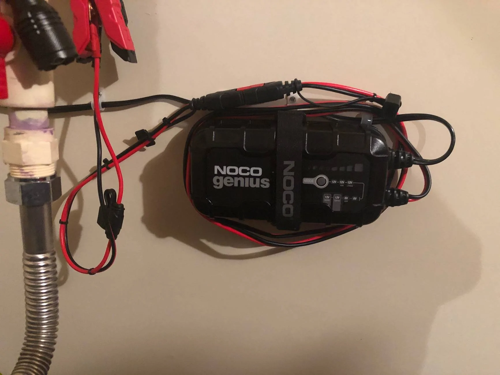

Well I have since retired and left Houston and am back in the midwest.
Here are the two chargers I have used, the NOCO 10 has a AGM setting but the Odyssey 20 does not.
So your advice is not to charge them weekly even if it sits for several days undriven ?
