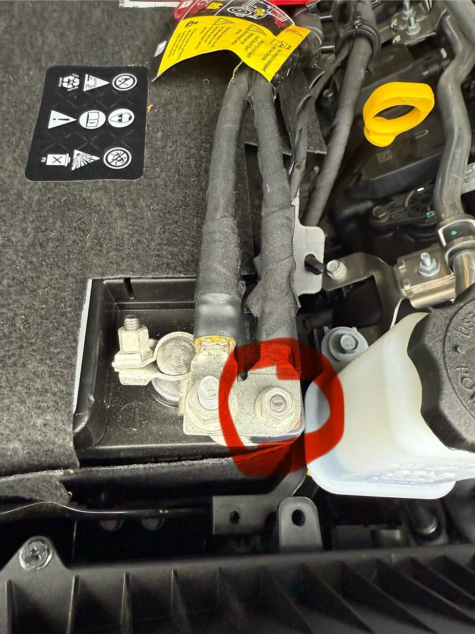

the 2025 models, at least mine, swapped the negative wire connections. Meaning if you follow the directions posted here to isolate the aux you can end up unplugging the main negative.
What does the suggested swap physically look like?
E.g., on my '21, the Negative cables for both batteries shared a single connection on the main battery's Negative post. The ESS battery cable was a bit thinner than the same for the Main battery, just enough to notice. Is the opposite now true?
Here is a photo of my 2025 negative battery connection. I believe the negative aux cable is the thinner one circled. Can anyone confirm?
Yeah the thinner cable is the aux but it is connected to the black smart controller thing now. It has the plate for both connections. So now you have to remove both negative wires and reconnect the main negative to the smart controller. And if you have a winch theres very little room yo plig your negative winch wire now, and the nut is alao undersized.

Yeah the thinner cable is the aux but it is connected to the black smart controller thing now. So now you have to remove both negative wires and reconnect the main negative to the smart controller.
Yes, that's identical to how my '21 was built. When I disconnected the ESS Neg cable to isolate the related battery, the Neg cable for the main battery was reconnected to the related battery post via the Intelligent Battery Sensor.
As described, I'm not perceiving any wiring swap between model years here. That's probably a good thing. 👍
Maybe I was stuck on pre 2021 models then

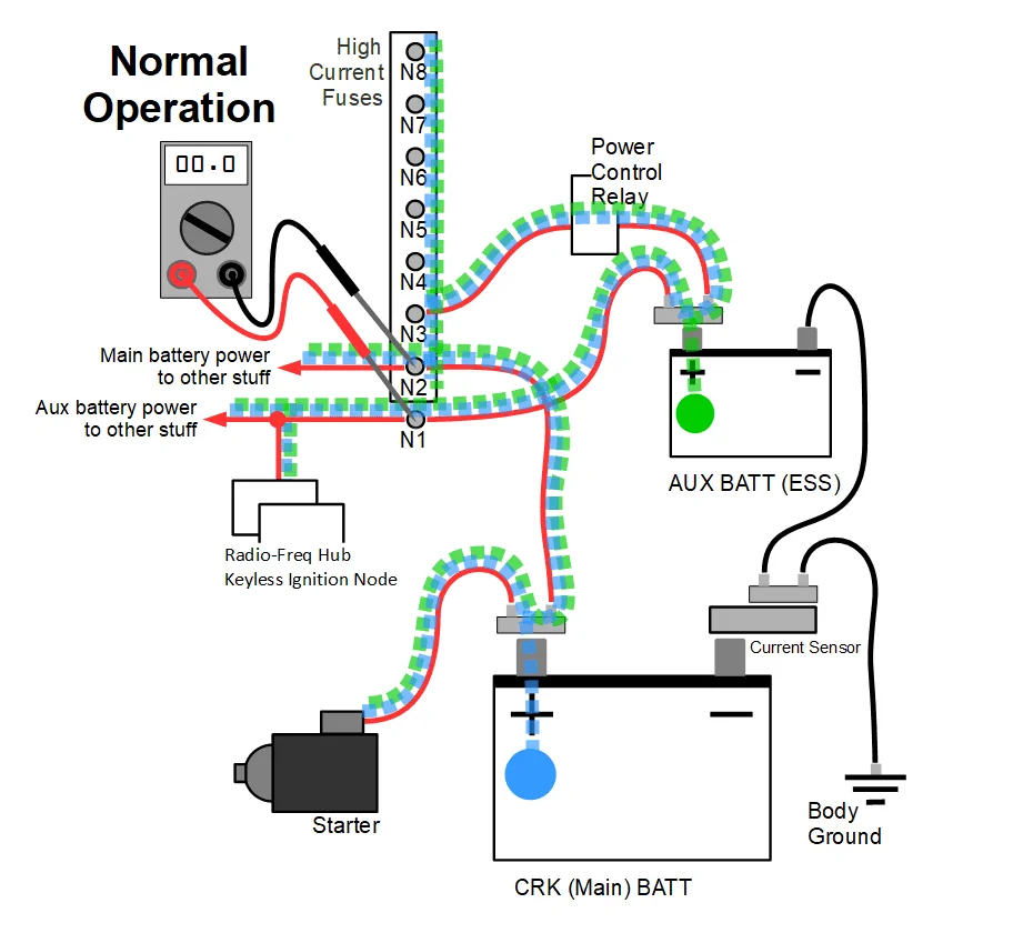

If you hook positive to the main battery and negative to the negative cable it will send bursts of high voltage current to the jeep and it can damage voltage sensitive electricsl components.
AndySpill
Andy
Oct 24, 2023
73
1,667
1,275
Pittsburgh
2018 JL Sahara
Ok. News to me.
My inclination would be that, based on Jerry's @Jebiruph's diagram below, that if you hook a device like a load tester to the main battery's positive terminal, and the exposed end of the disconnected cable between the Aux battery's negative post and the main battery's negative post, that you disconnected at the main battery's negative post, that you would load test the Aux battery in isolation, effecting no damage to the vehicle.
This too would be a way to hook up a charger to charge that Aux battery alone.
Now, if some short of a high amount of current followed this route, sure damage is a possibility, but such current can't effect damage in places where a complete circuit is not formed, right? And the only complete circuit I describe here is isolated to traveling thru the Aux battery that does not make its way to the body ground as the cable appearing below on the left side of the main battery's negative terminal is dangling in mid air, and it is only thru this cable's connection at the main battery's negative terminal that a circuit to the body ground would be formed.
Maybe I am missing something. Maybe the electronic components you cite ground themselves to the body and close a circuit that way.
