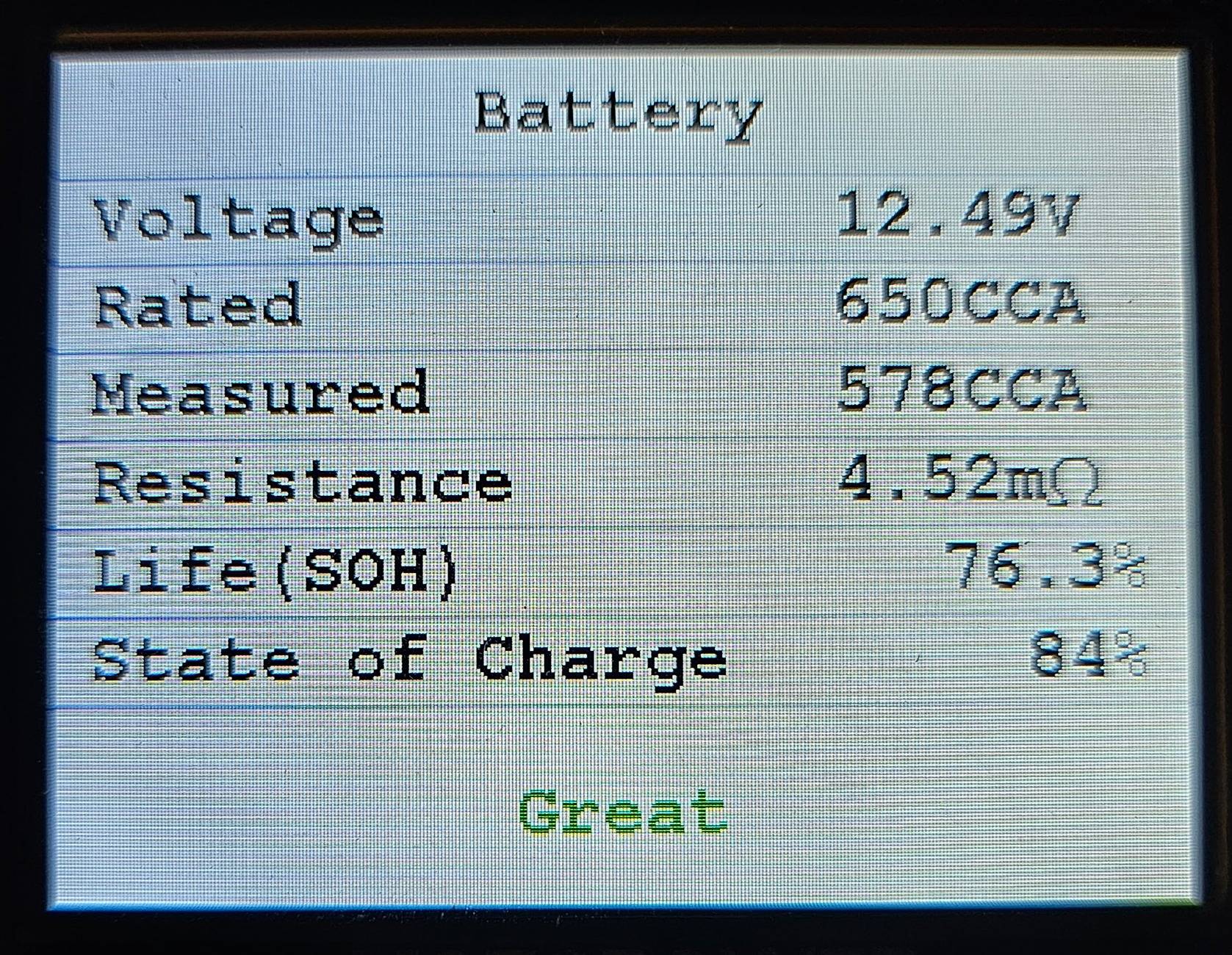

I guess I shouldn't complain, but just want to make sure nothing's up.
About 18mo ago dealer changed out both main and aux batteries. A few months ago the ESS light came up saying auto start/stop disabled. So I decided to disconnect the aux neg cable and pull fuse 42. Still I get ESS disabled. I was under the impression that would still work even without an aux battery assuming the main battery state of charge is good.
So my question is, how does below look? Everything looks good to me except the starting voltage. I'll eventually replace with h7, but until then just want peace of mind. Thanks for any input!
Jeep Wrangler JL ESS not working... 20241210_170411
Jeep Wrangler JL ESS not working... 20241210_170706
Jeep Wrangler JL ESS not working... 20241210_170200

Main volts is low but can be corrected with a good slow trickle charge, resistance is good, CCA’s is low but temperature can affect that but once starting voltage drops below 9-9.5 indicates a replacement.
I would put it on a slow trickle charge overnight and do another test if numbers don't come up as suggested replace the batteries, a bad aux batt is known to pull the main down.

Thanks for the feedback! I do have a trickle charger. I'll give that a try.

R3TRO wrote: "About 18mo ago dealer changed out both main and aux batteries. A few months ago the ESS light came up saying auto start/stop disabled. So I decided to disconnect the aux neg cable and pull fuse 42. Still I get ESS disabled. I was under the impression that would still work even without an aux battery assuming the main battery state of charge is good.
So my question is, how does below look? Everything looks good to me except the starting voltage. I'll eventually replace with h7, but until then just want peace of mind. Thanks for any input! "
First of all, make sure your dealer used an AGM battery when they did the battery change 18 months ago. The Jeep charging system is designed for AGM batteries. If your dealer put in a lead acid battery, he owes you new batteries.
Next, it doesn't matter to your ESS system if you have one battery or 2 batteries. The ESS system functions the same regardless. The ESS disabled message is indicative of something wrong (proof that the ESS guards are still in place even though you just have one battery).
About your battery....it failed the test. Replace it. I'd guess the low starting voltage is caused by problems inside the case, maybe a connection that is failing.

Thanks for all the informative responses!
Yes I double checked, is H6 AGM type battery. And no I was not aware of 'exactly' how the ESS system works! Looks like it's time for an H7 upgrade. I always carry one of those portable jumpers, but I don't want to make a habit of relying on it.
