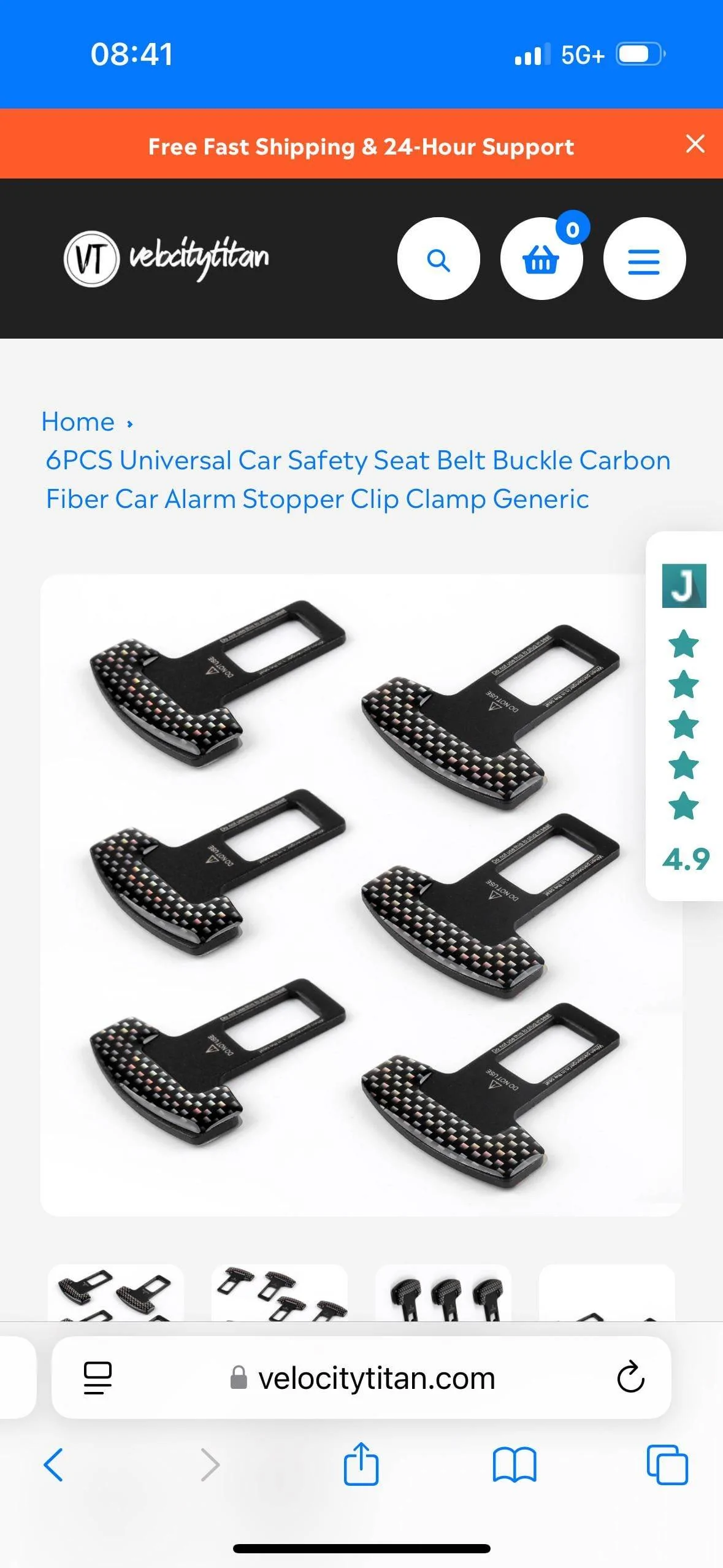

I think sometime soon, ESS will go the way of the seatbelt interlock.
Jeep Wrangler JL ESS Stopped Working (Again) disable-seatbelt-chime-2025-v0-fhx6rf1dzcfe1
But I've never used it, so there it is another thing in the glove box
