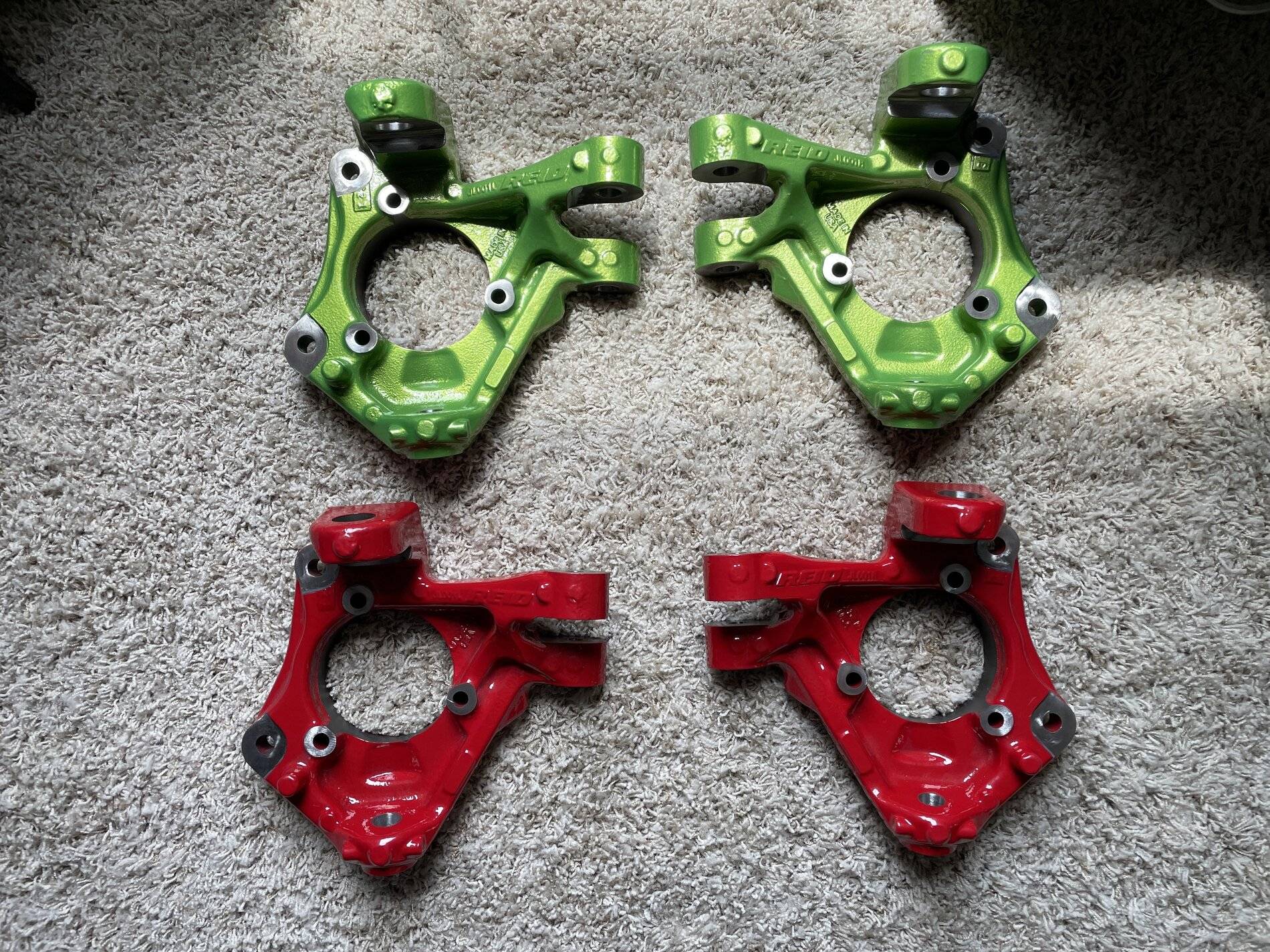

We’re late to the party, but fashionably late: just got them back from Powdercoating….couldn’t live with the orange. Have the DT BJs as well. Prob not this weekend, but soon!

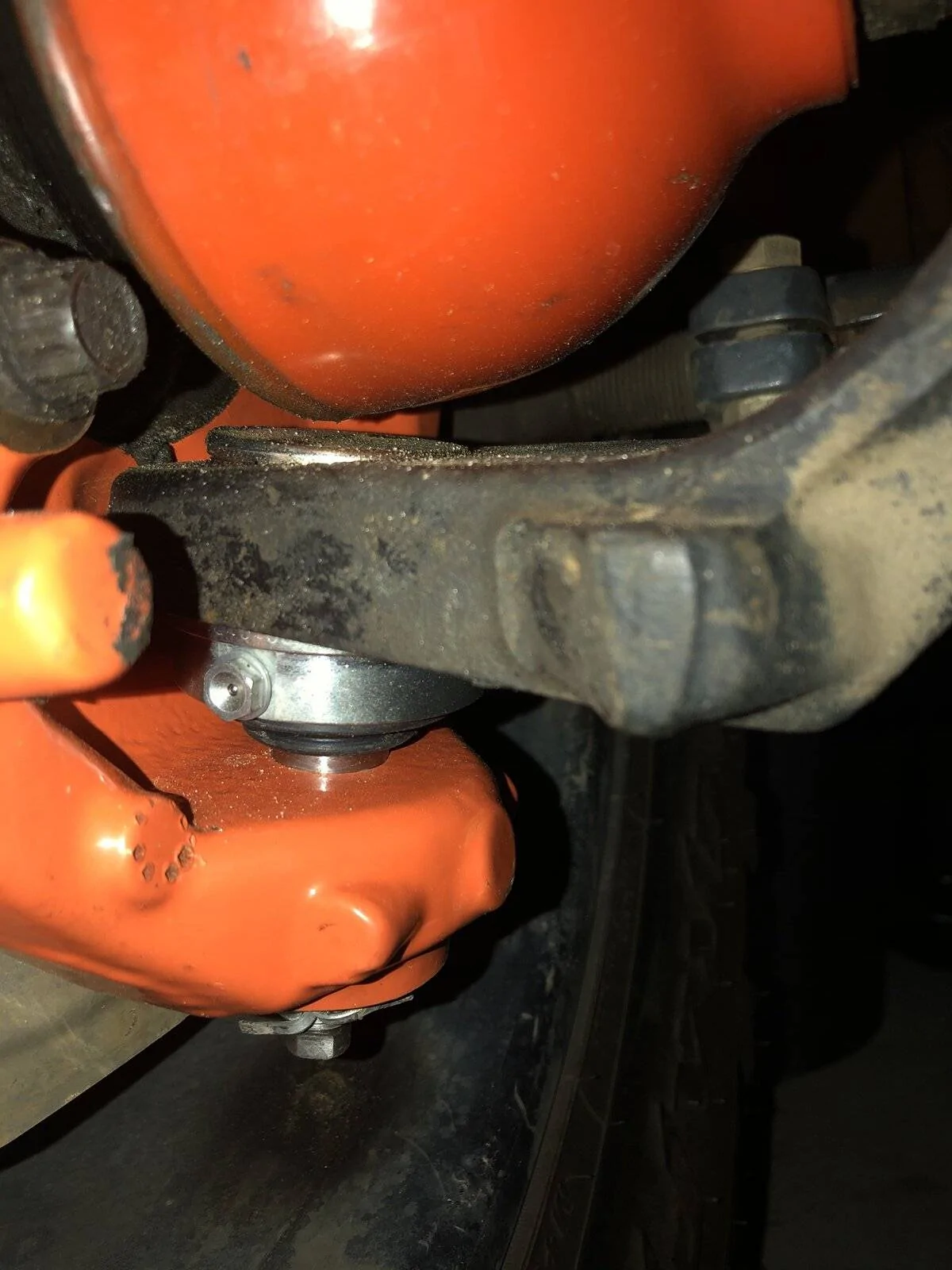

Thought I’d share this. It appears my upper ball joint holes were wallowing out on my stock knuckles.
Glad I went Reid. The aluminum knuckles are a shockingly soft metal.
Was that on both sides or just one? Looks like that would be caused by the camber sleeve not being tight in the knuckle, could be caused by loose upper ball joint (nut not being torqued properly) or an ill-fitting camber sleeve. Were the upper ball joint sleeves OEM or aftermarket?

Just one side. I can tell you for sure the ball joint was tightened to spec. I didn’t pay attention when I replaced my ball joints so there is a chance it was worn. It was creaking very loud when turning the wheel. Which is why I replaced them. The zerks would not stay in and water got in all of them and I didn’t know for quite some time lol. Anyways they were wrecked.
Oem sleeve. It was installed and looked the same as the other side. So yeah probably never know how it happened until someone else notices theirs and figured out a for sure cause.

The reason I asked is some of the aftermarket camber sleeves will NOT tighten in the knuckle-even at 20 ft pounds over torque spec and will destroy knuckles.

Ohh ok. I didn’t even know there were aftermarket sleeves available.

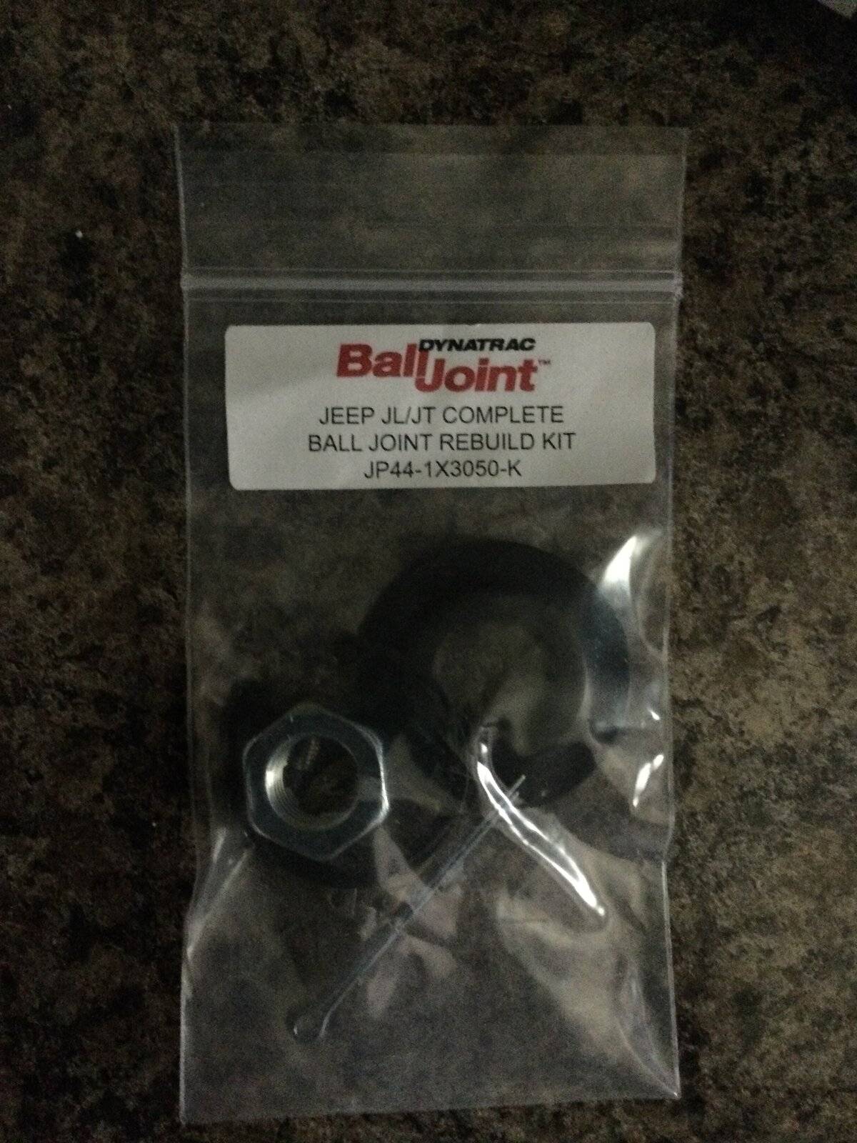

Mine is back again, but I did notice there was .050+ vertical play in the ball joints. Been waiting over a week for Dynatrac to send me the rebuild kit………UPS came today and they sent me everything BUT the heim joints. ??‍♂

Do you know what brand? I JUST ordered a set of SPC sleeves to use when I rebuild the ball joints. I figured mine have been out and torqued quite a few times so I was going to replace them just in case they got wallowed out at some point.
Now if Reid's offered them in Mojito, I would not have bought the Mopars. I will be putting a new set of Reid's on the chopping block soon.
