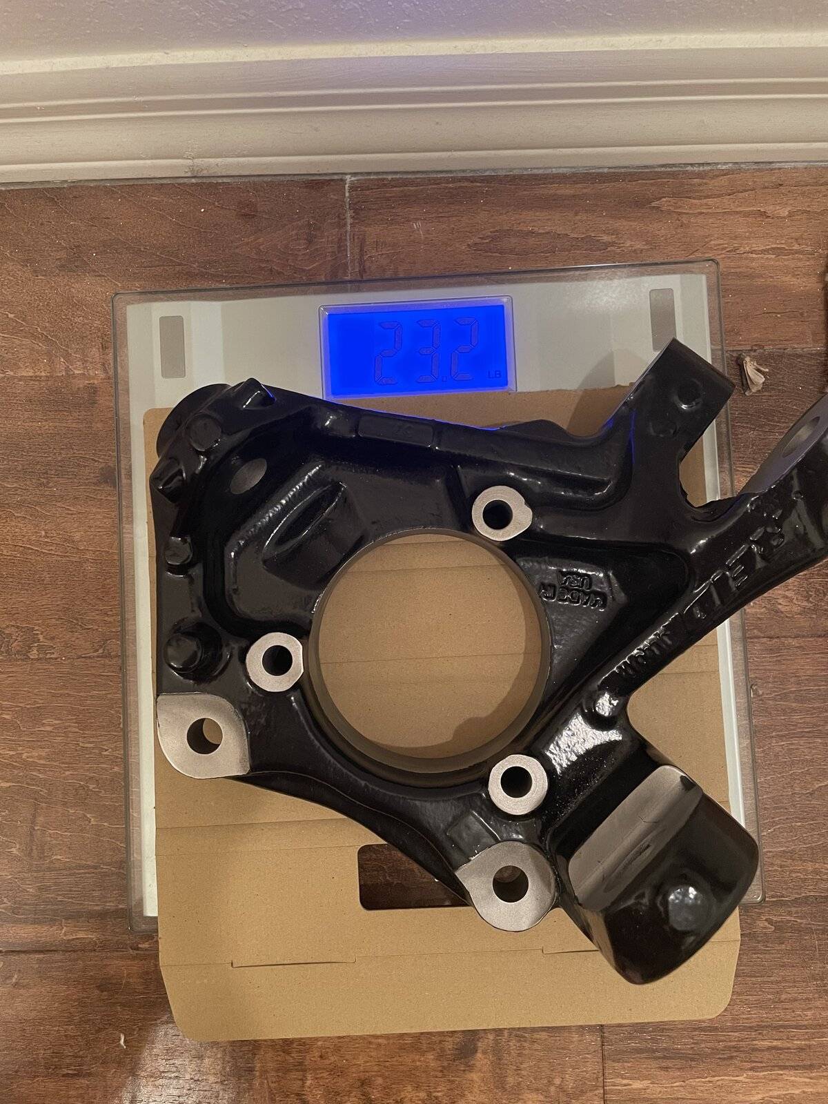

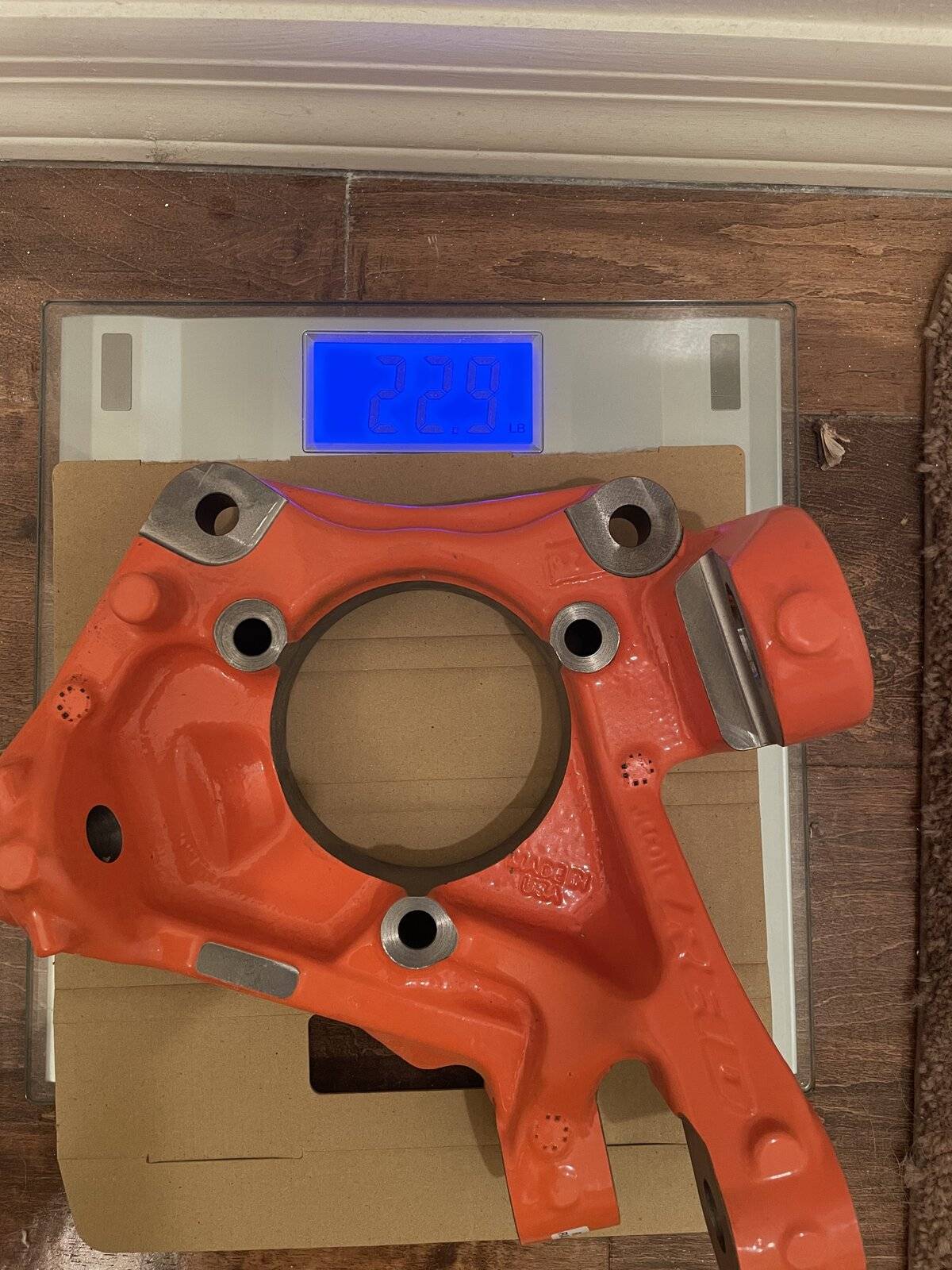

The 'weigh-in' Reid Racing vs Jeep Mojave iron knuckles...I received my Reid Racing knuckles some time ago and promptly had them powder coated black. (No offense to anyone but with a Bikini JLR, I want to keep the underside black) As my JLR has lots of down time as I wait for a new Dana 4.88 UD44 ( early July shipping date, sold my stock Rubi axle and my Mopar UD44 was defective) I decide to test fit the SteerSmarts taper bushings and the OEM camber sleeves for the upper ball joints...To my disbelief the camber sleeves were quite loose, one so much that even when I took a stock ball joint and torqued it 25 ftlbs over spec, the camber sleeve and ball joint were very loose. Northridge was great and quickly got me a replacement pair which are perfect, however since I really did not want to go through the process of powder coating again...I decided to to look closely at the Jeep Mojave iron knuckles (which come black) and have decided to go with the Jeep iron knuckles and will be selling a brand new (one not even opened) pair of Reid Racing knuckles.
CORRECTED:

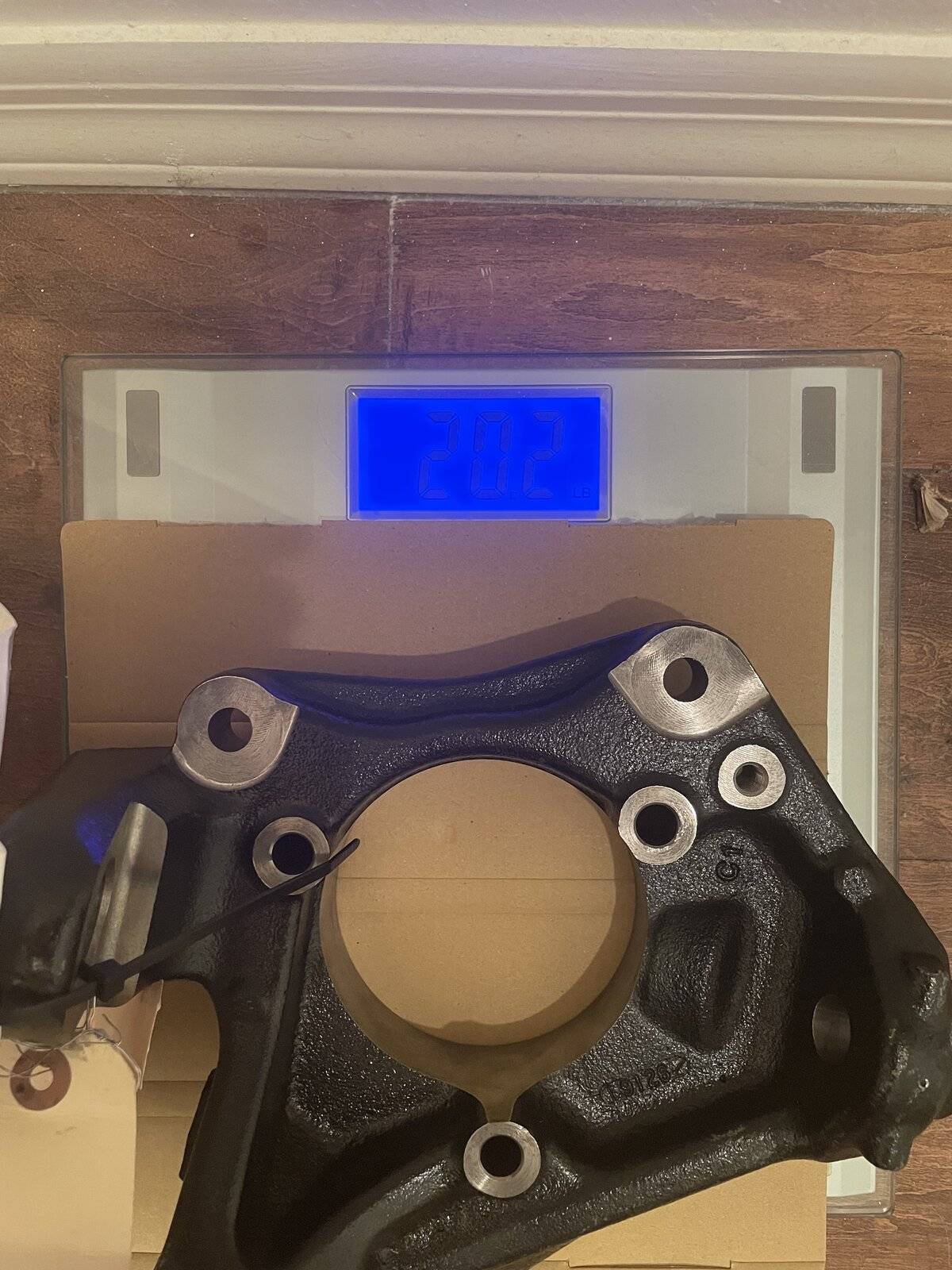

Back to the 'weigh-in'...The Reid weighed in at 22.9 pounds and Jeep Mojave at 20.2. Reid make great products (anyone can slip up once in a while) but the Jeep Mojave OEM are also very well made, already black and I do not have to drill and tap for adjustable steering stops.
Jeep Wrangler JL Reid Racing Steering knuckles IMG_2603
Update, Sorry, THIS was the defective Reid knuckle I had powder coated black...

Update: Sorry, THIS is the Jeep Mojave iron knuckle and weighs 20.2 pounds.
