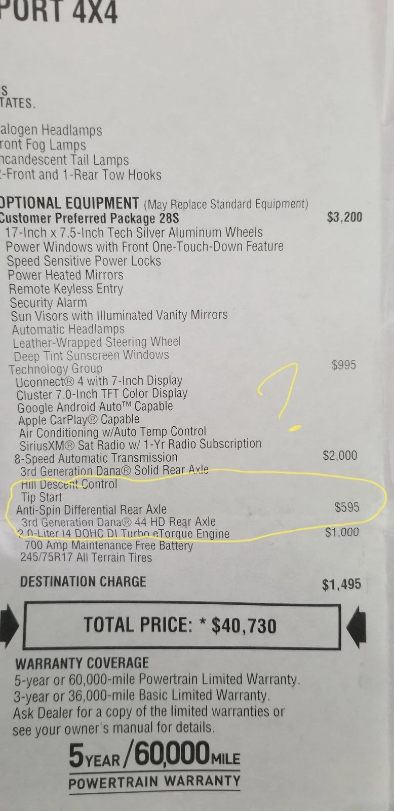

So that is a limited-slip differential. If your rear right tire starts to slip, it will lock up and send power to the rear left. even though you have a 4X4, it doesnt mean all 4 wheels get power. Thats why you still need a Rubicon or aftermarket setup to get all 4 wheels engaged. I will say that I had the LSD on my JK. Match that with a really good all-terrain tire and it got me through almost everything. I ended up putting in a front e-locker and keeping the rear like that. It is worth that extra $600.I agree, I will start with that list and see how the performance improves. What is this upgrade option that was included with my Sport S? Is this standard or a real upgrade and does it help with me having 37s?
