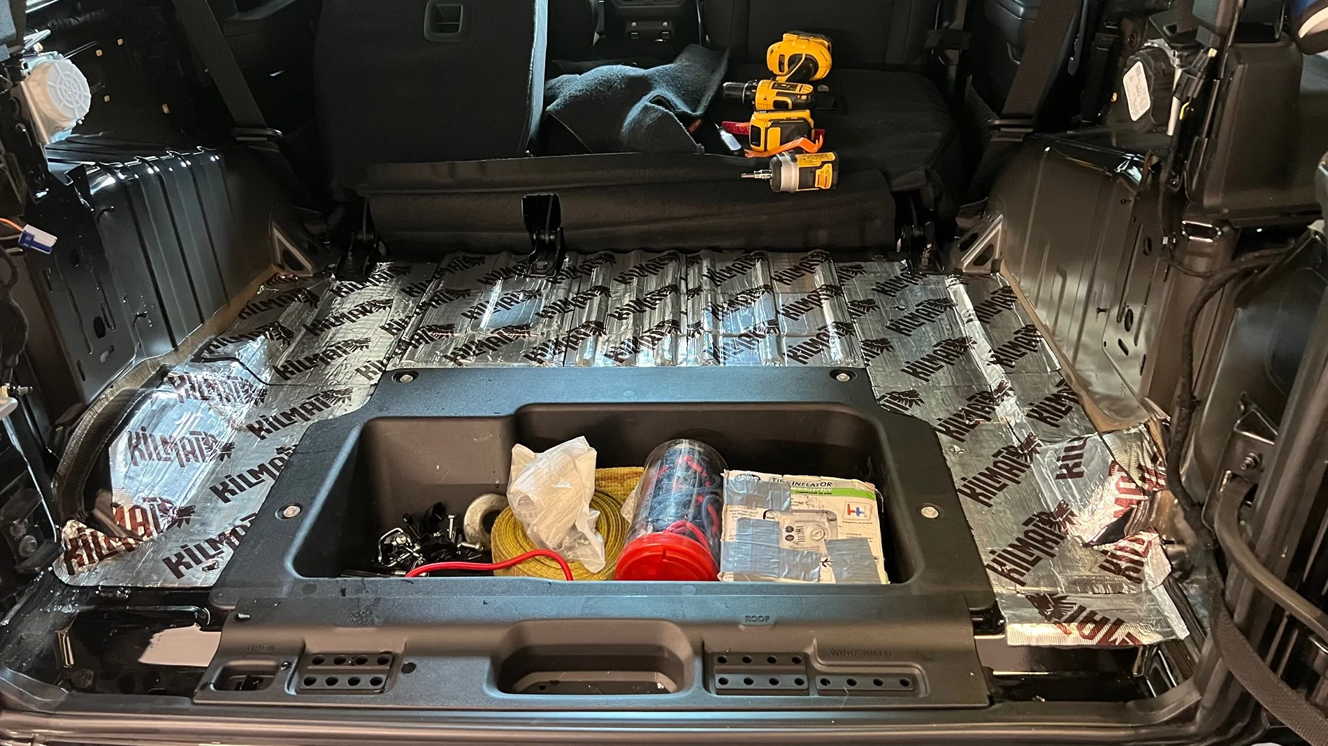

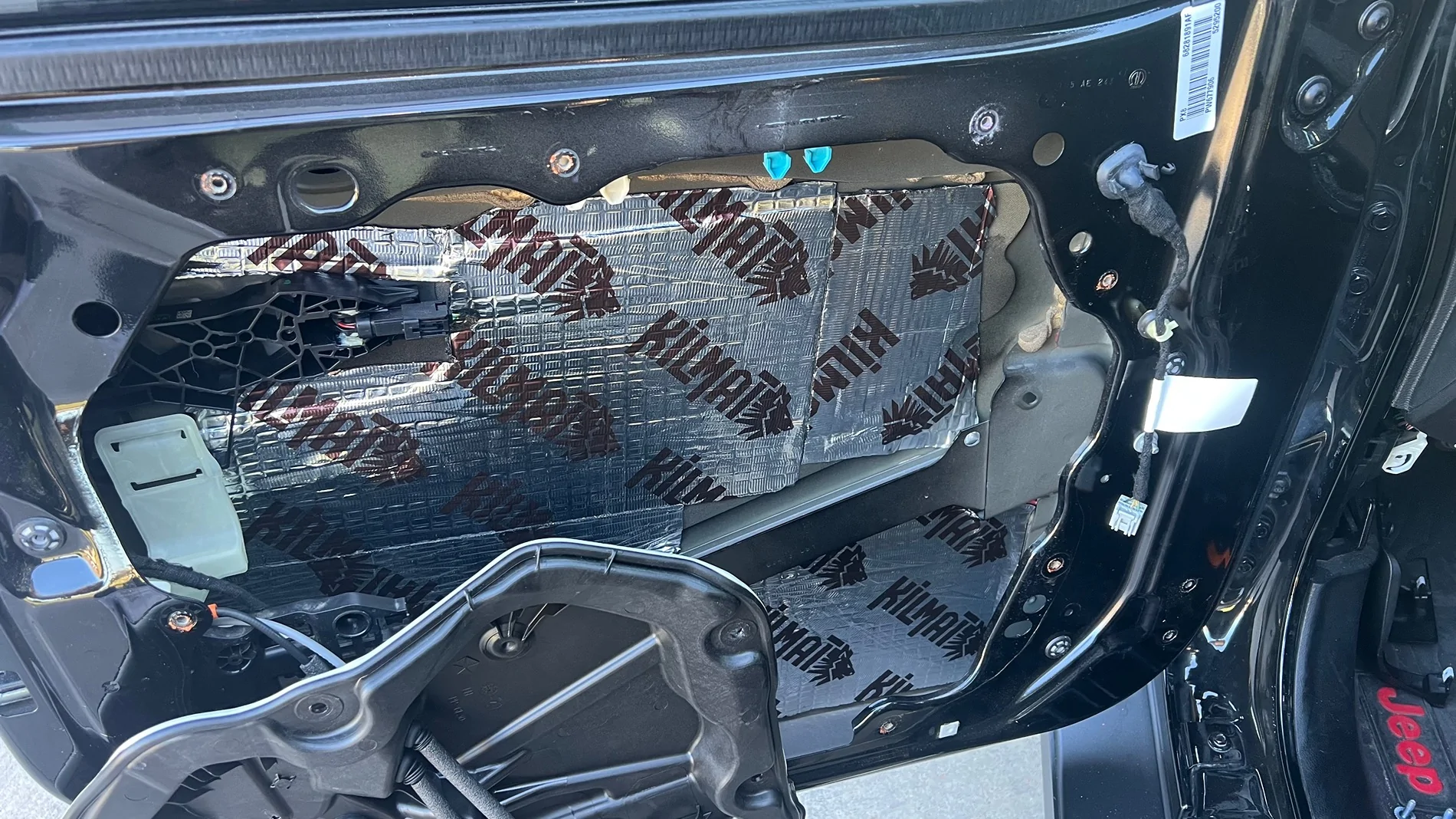

I have completed the following on my JLUR and it has helped:
-Hothead headliners with sound assassin strips to hard top(top &sides)
-Apply sound deadening material to tub & floor. I’ll used Kilmat via Amazon
-Apply sound deadening material to door skins (kilmat).
While all of these combined has made a significant difference you can’t make it feel like a Lexus, etc. The biggest improvement is at speeds <65mph. Once you get up to 70+ the wind noise wins. Maybe acoustic glass on the windows would help. I do know that when I added the sound deadening material inside the door skins it helped with road noise and sounded more refined from bumps , small road imperfections , etc.
