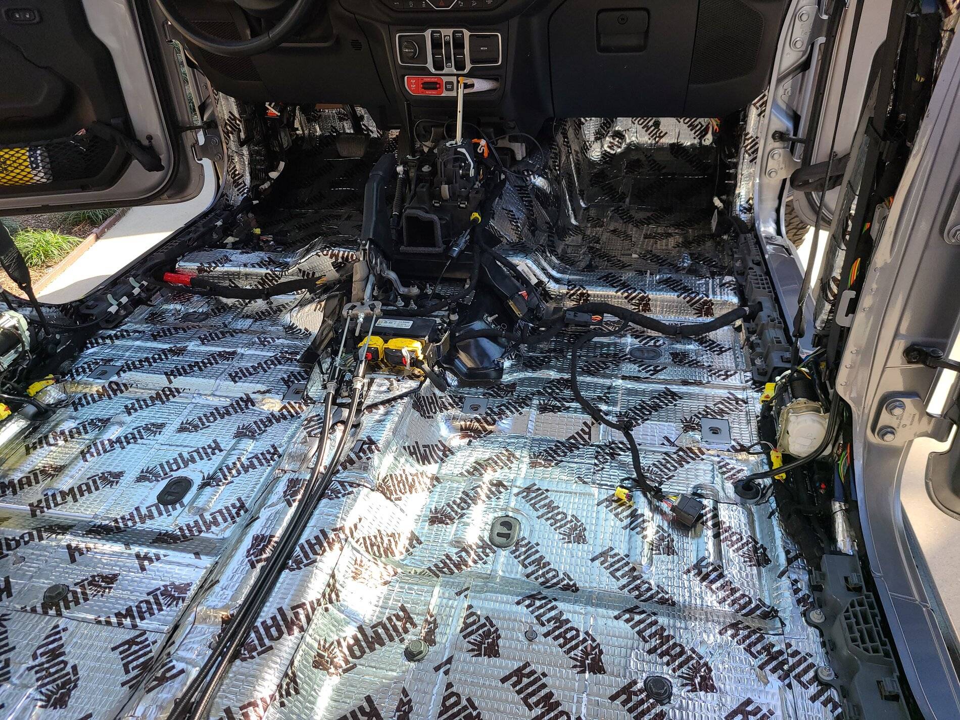

I put 80 mil Kilmat throughout my floor. I don't feel any heat and the sound level is notably lower.
While Dynamat is the gold standard, I believe Kilmat has become the economically available equivalent.
Ah, so this is what commitment looks like. After wrestling with the front driver's side kick panel trim removal to do a little door wiring, I don't want to imagine how long it took to do the job you've done there.
WHOA!!!!!!!!!!!!!!!!!!!! Wow. Someone is crazy ambitious. I can not imagine doing this. Good for you.
I stripped the interior including sides and B pillars. Did it over about 5 weeks. Didn't work on it every day. But maybe 4-5 days/week. Of course, I'm retired and had another vehicle.
I put a 1/4" foam insulation on top of the larger areas, kick panels and sidewall panels.
Sam
Not really. I was just bored at the peak of the pandemic.
You can get it done in sections. Pull the carpet up in the front and start sticking it down. No need to take it all apart at once.
