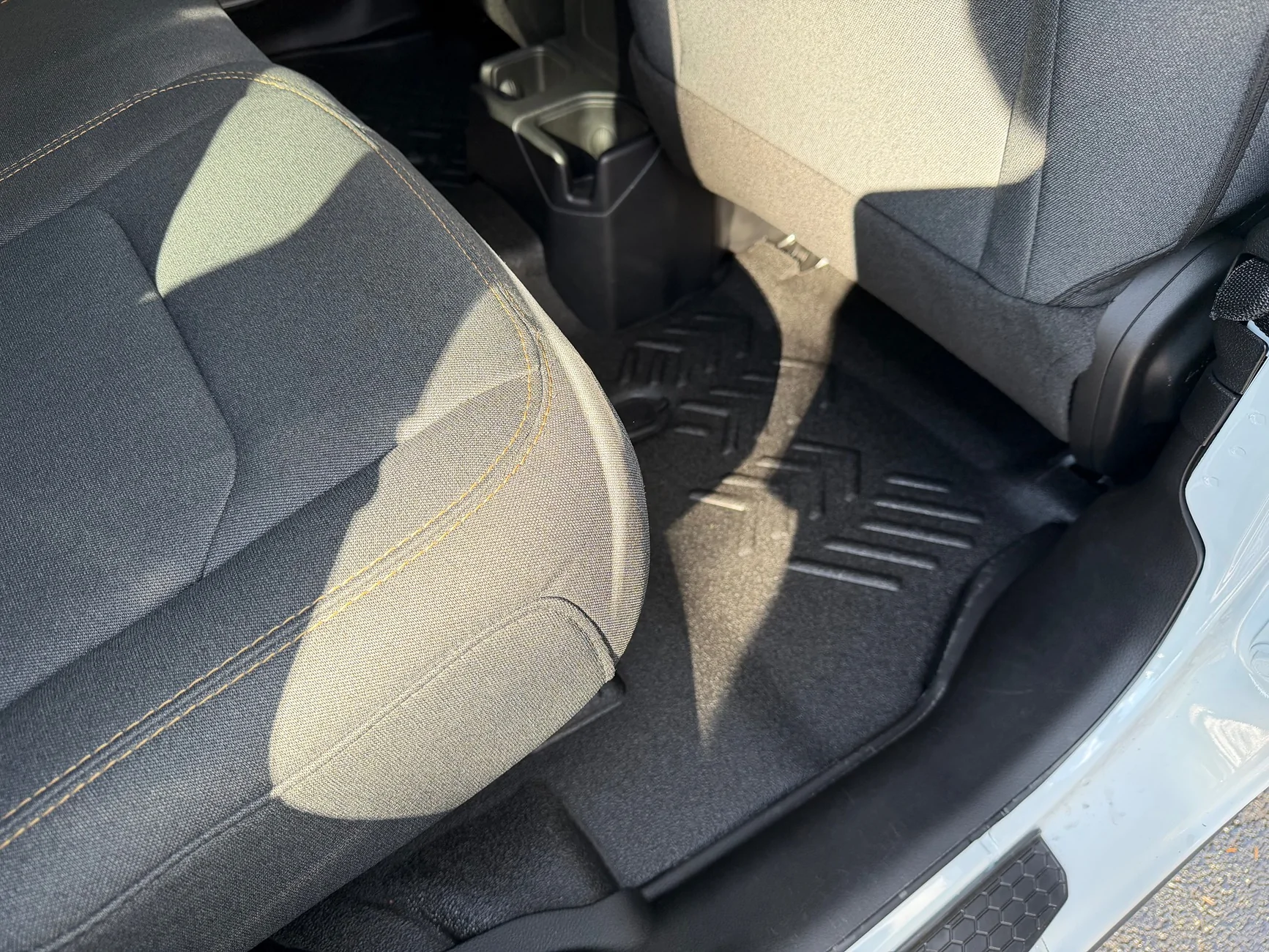

I covered my floors with sound deadening material . It helps with the noise and insulates the transmission tunnel keeping some of the heat from coming into the Jeep. I have a two door and I have the seat out for my dog to ride around. That was my primary concern.

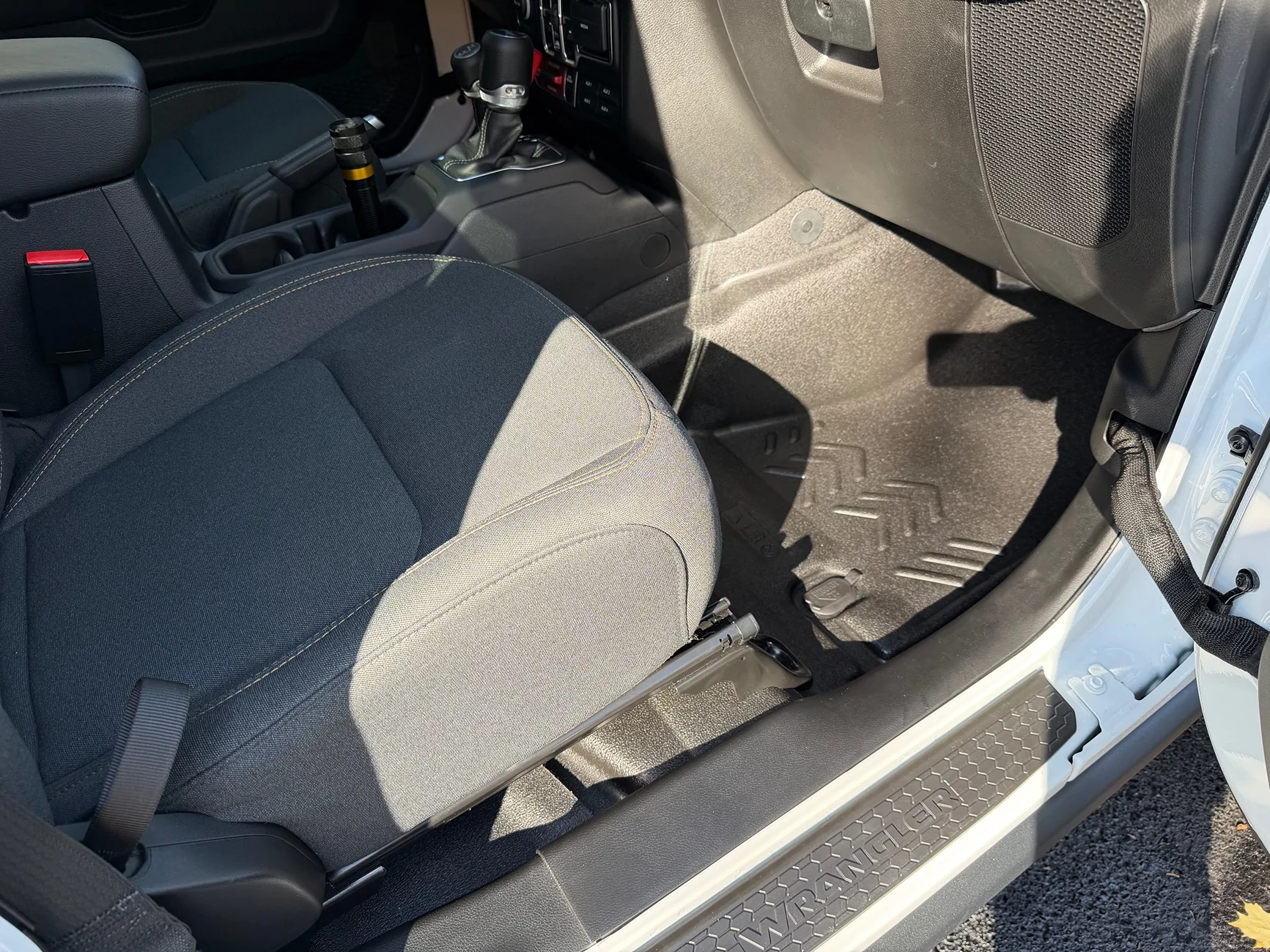

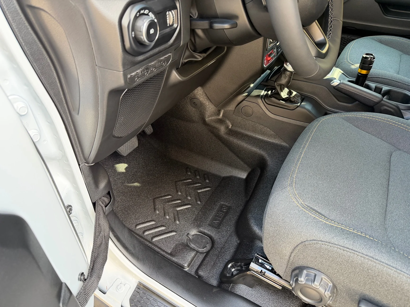

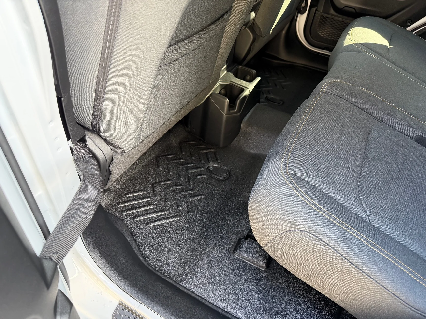

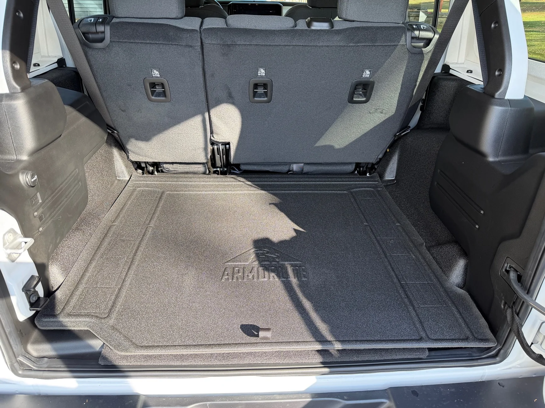

Installing Armorlite flooring did help to quiet mine down a little. Eventually I’ll do the Hothead’s hard top liners when my wallet recovers. Most of the road noise I hear now is from the top especially in windy conditions.
https://goarmorlite.com/collections/2024-wrangler-jlu-4-dr

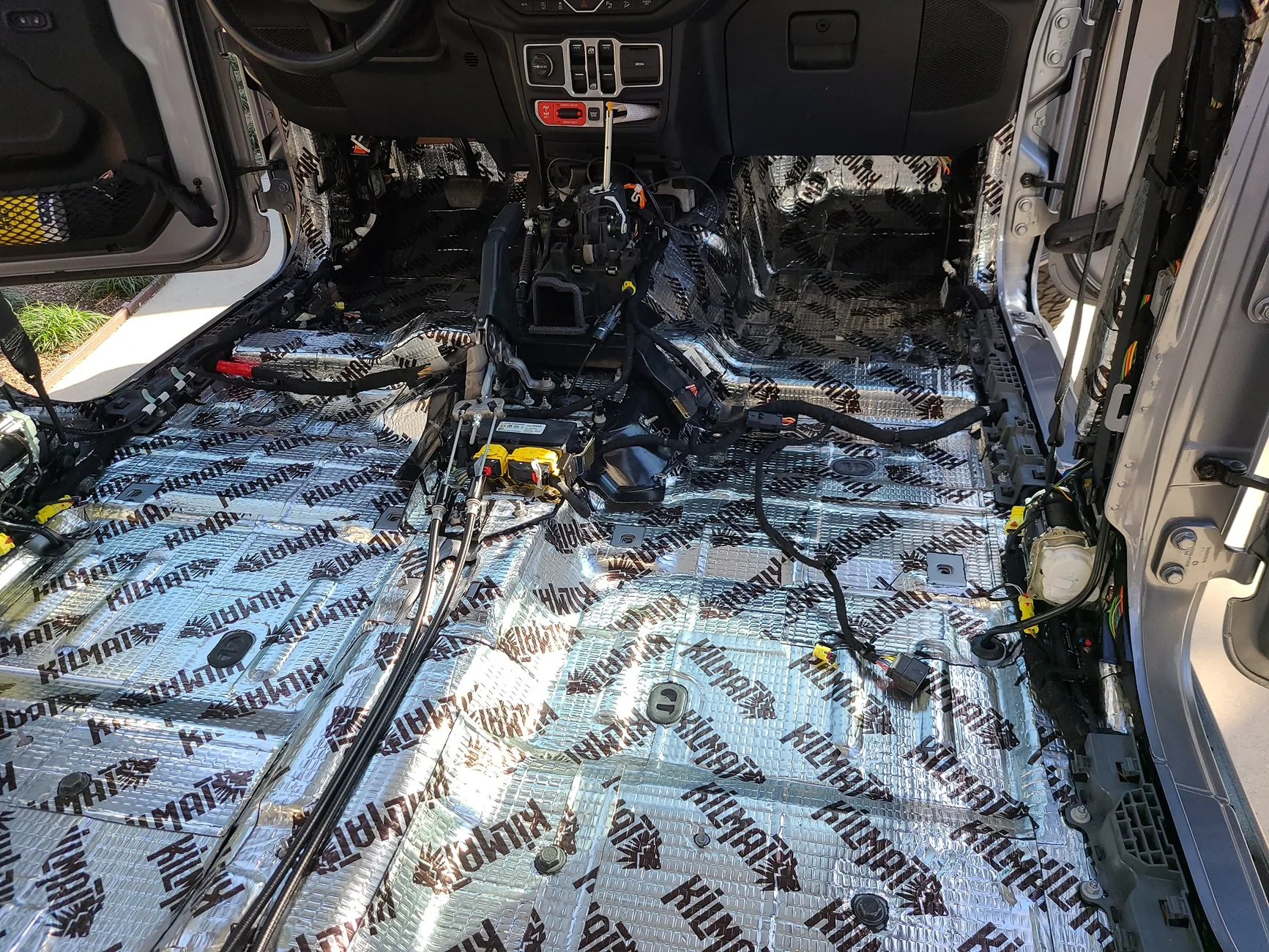

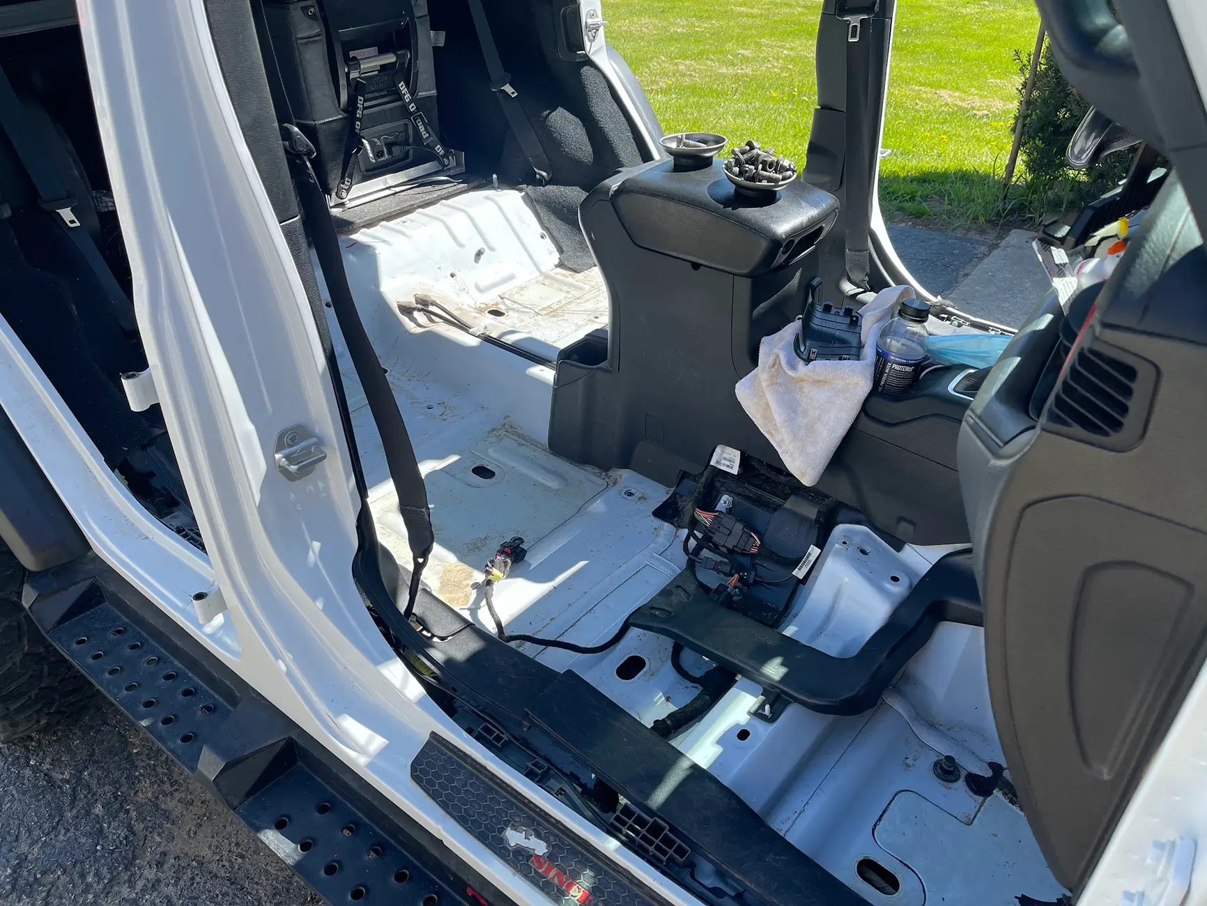

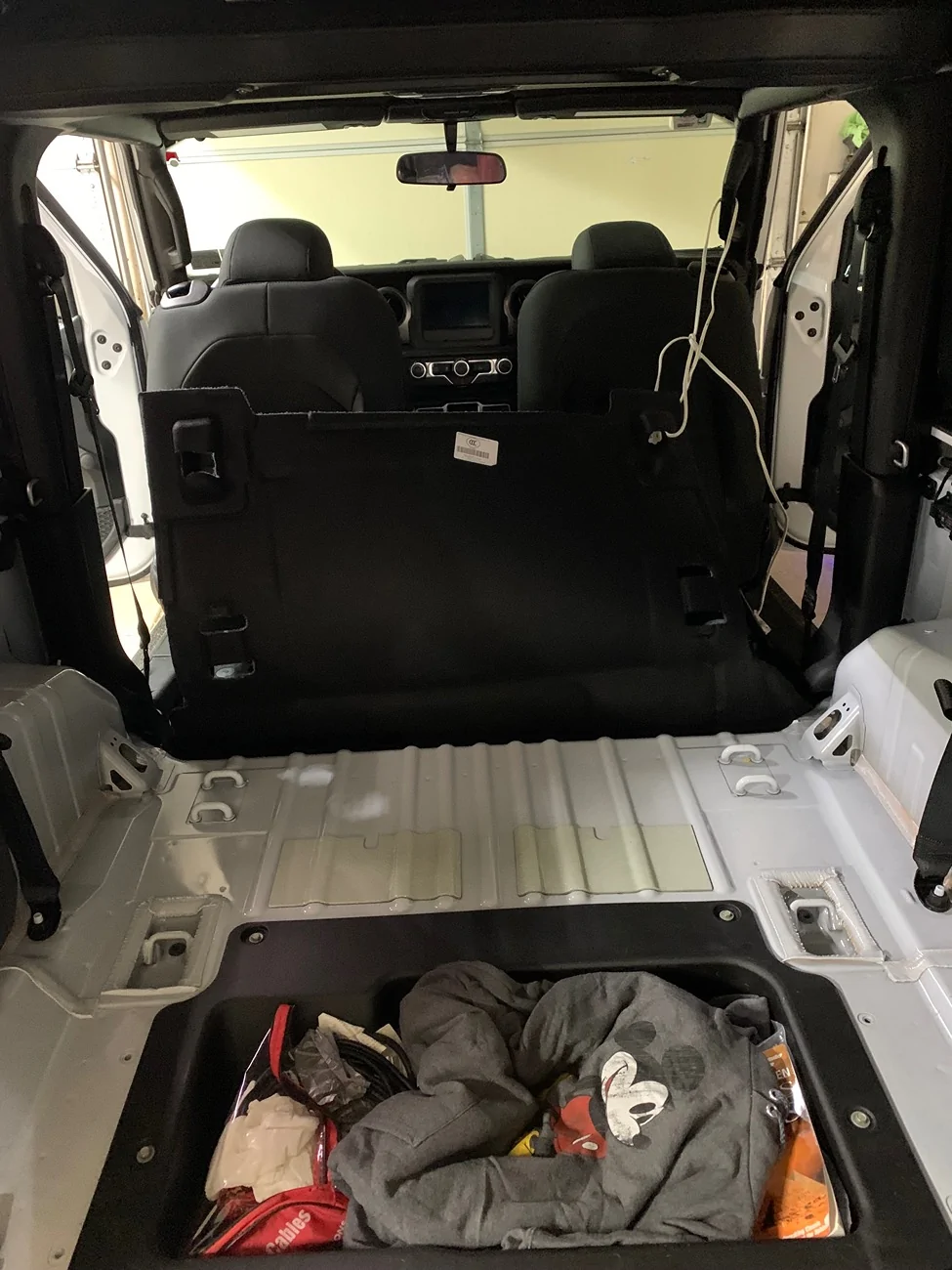

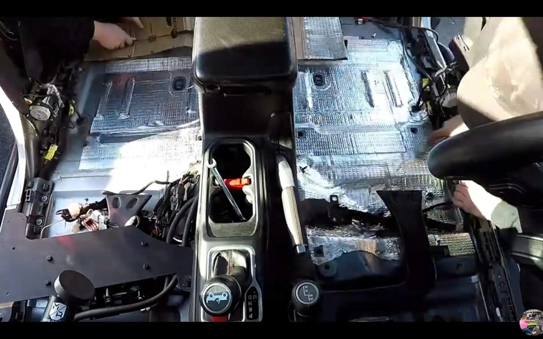

I also installed the Armorlite flooring system. I put down sound deadening material on the tub first. I made the Jeep way quieter.
Before
Jeep Wrangler JL Reducing cabin noise 1765201290186-3c
After. well in the process of after.

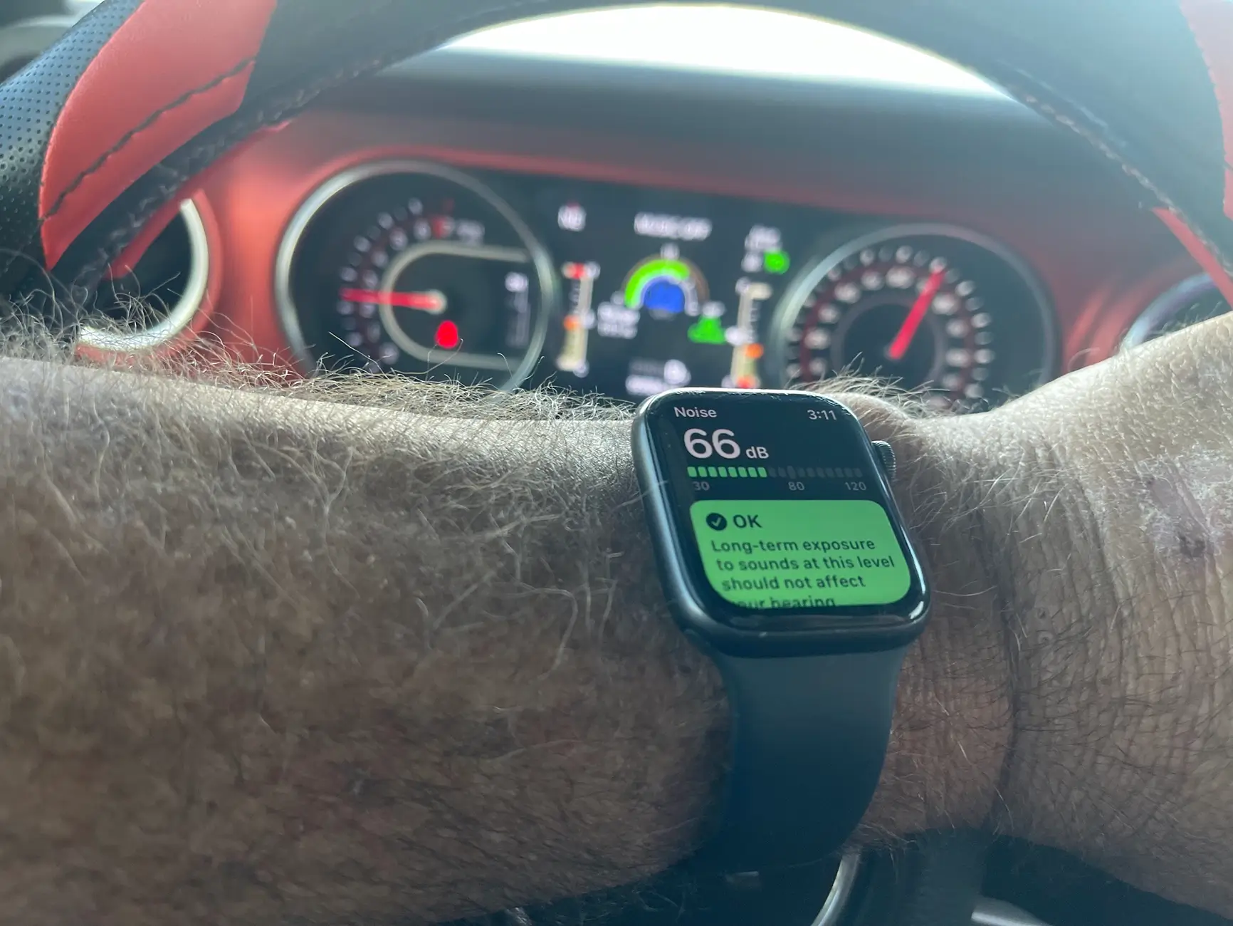

My Apple Watch shows 66 decibels at 70 mph. Not bad at all.
Jeep Wrangler JL Reducing cabin noise 1765201493220-rl

With the Cargo Dog boxes is the sound deadener under them still worthwhile as opposed to just the OEM carpet? I know they’re super easy to remove and install

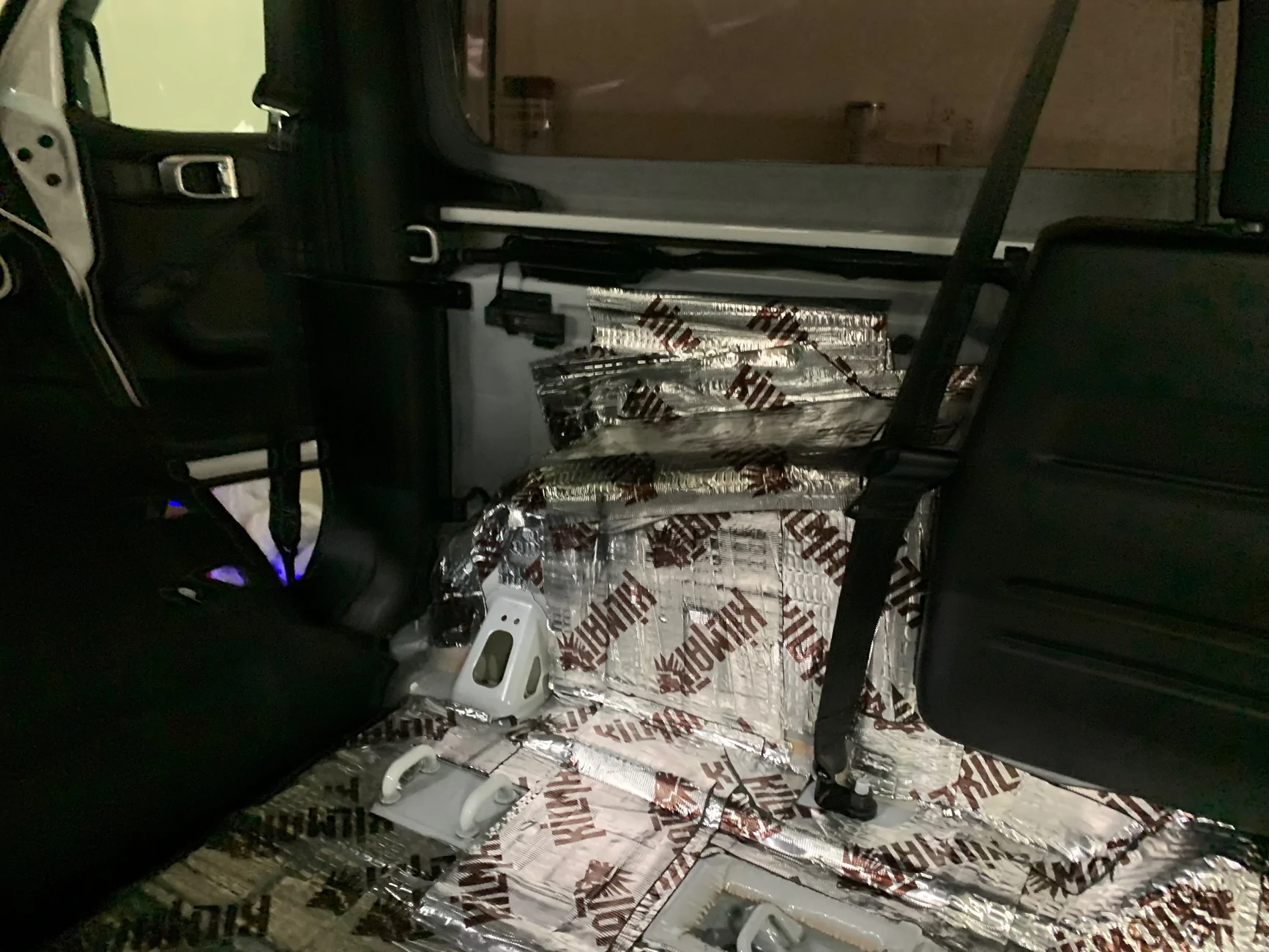

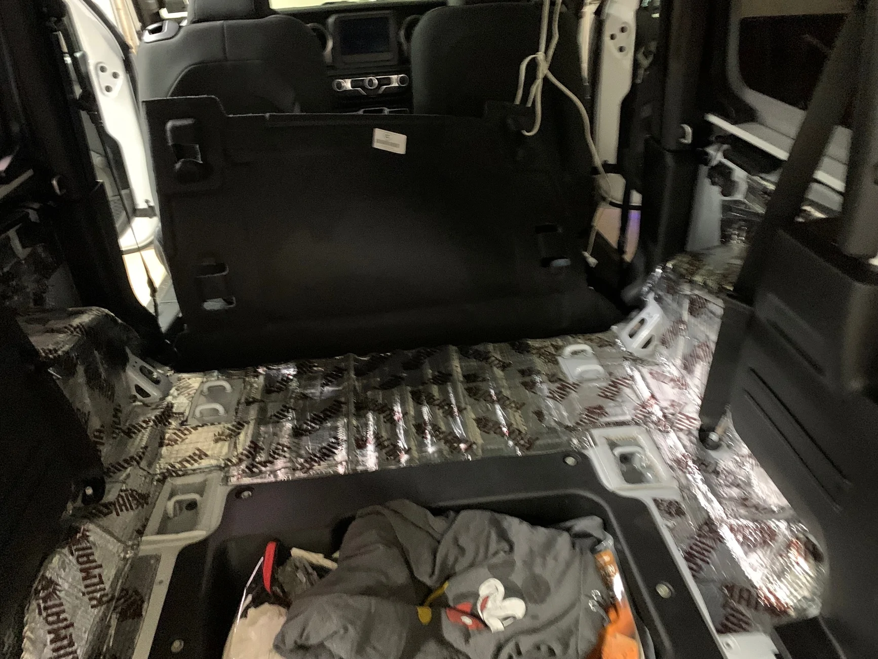

During the pandemic, I was bored and did this. That's Kilmat and then the gray stuff is a thermal/sound insulating foam from Dynamat. Do this to the doors and they sound like a Mercedes when you close them, instead of a beer can with doors. I noticed it keeps a lot of tire noise from under the vehicle, out of the cabin.
