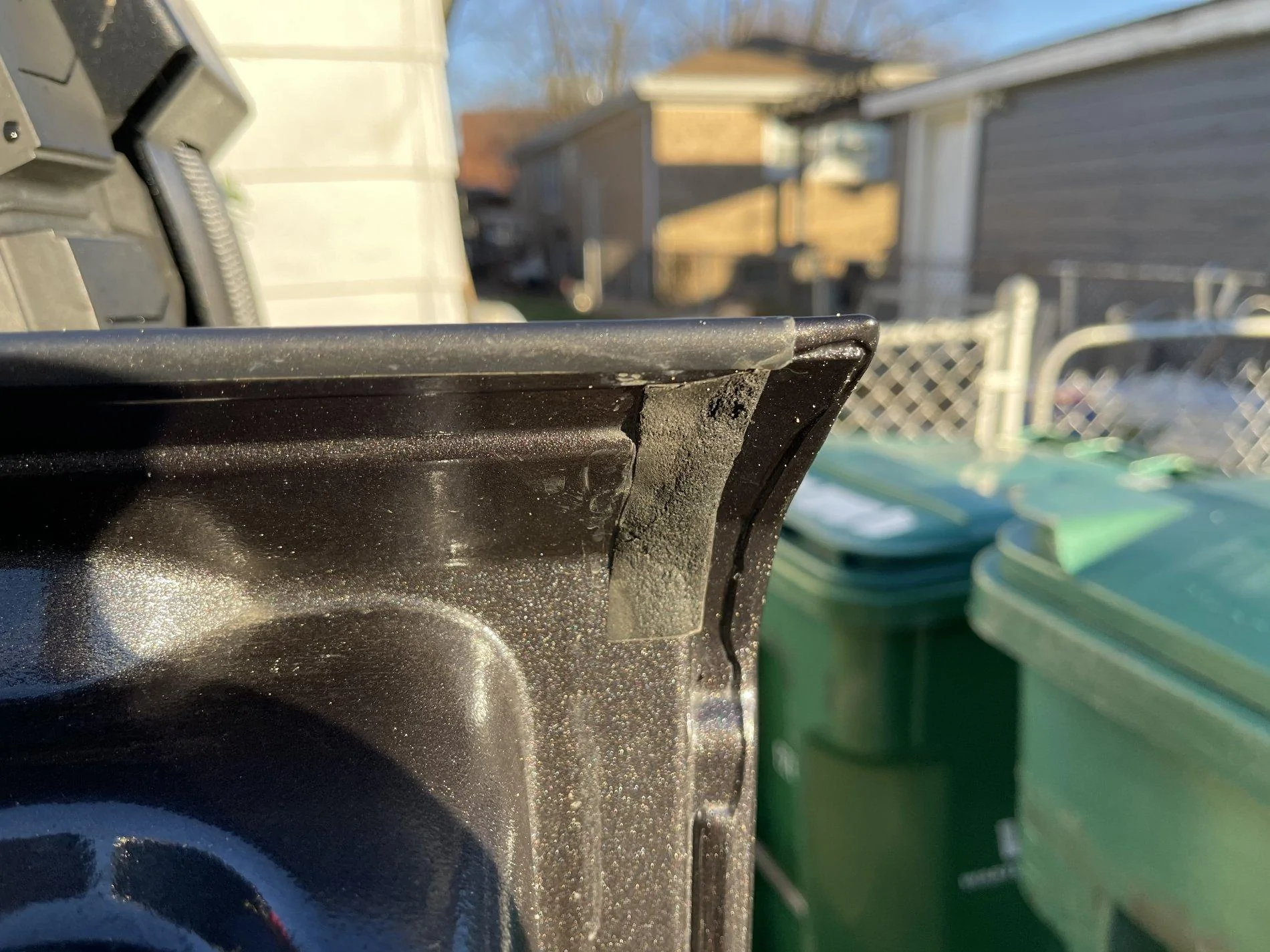

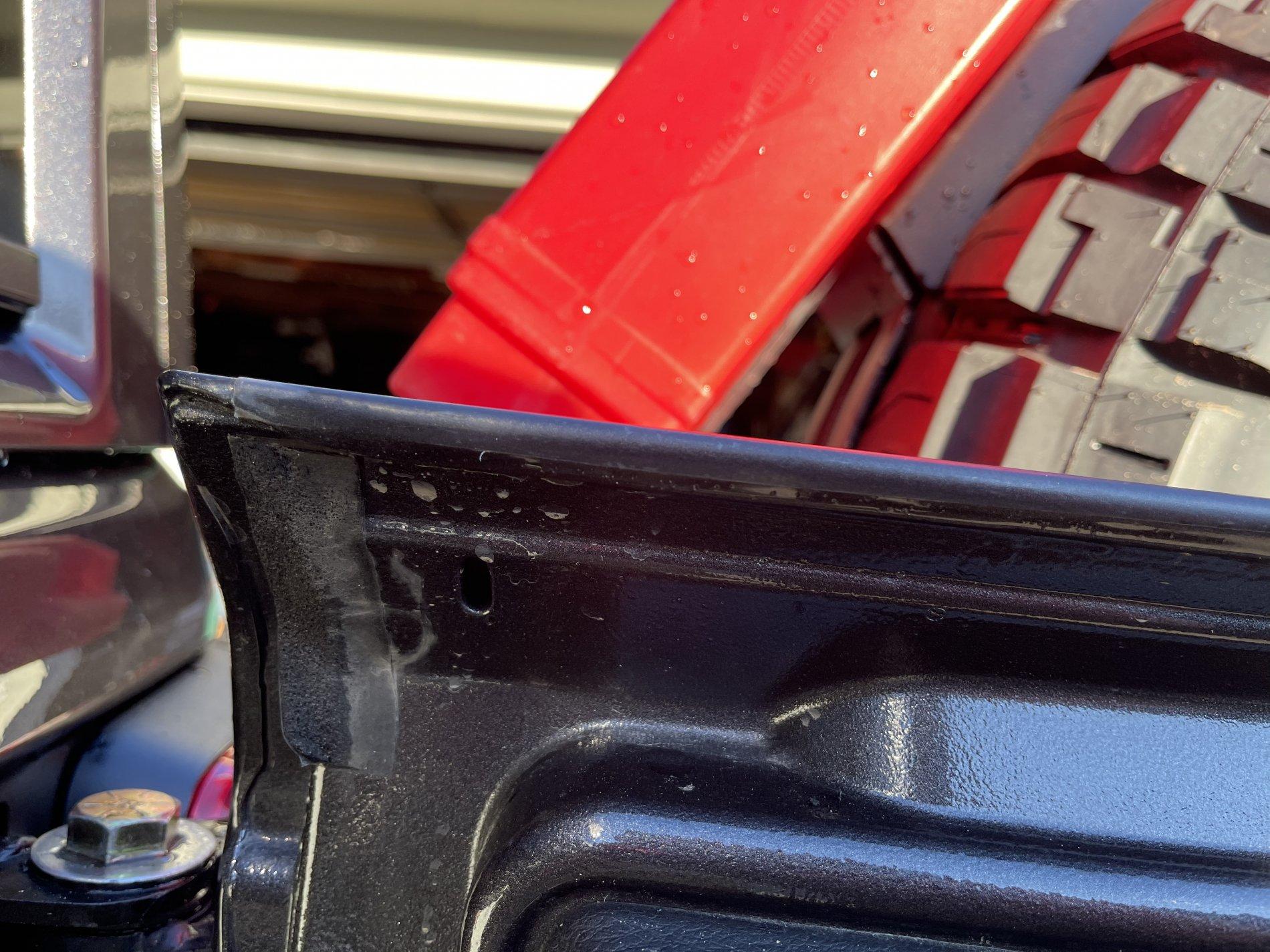

BTW, that will eventually wear off so I went the route of Teflon Tape. I bought some and taped/folded it over the lip of teh tailgate and voila... gone forever!

Glad I could help. Personally I got tired of applying the lube every few months and switched over to the Teflon tape method I describe up the thread.
