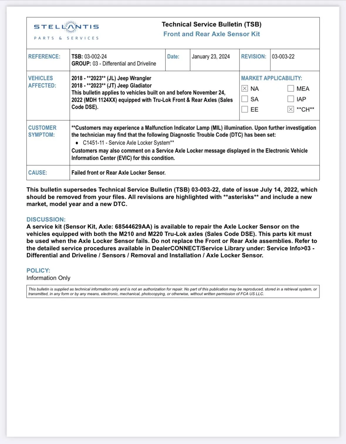

i would take it to the dealer. sounds like the sensor failed that tells the BCM the locker is on or off. its a know issue that seems to fall between the cracks. Luckily you can now get just the sensor and not need the full axle to be replaced like they did a couple years back -_-. quick fix though under warranty

Thanks so much for sharing. At least it solved MY issue 👍
Had the same error message: 800miles on my new Wrangler 2024, yellow drivetrain light on dashboard + rear locker light, blinking intermittent on Highway, but no error code in system.
Dealership checked but „didn‘t find anything“ and refused to go on further investigation.
Based on my insight from this forum topic I insisted opening a case with Stellantis. Showed them the TSB above along with a short video (!) I made when error happened.
Finally dealership agreed, and - surprise, surprise- after a check with Stellantis they told me that it‘s exactly the TSB above. Wow!
Dealership ordered and exchanged two sensors in the rear axle then - certainly on warranty.
Just wanted to let you guys know and give big thumbs up for everyone who contributed here!👍🙏
