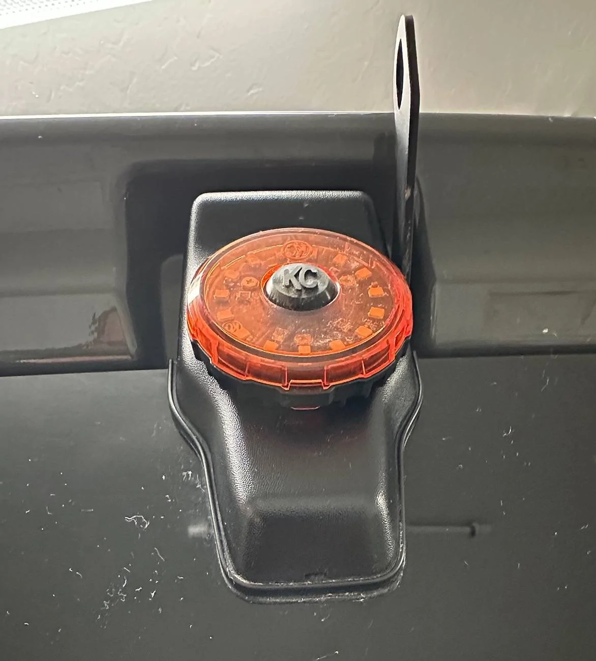

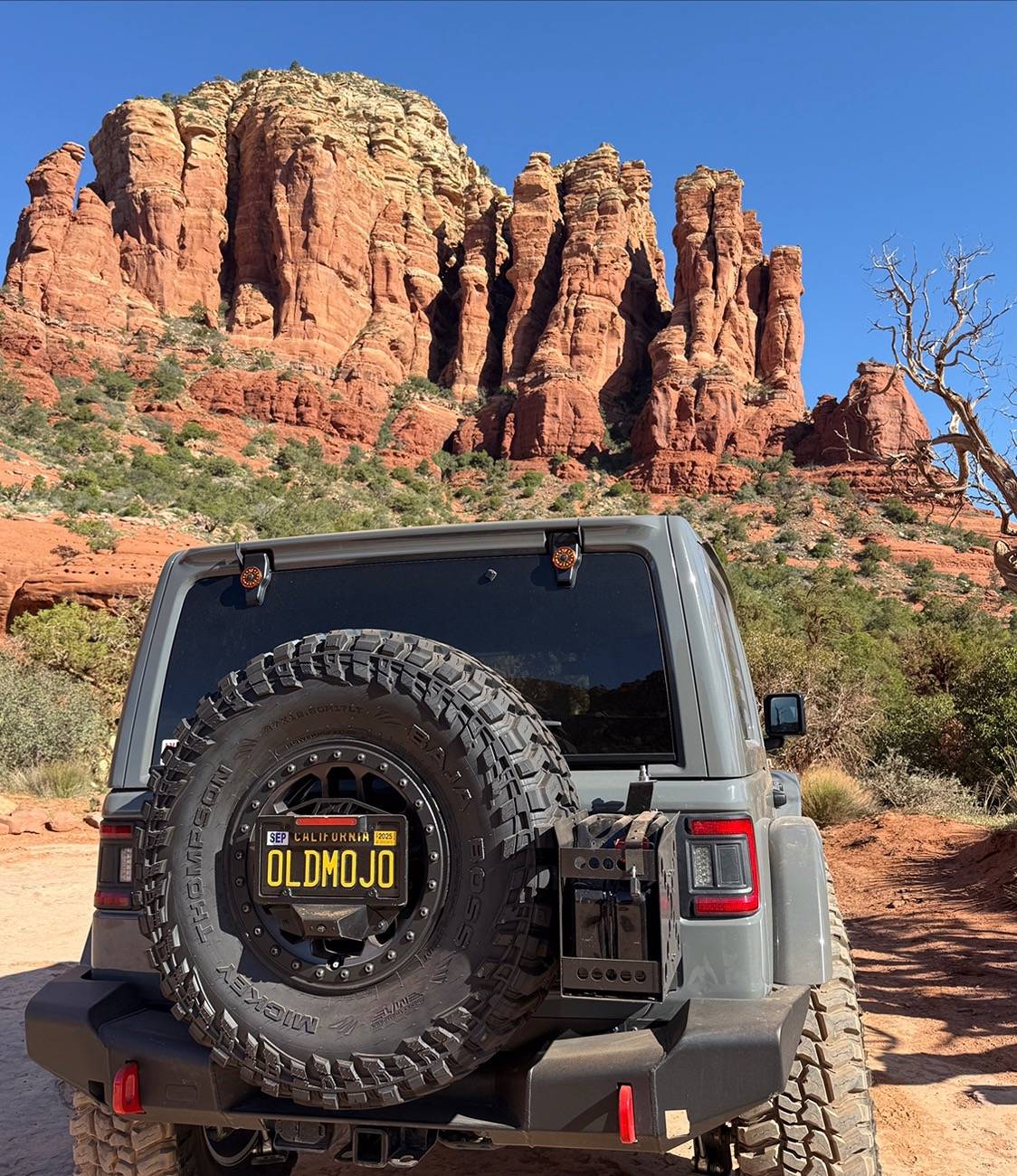

I would think the strobe should be on the outside of the glass so it will not reflect against the glass and flash forward or in your rear view mirror. There are several companies that make brackets (for light or light bars) that attach to the rear glass hinges on the outside. If you are worried about someone damaging your exterior light I would encourage you to build a shield around it if you mount it inside.
