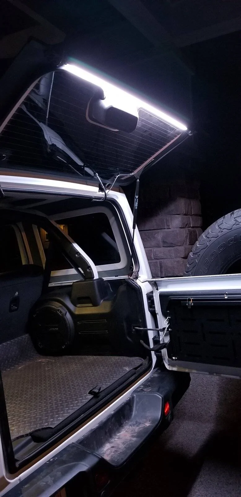

I bought a Brawlee RGB striplight which mounts along the lower edge of the liftgate. It's plenty bright to illuminate both the cargo area and a tailgate table when the tailgate is fully opened.
Brawlee RGB LED Rear Glass Lift... https://www.amazon.com/dp/B088F6ZGBB
It comes with everything you need to install it & connect to your dome light or the cargo area 12V cigar lighter socket. Excellent instructions. Has a remote control and an app to control light color and brightness. I'm VERY happy with this purchase. Jeep should include these as a $100 option.

Could this be wired up to an aux switch and wire run to the back?
Yes. I alternate between leaving it connected to the interior lights and plugging it in to the cigar lighter in the cargo area (fuse moved so that plug is on all the time). When connected to the cigar lighter outlet, I use my phone app or the IR remote to control it. I'm still very happy with this upgrade.

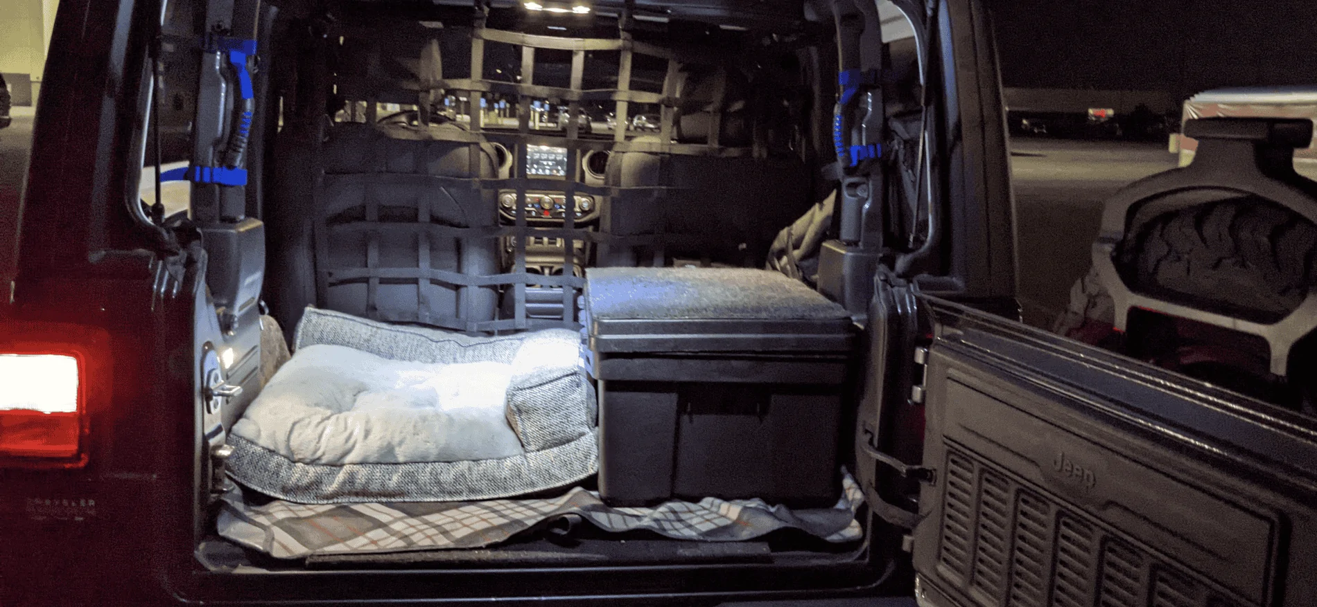

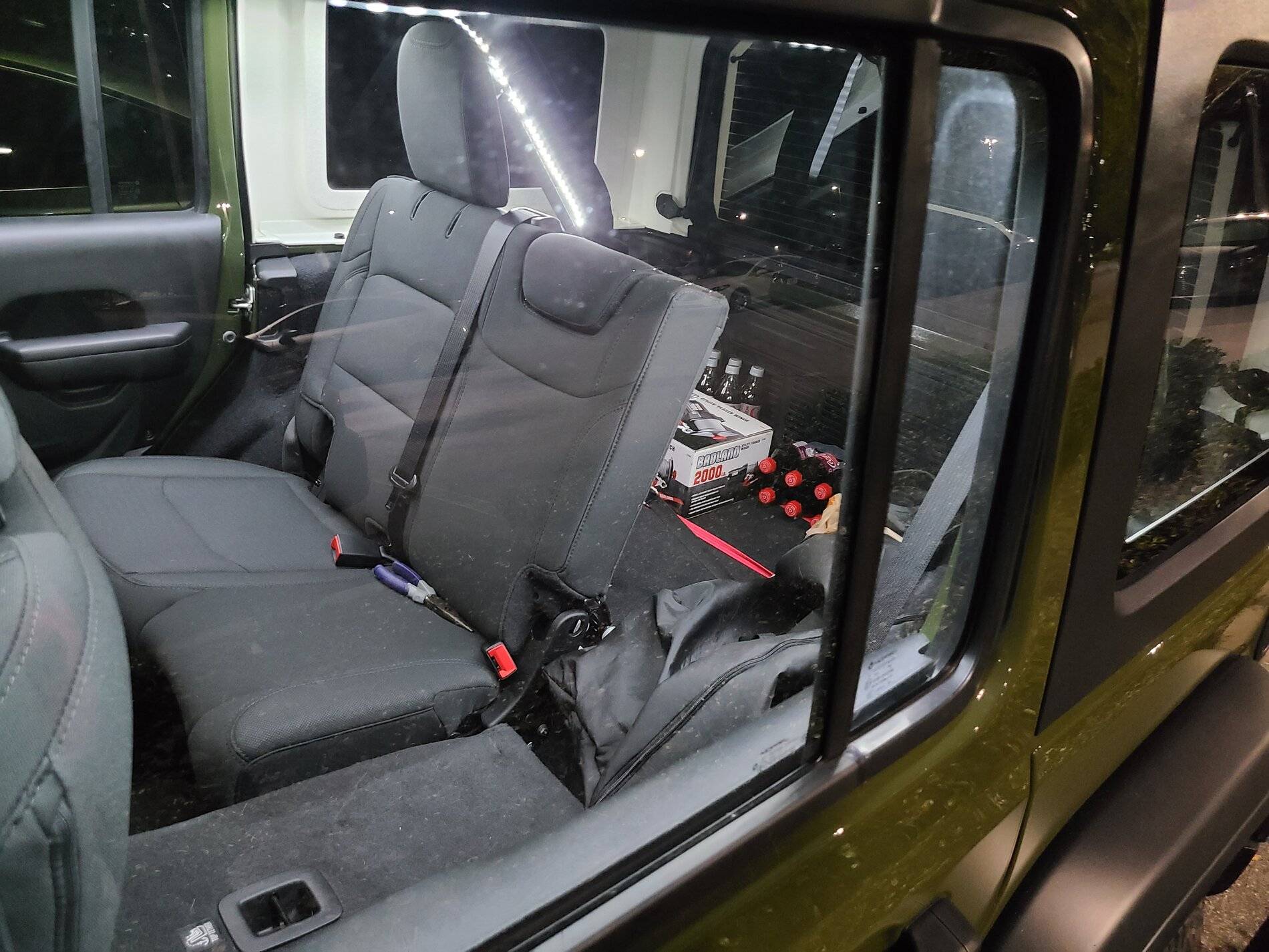

I got some self splicing clips from auto zone, ran wires behind plastic roll bar guard, and spliced into dome light. "Taped" them to underside of roll cage. No visible wire. They are bright! Pic was at 3am.
