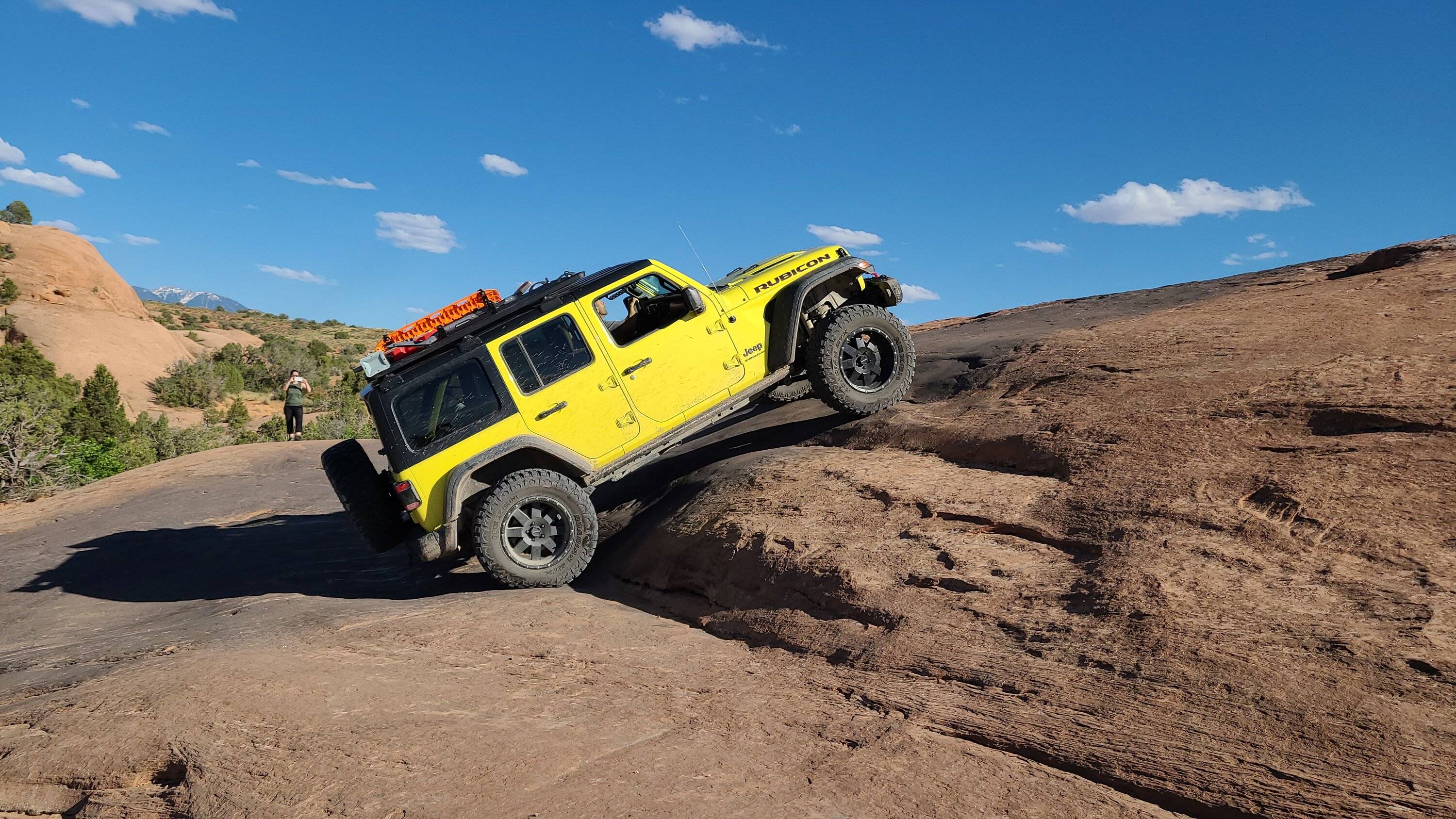

I’ve appreciated reading the experiences of everyone on the Forum. I’m now glad to be part of the group. Questions: I have a 2023 Diesel JLUR, running 37s, 2.5” lift, on stock D44s. I am considering either re-gearing to 4.56, or biting the bullet and installing D60s with 4.56.
1. I’m really concerned with trusting dealership to re-gear. My experience over the years has not been good. Thoughts on dealership vs specialty shop?
2. I don’t see going larger than 37s in the future. My rig is a daily and very often on the rocks or trails. It seems 4.56 will get me closer to OE spec, but would you do 4.88 just in case you go larger in the future?
3. The D60s add more capability off-road. If I stay with the D44s and re-gear, I’ll likely upgrade to better axle shafts.
Thoughts?
Thanks all!
