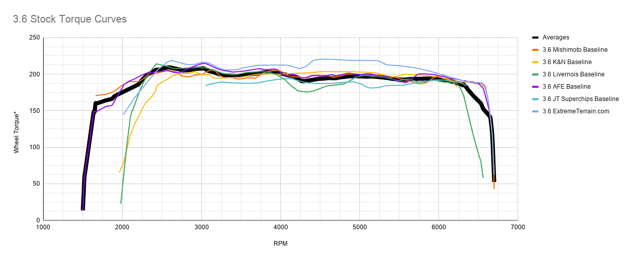

Think of all the compromises that are made in an ICE to provide a smooth, powerful torque curve from a bit over idle all the way to redline.
Powerful ? ! 😂 (Source 2020 thread) 😉Compilation for average torque
Exactly. It just needs to be sufficiently powerful at one relatively efficient RPM. The rest of the torque curve is irrelevant.
With the system going in other vehicles too they could maximize efficiency— profile a cam for a constant ~ 16-1800 rpm , TB and intake for low rpm velocity, high rpm flow not needed. Heads too, if if the redesign cost is worth it.
