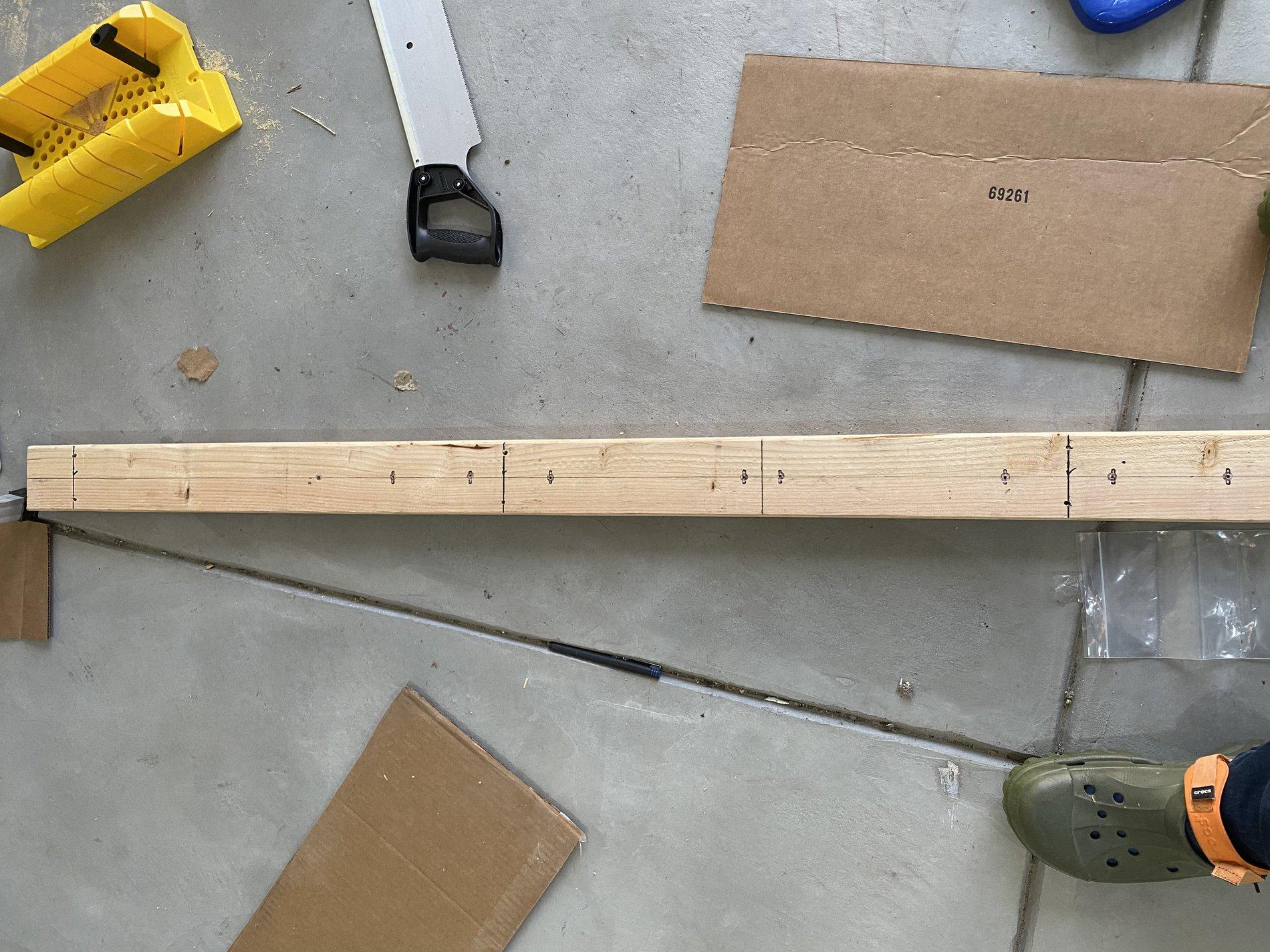

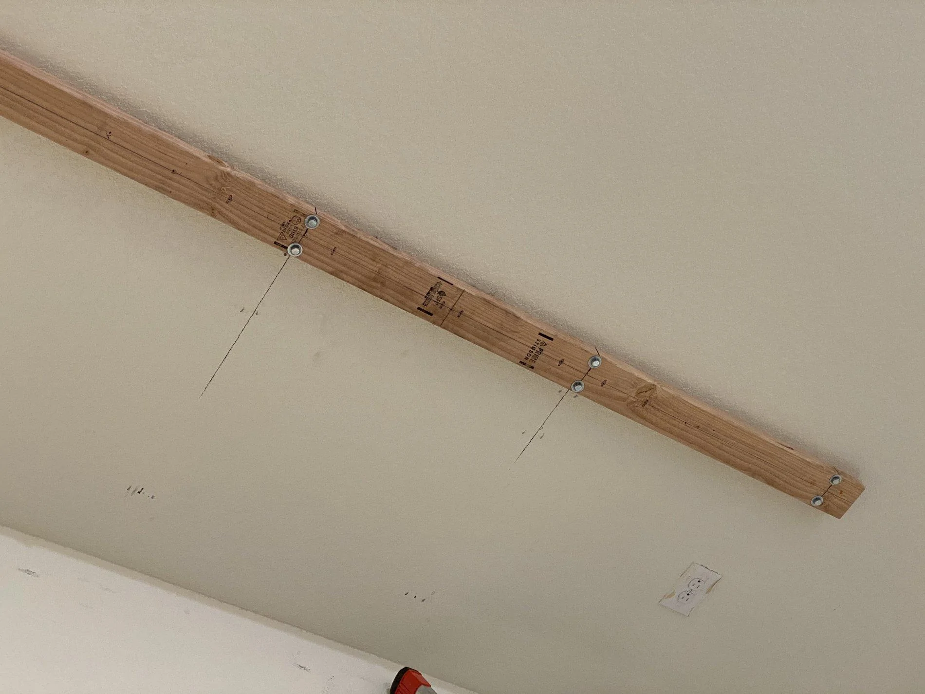

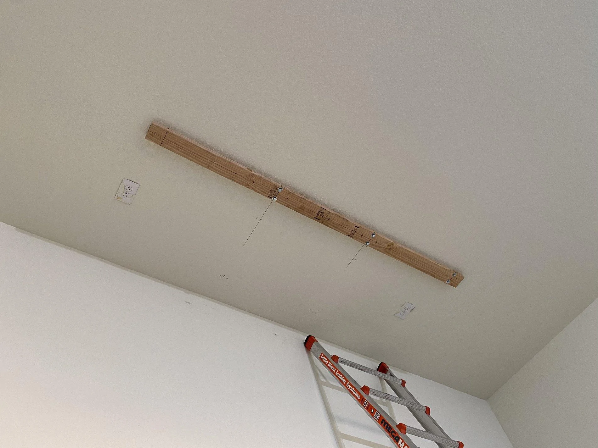

Just find the joists with a stud finder and surface mount some 2x4s across them.Probably. After some Googling it doesn't seem that zandov.com is reputable.

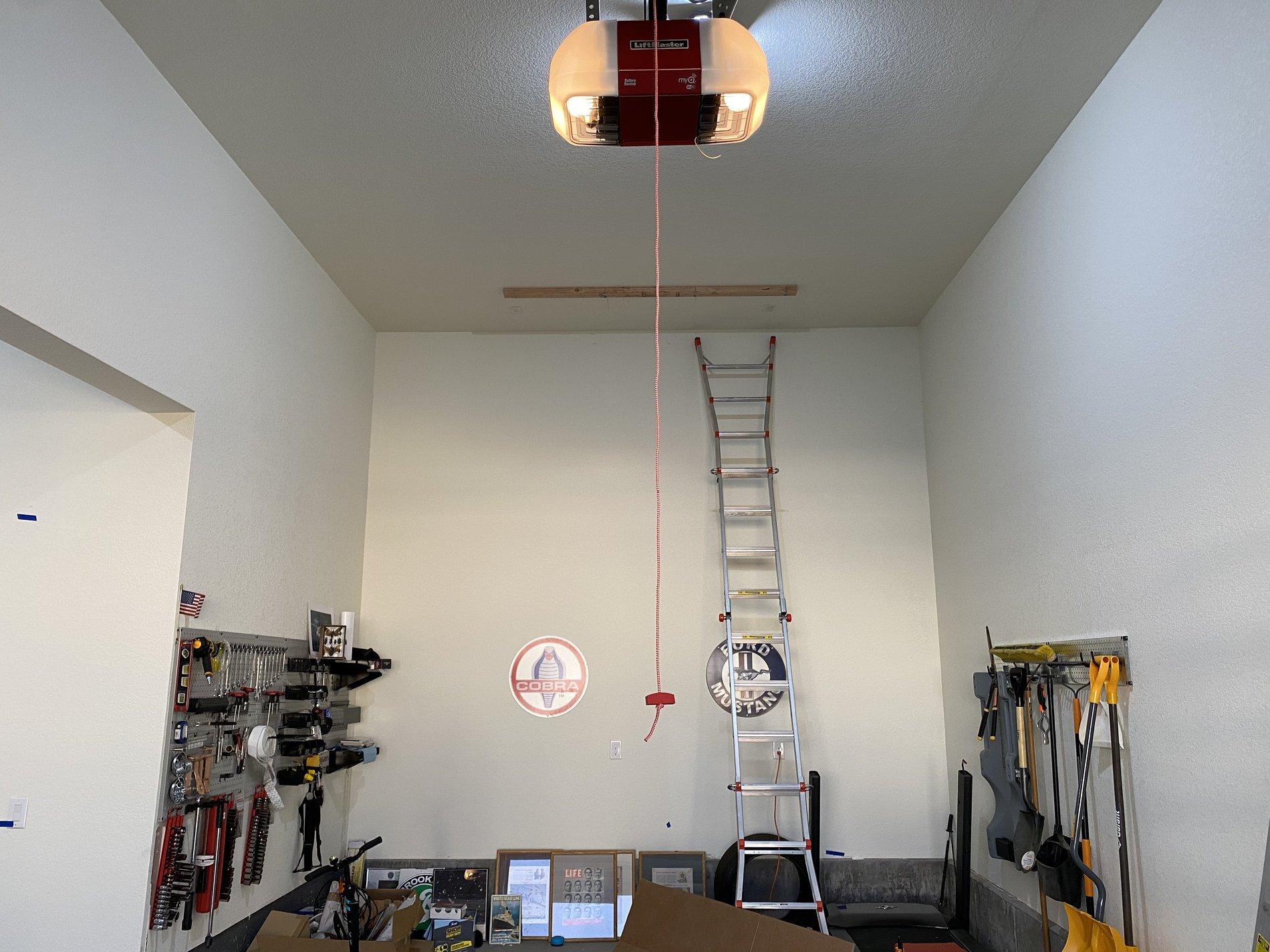

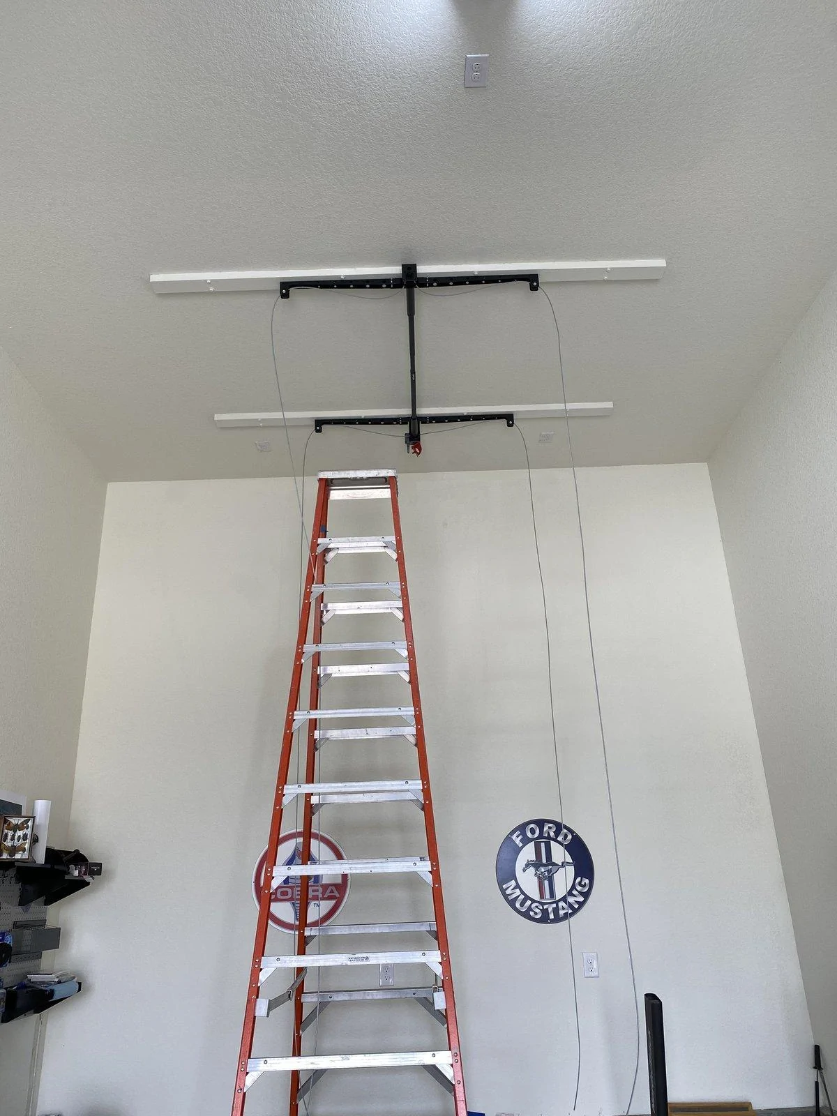

I plan to install this in my garage's large bay which is designed to fit an RV: 30 ft deep, 13 ft wide, and 16 ft high. Unfortunately, the joists run the long way and are 23" apart, so I think I'm going to need to either move the lift off-center or use some lumber between the joists and the lift. I'll also have to find a way to accommodate the ceiling height. I'm leaning towards simply using a longer length of steel cable and a fabricated handle extention. Any ideas are much appreciated.
The whole garage is now sheetrocked which is an added complication.
Sheetrock is easy to patchThe whole garage is now sheetrocked which is an added complication.

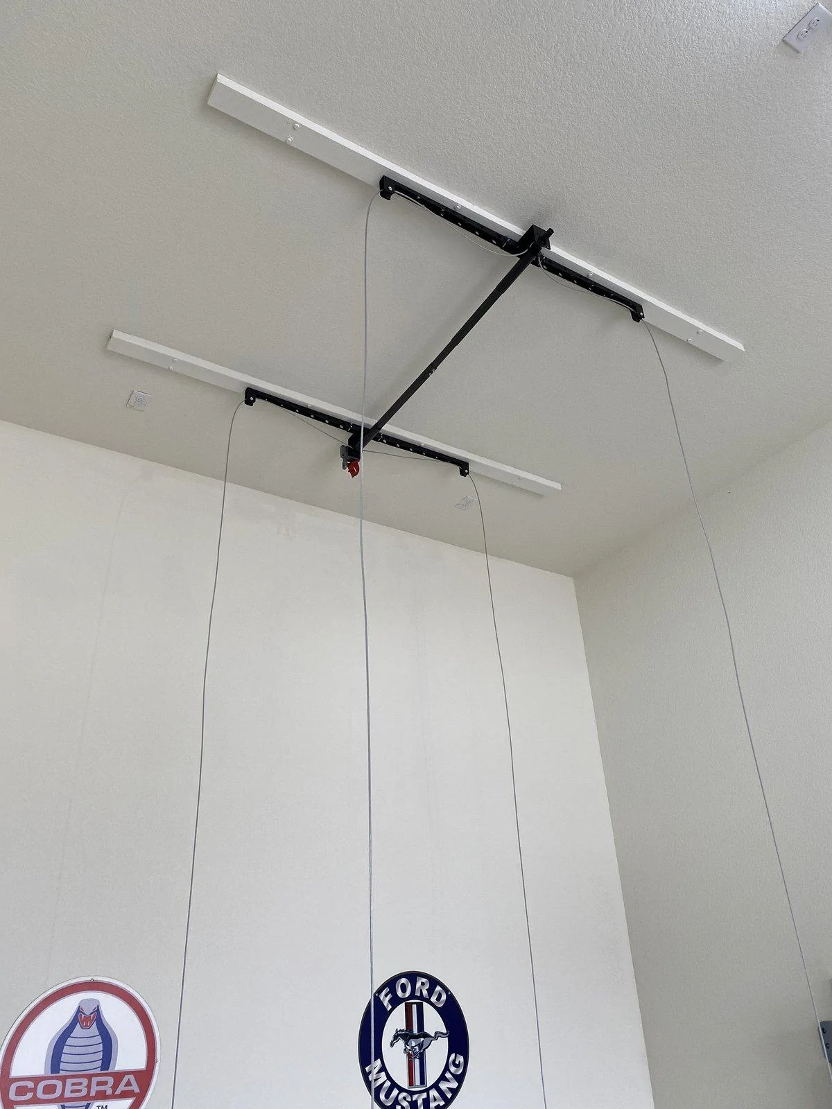

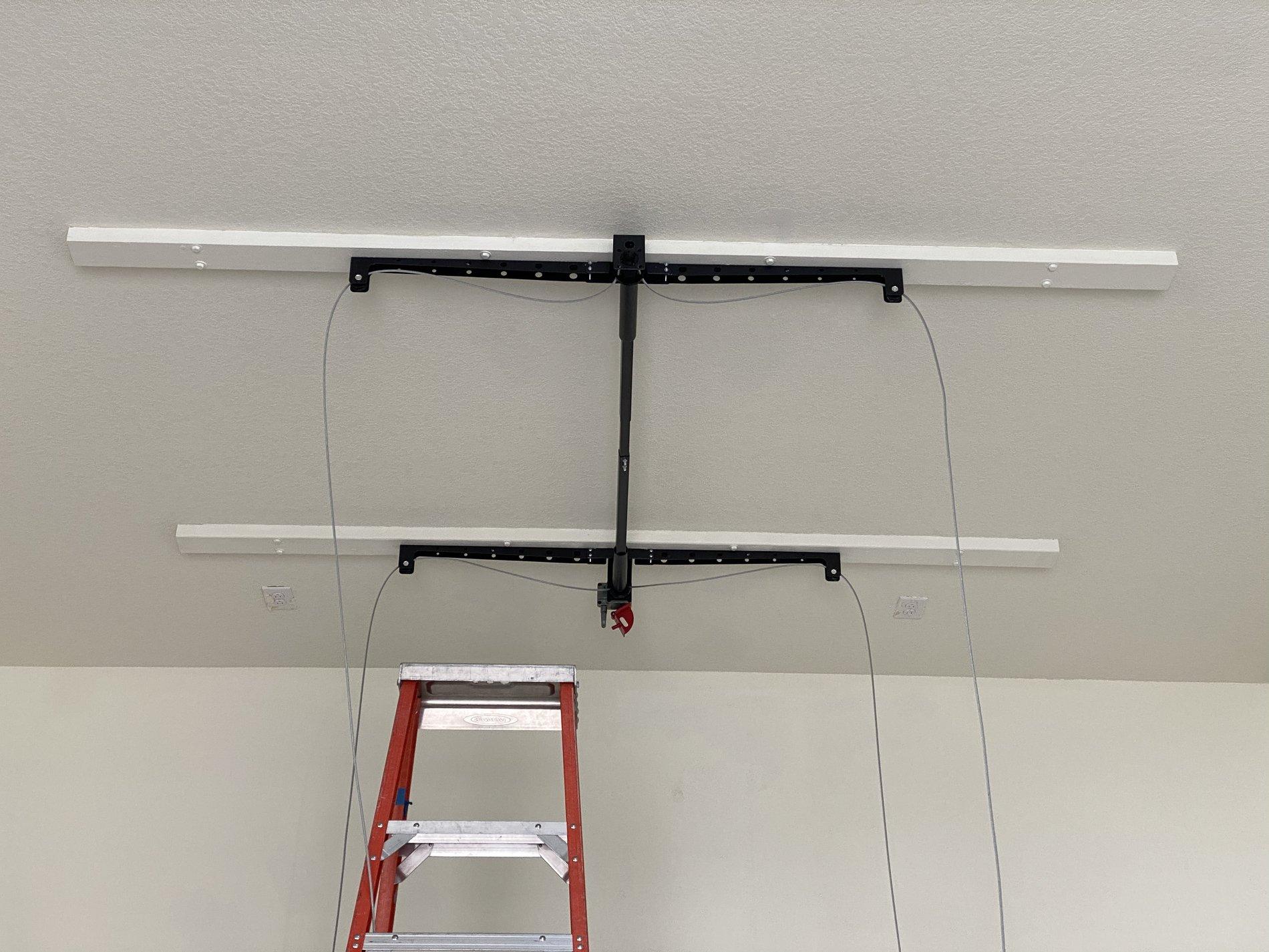

Pick up a sheet of 4'x8' 3/4" plywood. You can even buy a sheet of finished or birch plywood if you want a nicer finish. Use a stud finder to locate the joists. Center the plywood on your ceiling where you want the lift mounted. Screw and secure the sheet of plywood into the joists. I like Spex brand screws. Then center the lift on the plywood to wherever you want. Attach the lift with screws or anchors. Paint the plywood whatever your ceiling color is and your done.Probably. After some Googling it doesn't seem that zandov.com is reputable.
At that height I would choose a different hoist.Probably. After some Googling it doesn't seem that zandov.com is reputable.
