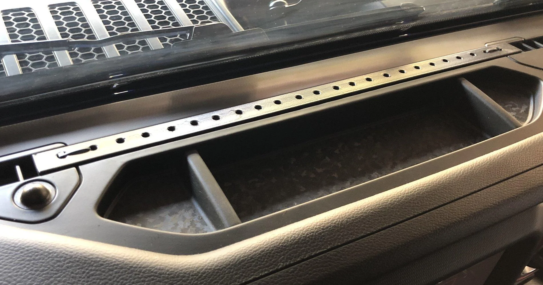

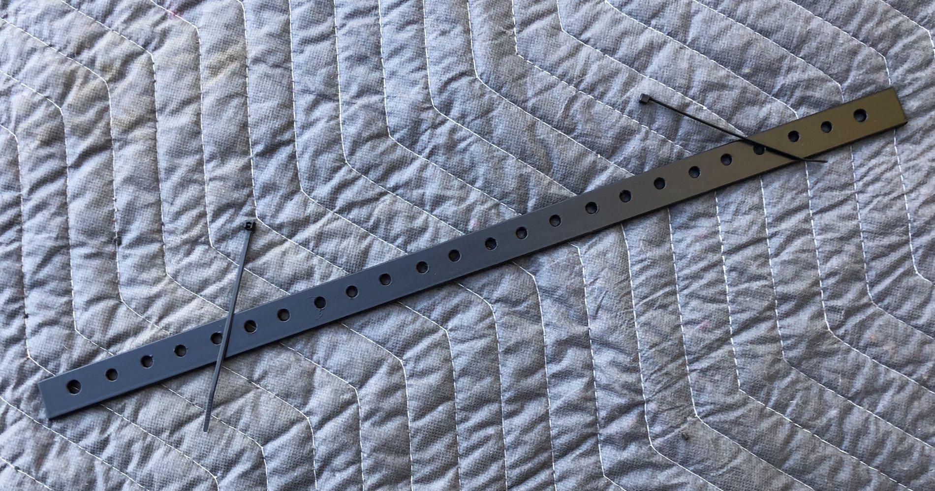

Finally got around to fixing my front defroster vent. Used 3/4” aluminum bar, drilled holes for each vent the size of the head of a mini zip tie, covered with black PlastiDip (trying to match the dash). Mini-zip tied on each side to existing vents, hoping that in case of an accident, the bar doesn’t go flying around. I embedded each zip tie head into a drilled hole to make it less visible/noticeable. I now have much more uniform air distribution.

what is the length of the bar and do you recall the actual size of the drillbit? I like the idea of still allowing airflow through most holes, instead of plugging a bunch of them. I need to build this before the snow really flies in Wisconsin.

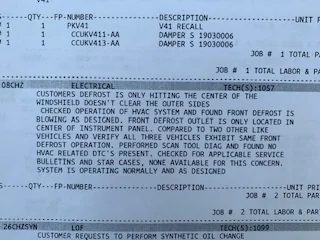

NHTSA filing
"Our high defrost setting only works on the center 12" of our jeep windshield. The 1/3 on both sides, driver side and passenger side are getting zero defrosting air. My brothers 2019 and hundreds of other 2018 and 2019 jeeps also have this problem according to blogs. The dealership stated that our defrost is working the same as other new jeeps on the lot and refused to acknowledge the dangerous design flaw. I have installed duct tape on the center portion of the defrost vent to redirect the air to the drivers and passengers side windshield. I plan to make a patial perminant block from plastic and install it today. We live in the Rocky Mountains and this jeep would be undrivable in the winter without defrost air flow aftermarket redirection. Zero defrost air hits the driver and passenger side without the aftermarket fix. Jeep owners are in real danger if their windsheild fogs up. We turned on our defrost to high heat and airflow to remove ice from an ice storm a few days ago. Only the center 12-14" were melted. "
Below is the dealer excuse.

thanks for the share, wow what crap. guess modifying with metal/plastic with holes drilled, or with plastic plugs is the fix.....

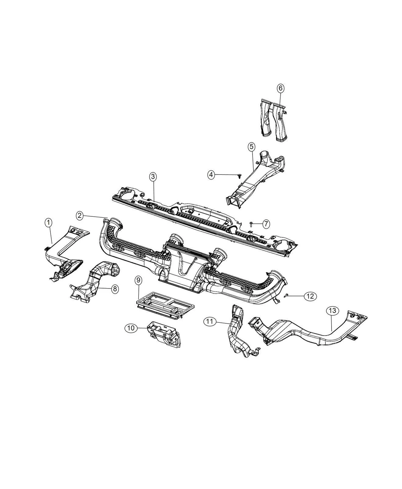

The Wrangler JL dash parts
Look at the design of the defrost plenum (#3) and duct work (#2). Hot air enters the plenum in the center. There is almost zero resistance for air to escape the center of the plenum, but it has to go through a narrow plenum to get to the left/right sides. So I guess the dealer is correct, it's operating as designed, but it's a bad design. If you want equal air flow from all of the plenum vents, they have to have equal resistance to air flow.

I took mine to the dealer last winter and got the same reply as Duglas.
Tried the plastic hole blockers but the air just passes up and around them. Hard to imagine that we buy a new jeep and have to figure a mod in order to drive it in the winter.
