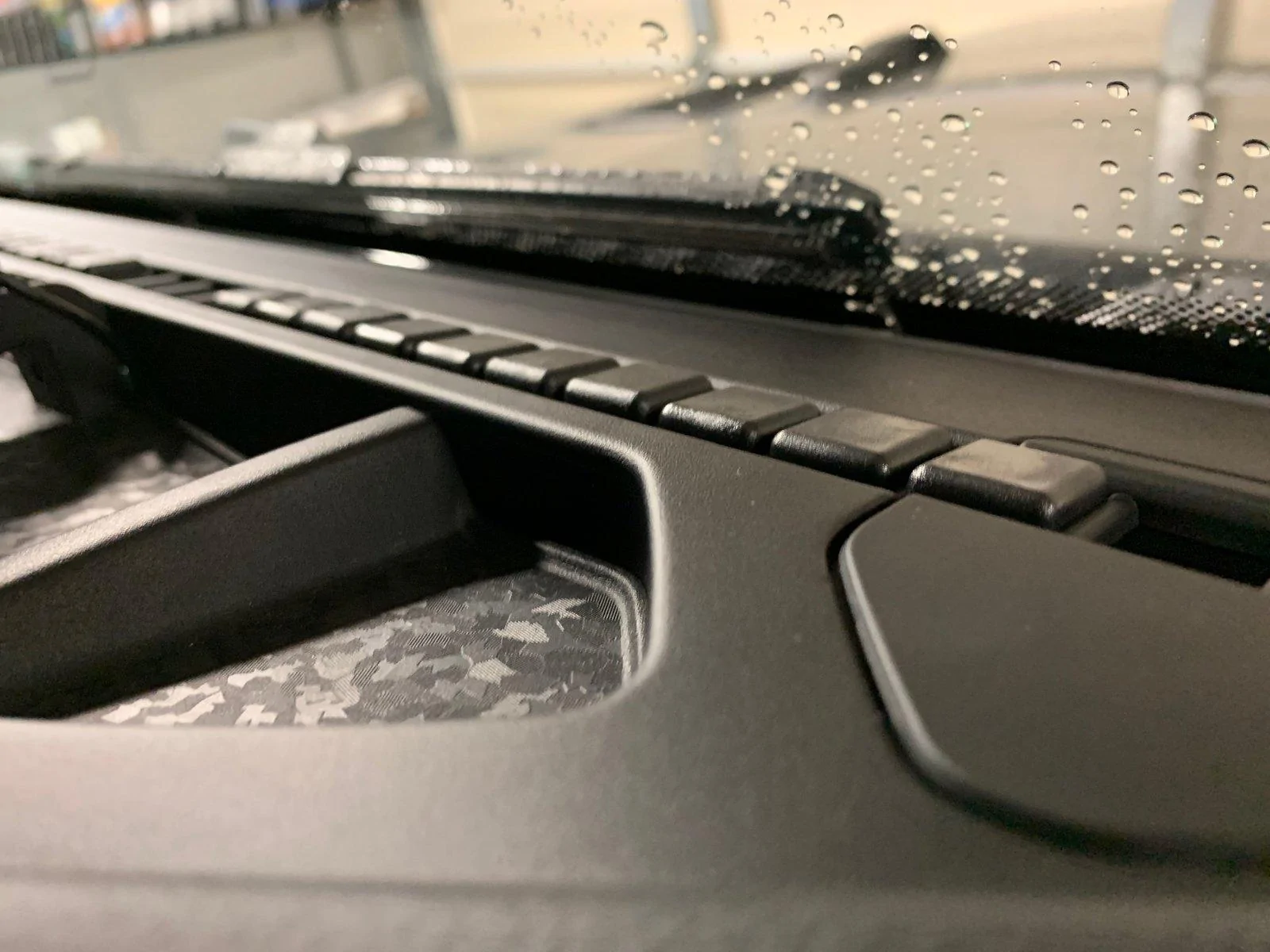

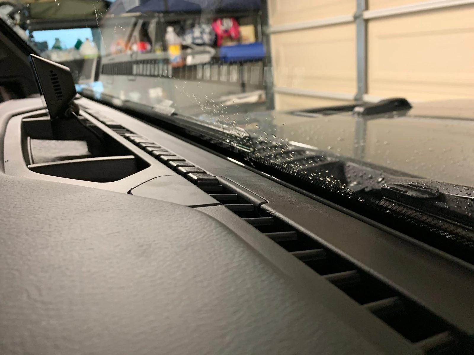

So they arrived today, put in 20 of them leaving the 4 center vents open, seems to be good airflow on the sides now, also where the plugs are a little bit of air can still escape so it allows air out in those areas to defrost still, going to try this out and possibly try every/other, etc.
the eBay ones look WAY nicer than the Amazon ones, they match the dash plastic almost exactly

Happy to hear it! I ordered the eBay ones as well. Are the difficult to remove, or do they rattle at all? Keep us posted. Mine have not arrived yet.

they're not easy to remove but not too difficult, they won't come out on their own, they dont rattle, but they dont all sit perfectly straight, if you want them to stay straight a dab of hot glue or something would fix it

I received my 12 plugs from that eBAY vendor today. Geeeez, they match up nice with the plastic on the JL.
I just ordered 12 more.. 8-)
The plugs fit tight and are easily removed as needed.
The plugs do not fly out or rattle, etc. when defrost is on Max.
They fit pretty snugly... I had two that wanted to wiggle a tiny bit, with Max air, so I neatly put two turns of black electrical tape over the frills and pushed them back in .....that cinched them right up.
