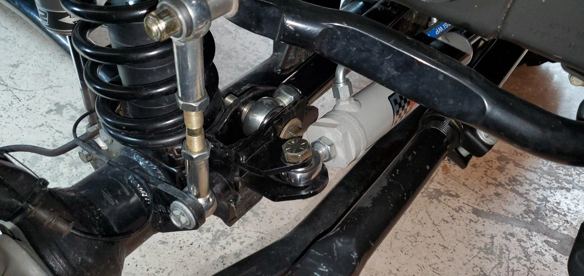

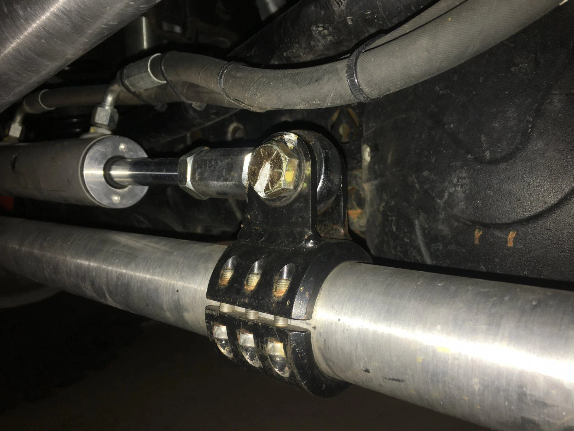

I'm currently running a stock Dana 44 on my 2018 JLUR with all Steer Smarts components and a Rock Krawler 3.5" lift. I had to get creative with my mounting. I was originally using my steering damper's bracket, but that quickly broke during my first wheeling trip with it installed. I swapped out the trackbar mounting bolt for a longer grade 8 version to mount the ram to the axle, then used the supplied clamp to the tie rod.
I want to run a double shear setup and weld tabs to the trackbar and then get a different diff cover and mount the ram to that. How did you mount your ram? Any other suggestions?
Here is the before pic:
Jeep Wrangler JL PSC Big Bore Steering Upgrade IMG_2309
And the after:

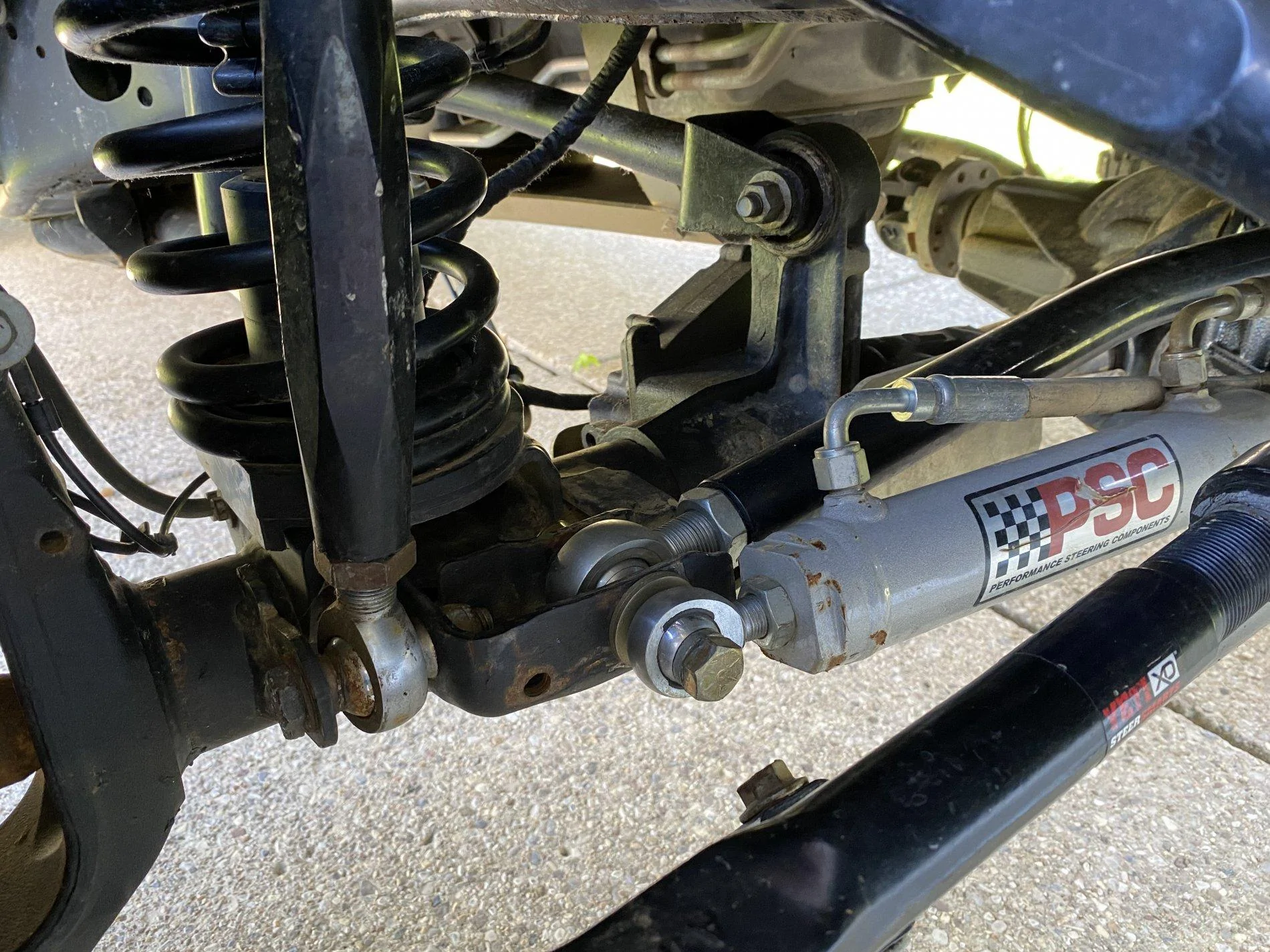

I made my own bracket that bolts through the track bar bracket and is welded all the way around. I had to rotate the ram fittings back towards the axle tube to stay away from the frame at full compression.
Jeep Wrangler JL PSC Big Bore Steering Upgrade 20201215_144501

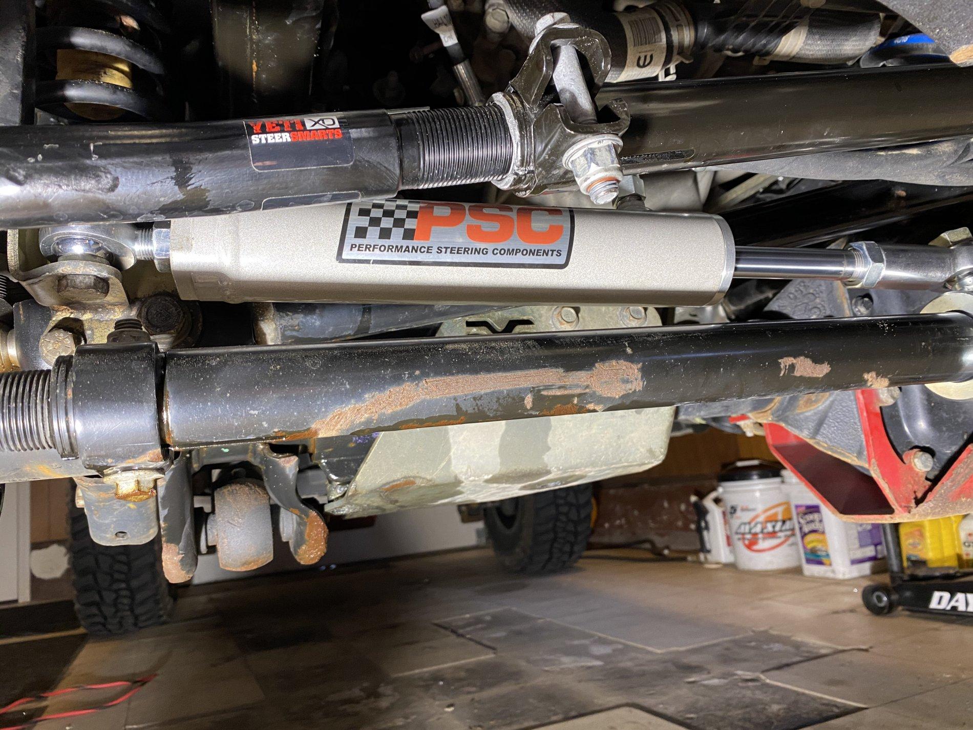

I like that bracket idea. That looks really good. I'm still wanting double shear on the tie rod attachment and I want it closer to the tie rod end. Something to this effect. Pardon the sketch.
Jeep Wrangler JL PSC Big Bore Steering Upgrade IMG_4533
