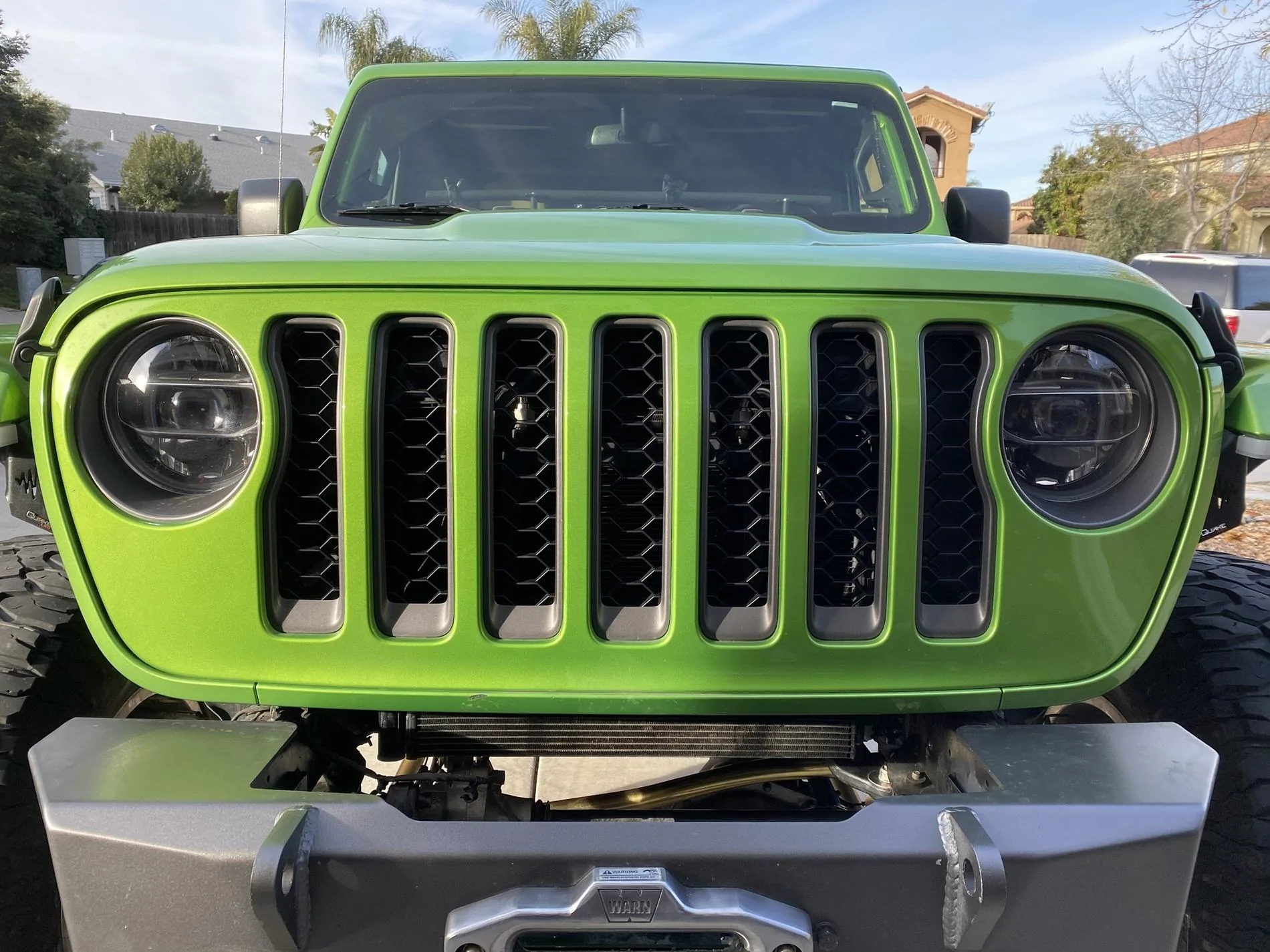

New Gladiator Grille inserts. I also painted the shiny PS cooler brackets black to make it a little less noticeable.

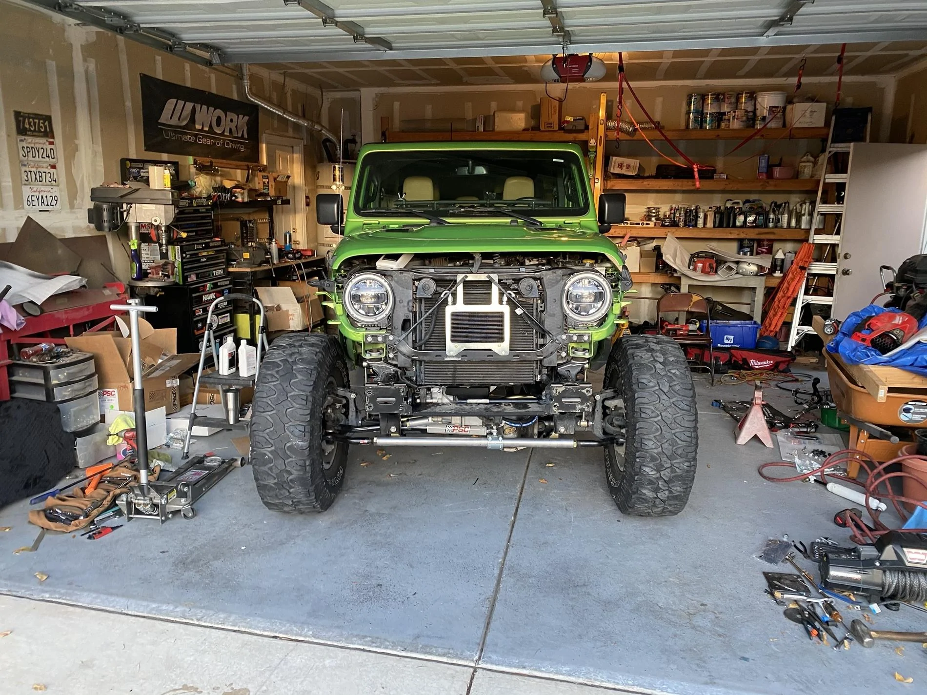

Since my winch was tight against the grille i opted to remove everything from bumper/grille/fenders/liners to make accessing everything easier

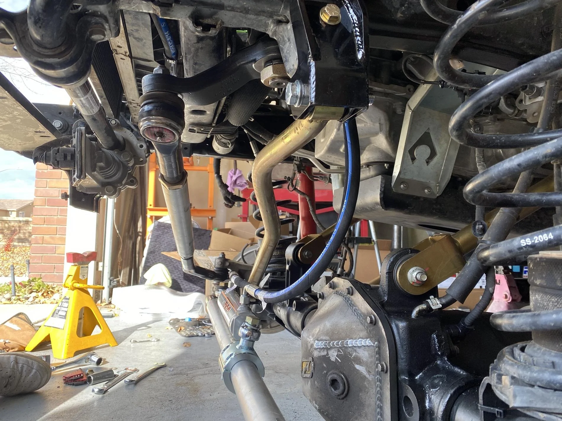

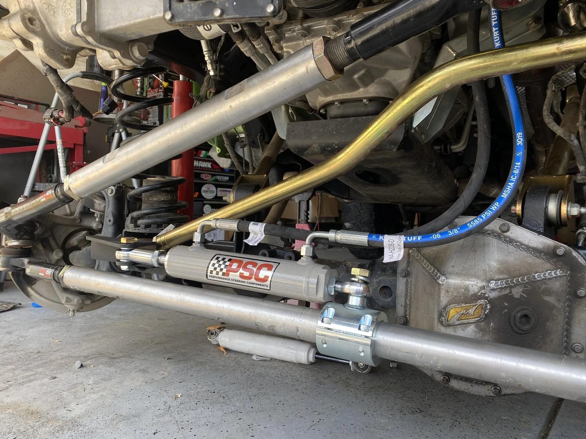

I spent hours cycling steering and suspension to make sure nothing binded with each other. As you can see, the next venture motorsports bracket attaches to the sway bar and tie rod bolt on the passenger side
Rusty's track bar brace can be seen here

5. PSC has markings for the hydro assist hoses with D and P with arrows pointing to each port. I installed it as per the instructions however for my application, the Driver port was used on the passender side and vice versa.
6.Bleeding was not too bad although i am still in the process of bleeding and topping off the reservoir. Removing the driver side line of the PS cooler and filling it up helped the bleeding process.
