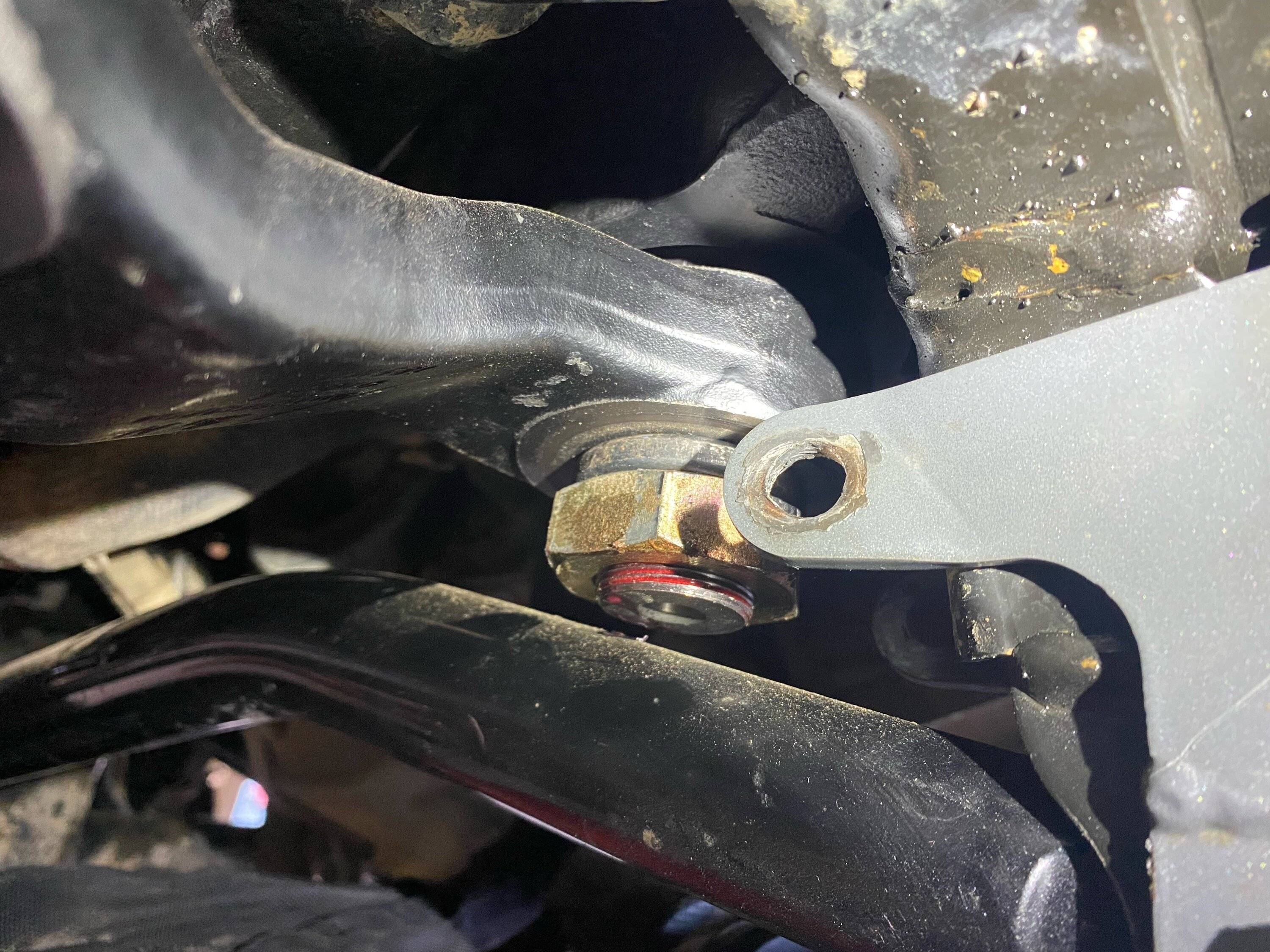

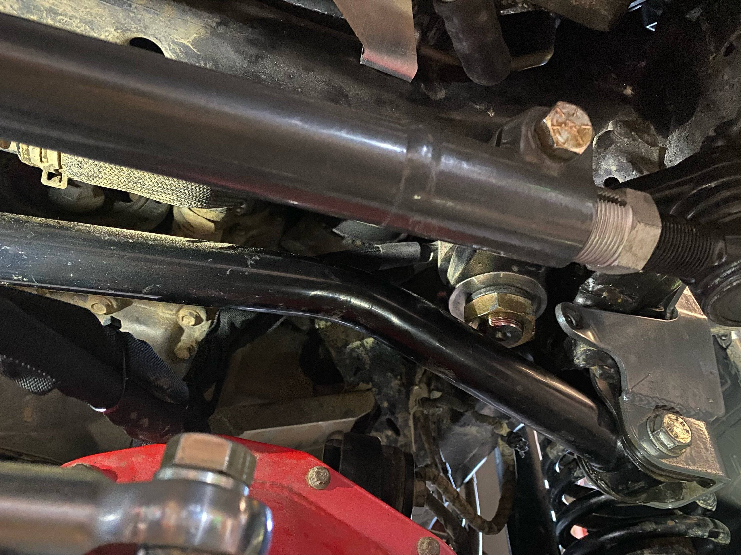

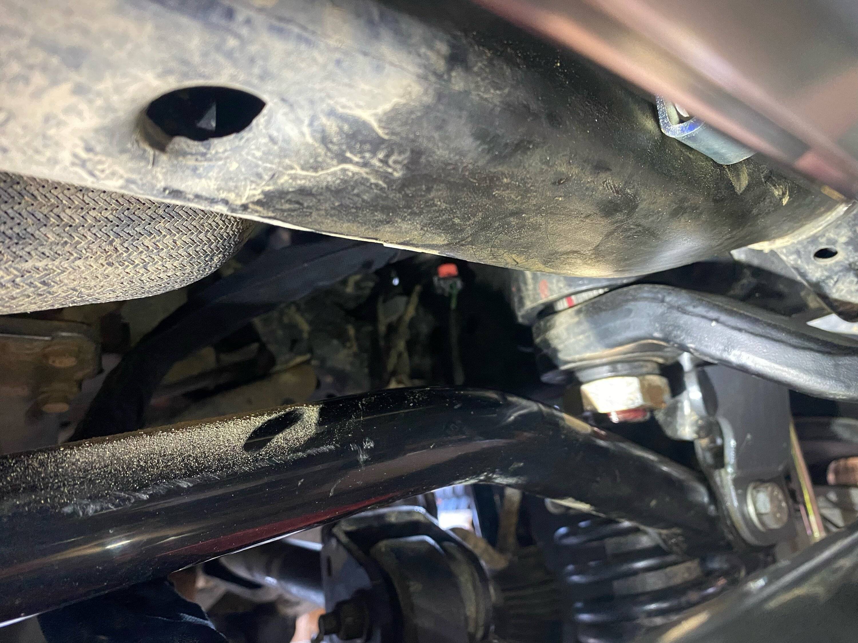

Has anyone done a draglink flip with the PSC setup? I’m running into issue with my Rusty’s trackbar pushing up into the large steering box. Have Synergy brackets on both ends.

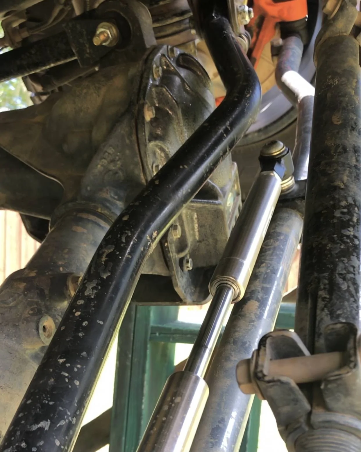

I think I’d sell the Rustys tb, and get the RK tb.
the bend on the RK is more horizontal than vertical………
Agreed. RK is still stupid close and needs to be clearanced.
