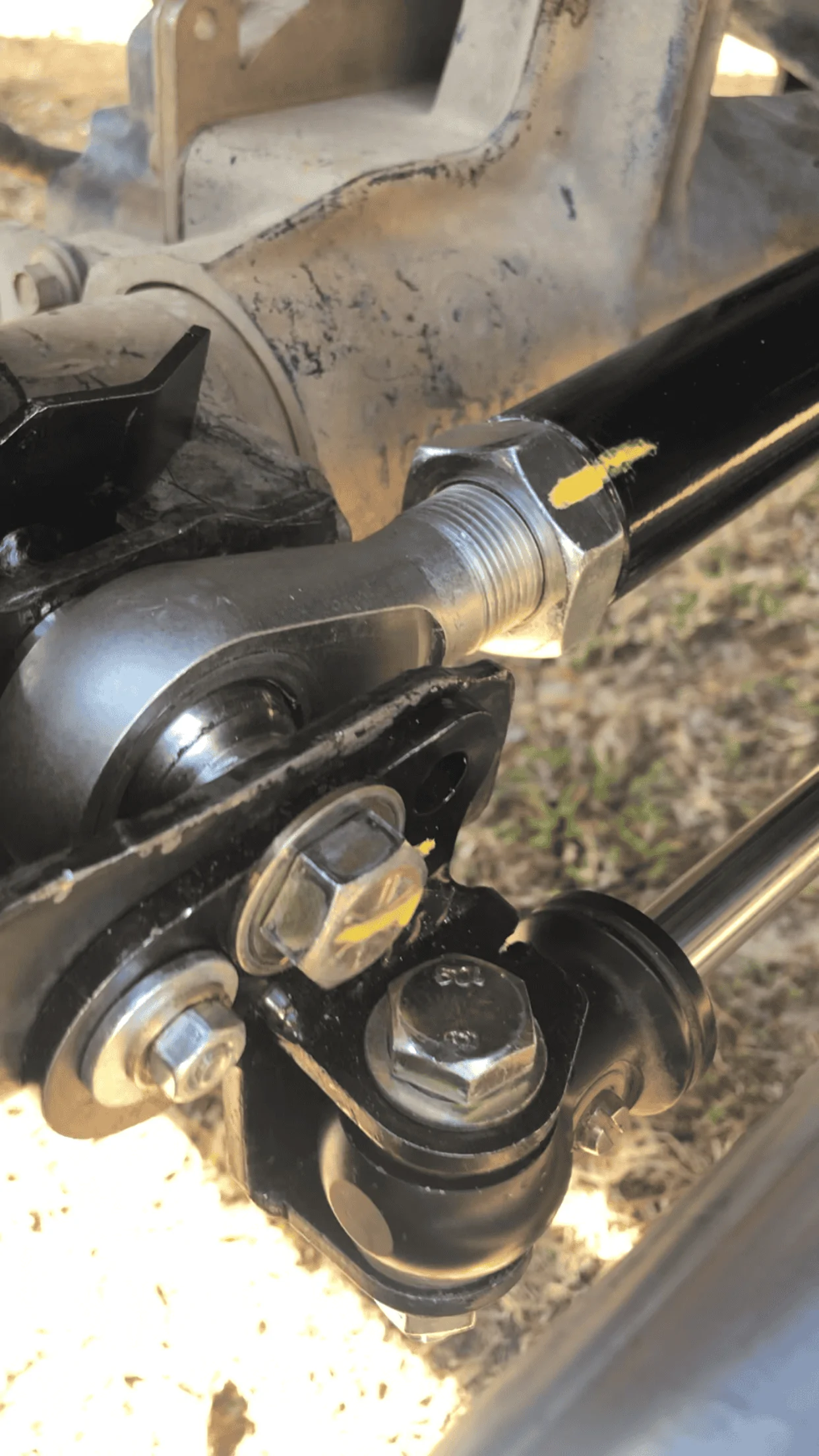

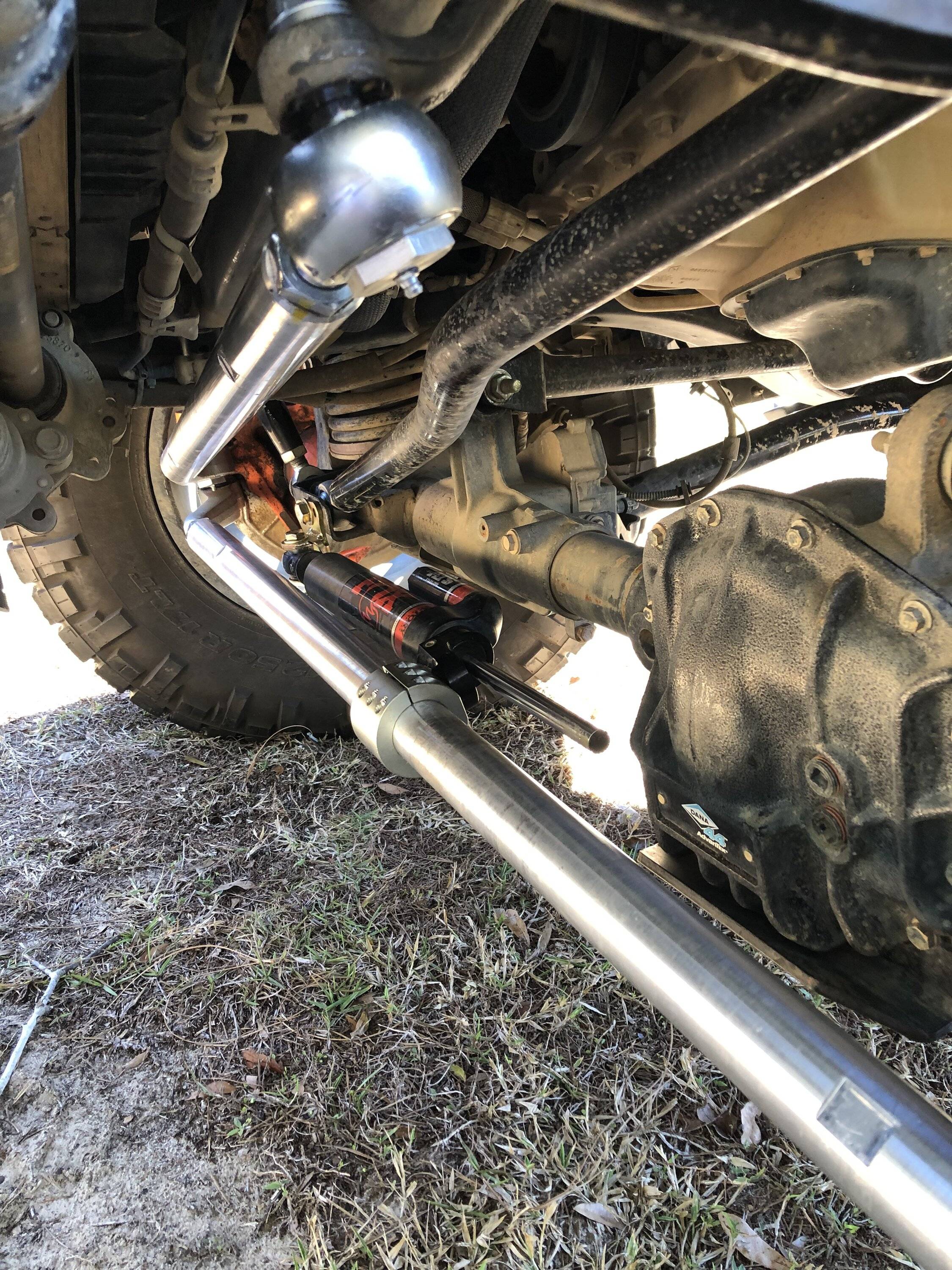

I’m running RK pro x steering, and there’s no axle side stabilizer bracket that will work…. I’m not running PSC, but I am running my stabilizer relocated to the tie rod…..I had to modify the MC axle side bracket to make it work…..

Yes, they were designed to run with stabilizer in the factory location, or with flipped drag link…The bars are pretty sweet, and their short compact ends that make them stronger, also tightens up the space down there…….I turned a MC bracket upside down and modified it…… it’s working great so far…..

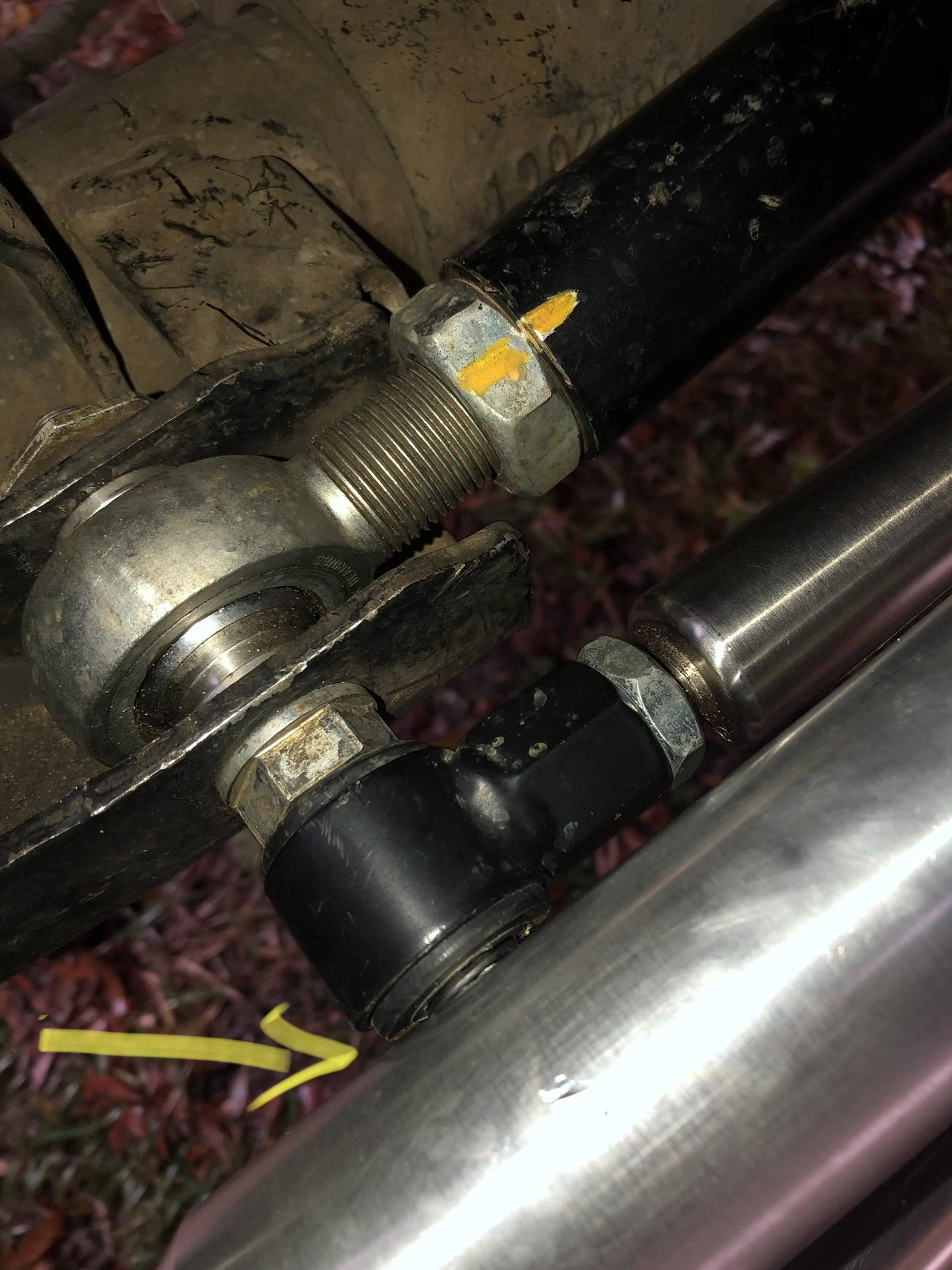

Yes, it’s because of the ends …. The other company’s are longer with more of a radius that separates them more creating more space……. You can see how close the bars are in this pic……another sweet perk, it costs 20.00 ish to rebuild them……

Thanks…. Yeah, actually hitting the drag link….there’s just not enough room between them when you turn to lock … I tried Synergy bolt, Clayton, Yeti, Rock Jock and MC (conventionally) they all hit……
