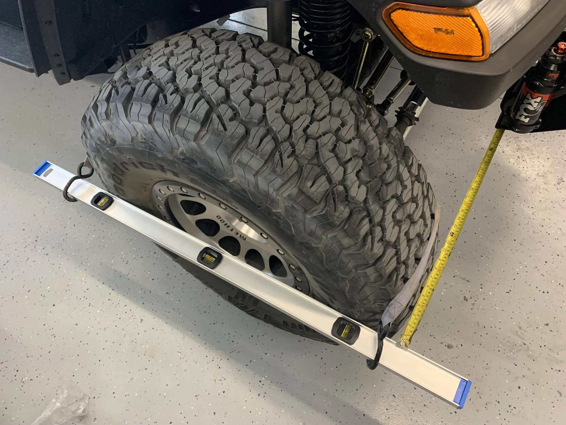

Roky nailed it. Only thing that can be adjusted on yours is toe. You can do at least as good as most shops. I can show some pics if you need them. I use two cheap 4 ‘ levels.

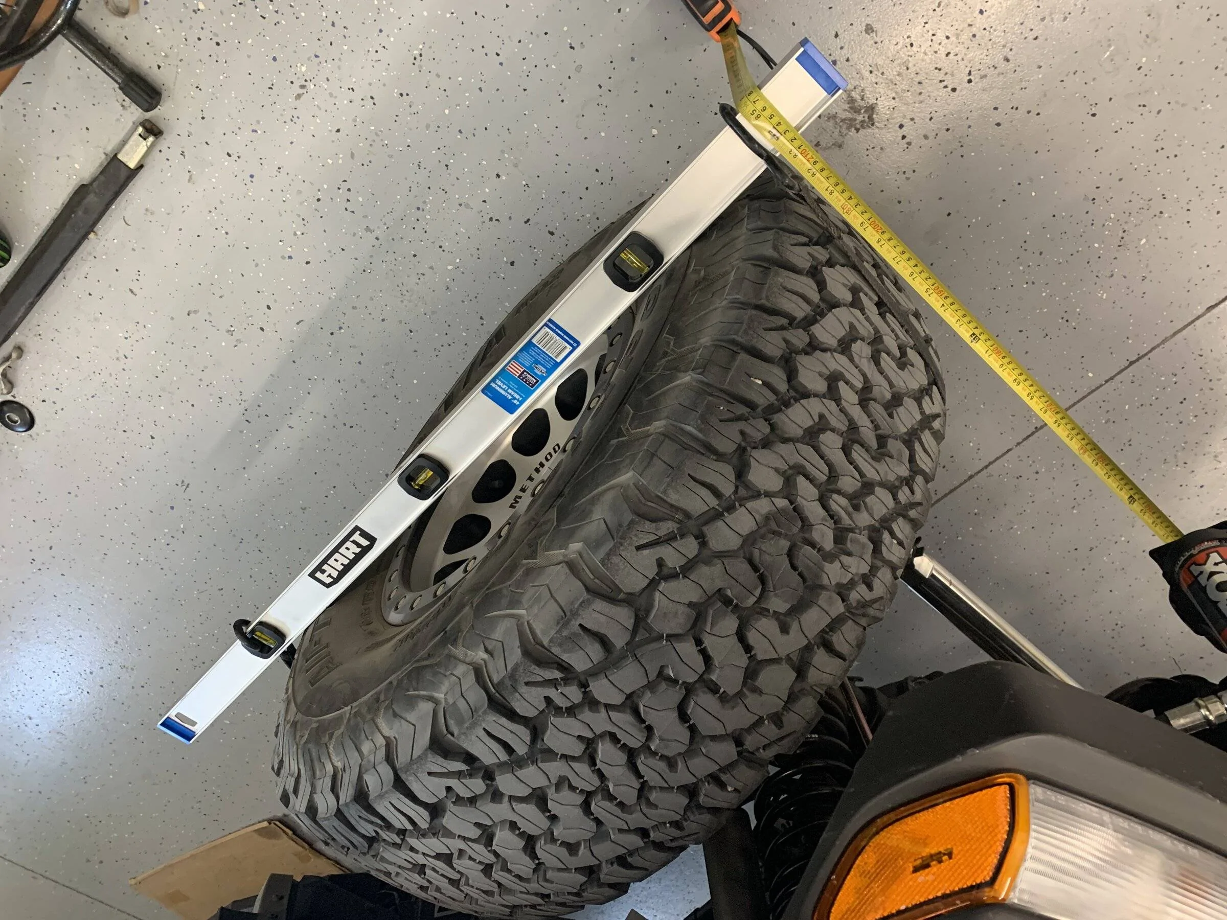

This is good timing. Just installed some Apex and Steer smart stuff and was doing alignment.
I use cheap 4' levels and cheap angle finder. Lowes, Homedepot, Harbor Freight and even Walmart sometimes have this stuff.

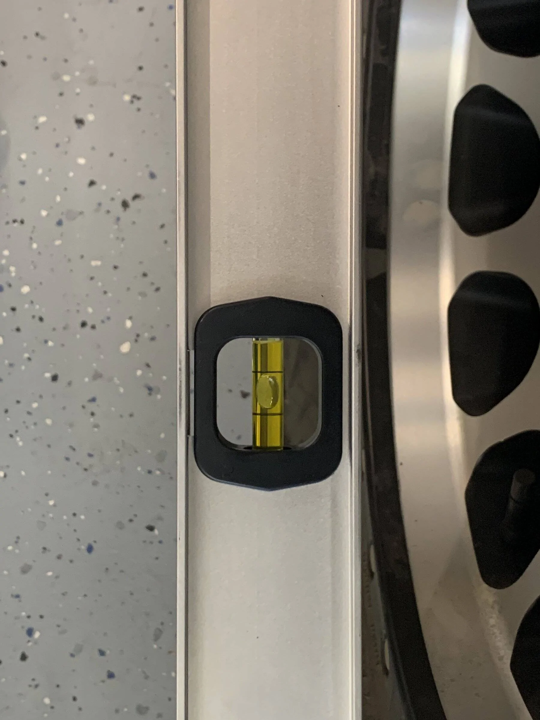

I set tire pressure and make sure I am on a level surface to start.
I use bungee or motorcycle ties for levels.
Measure your tire height and divide by 2.
For me it is just under 18"
That is your level center line.
My level is set to that number front and back and level.

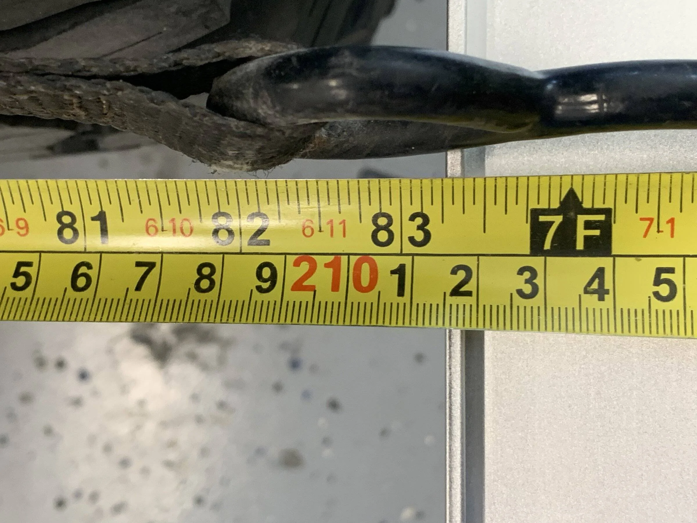

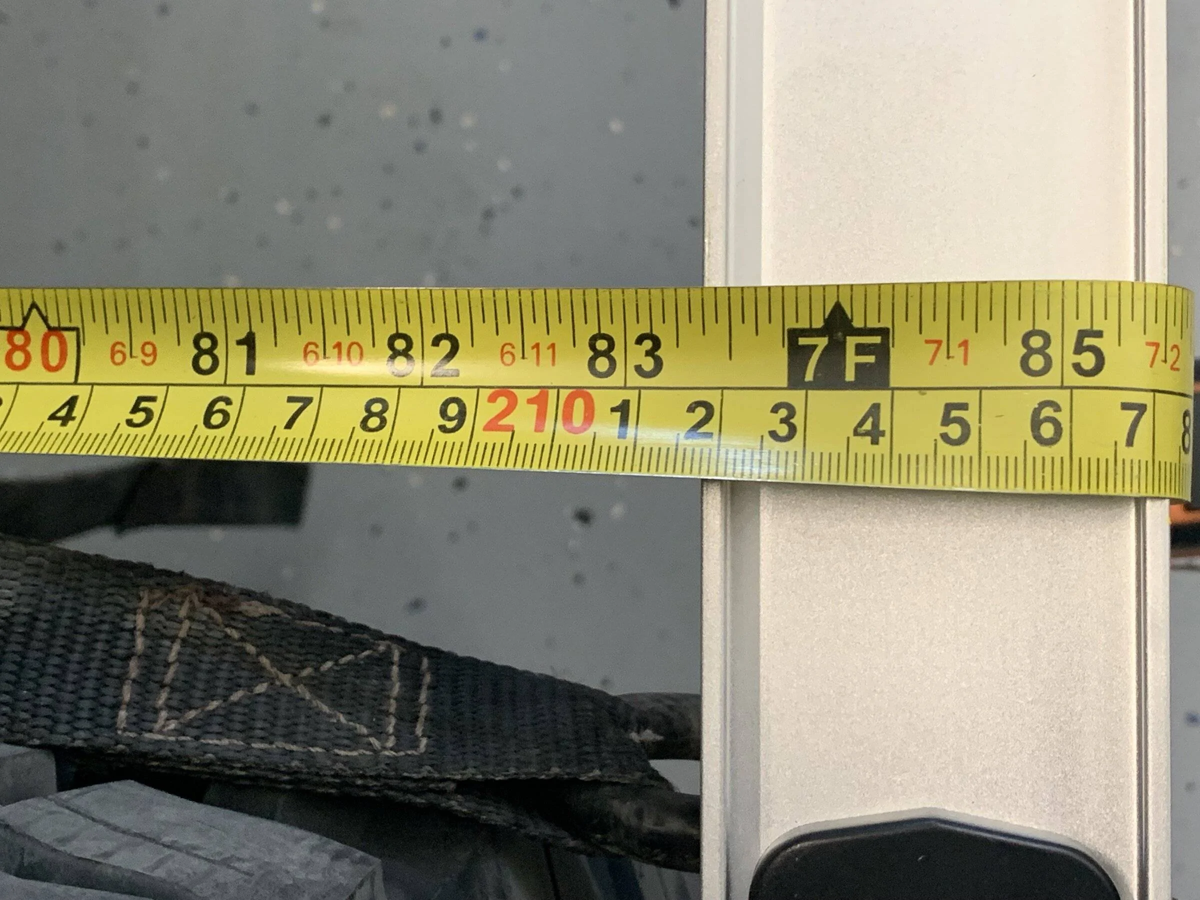

Now measure the front and rear.
Rear should be 1/8 more than front. 1/8 just seems to work around here for me. You can experiment 1/16 one way or the other.

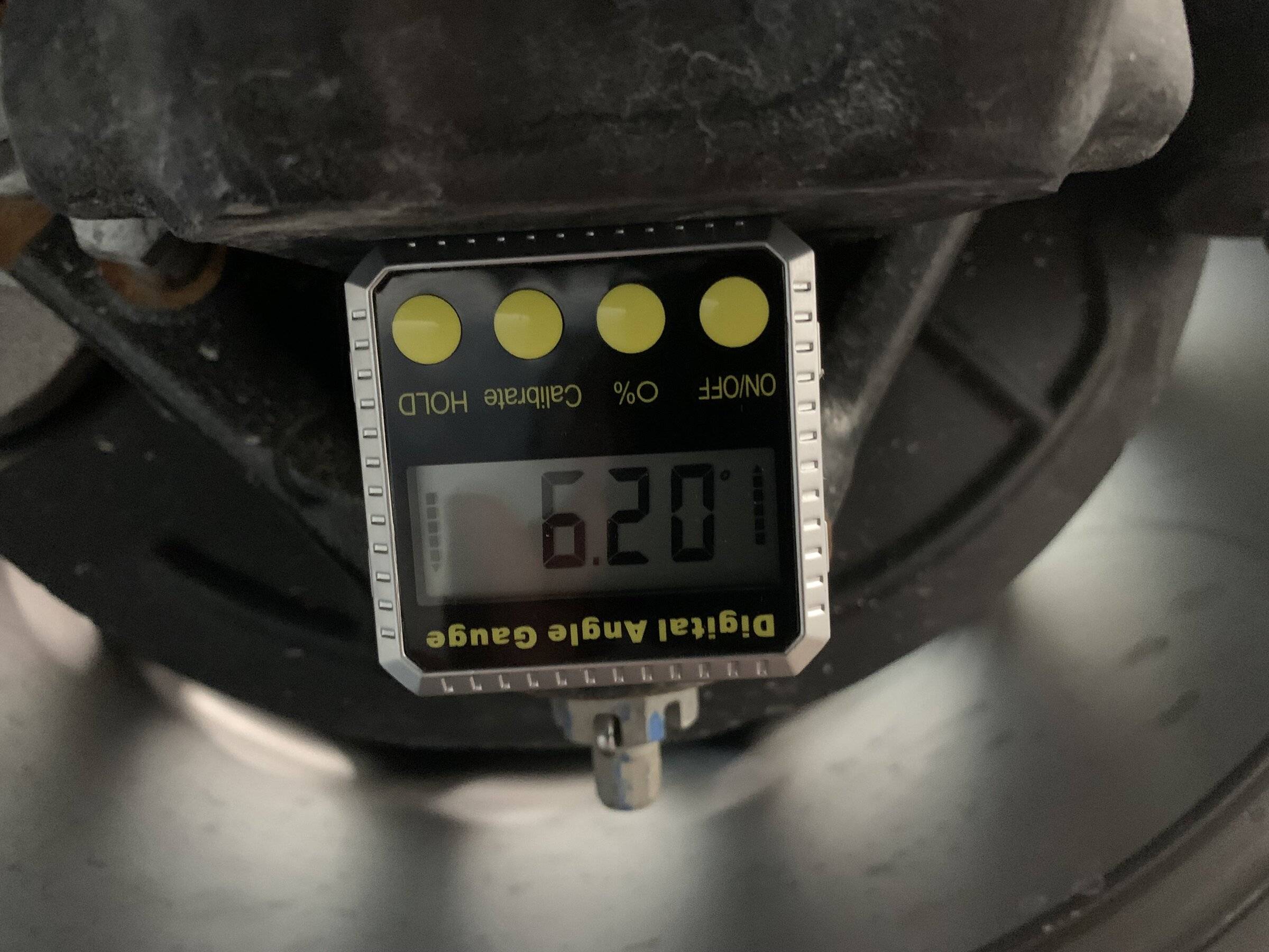

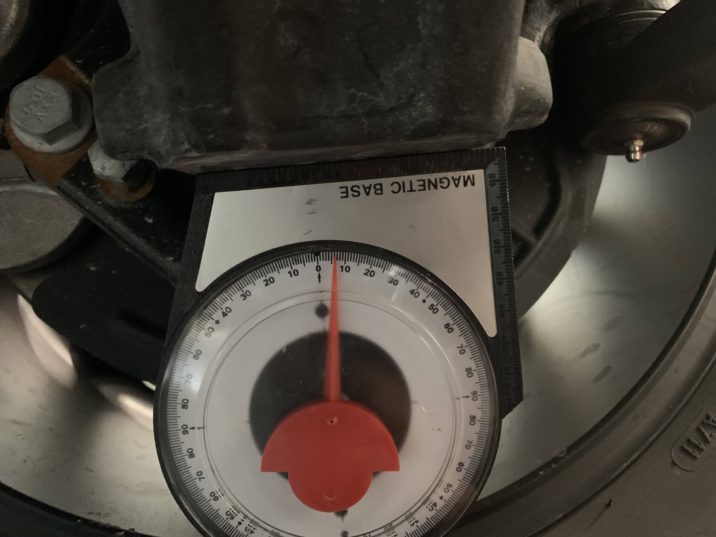

Using a cheap angle finder for caster is very easy also. Comes very close. I also have a digital angle finder I use but you need to be very precise with placement. They are very sensitive. Just have to measure off rotor, square everything and scribe a line on housing to line up with.
