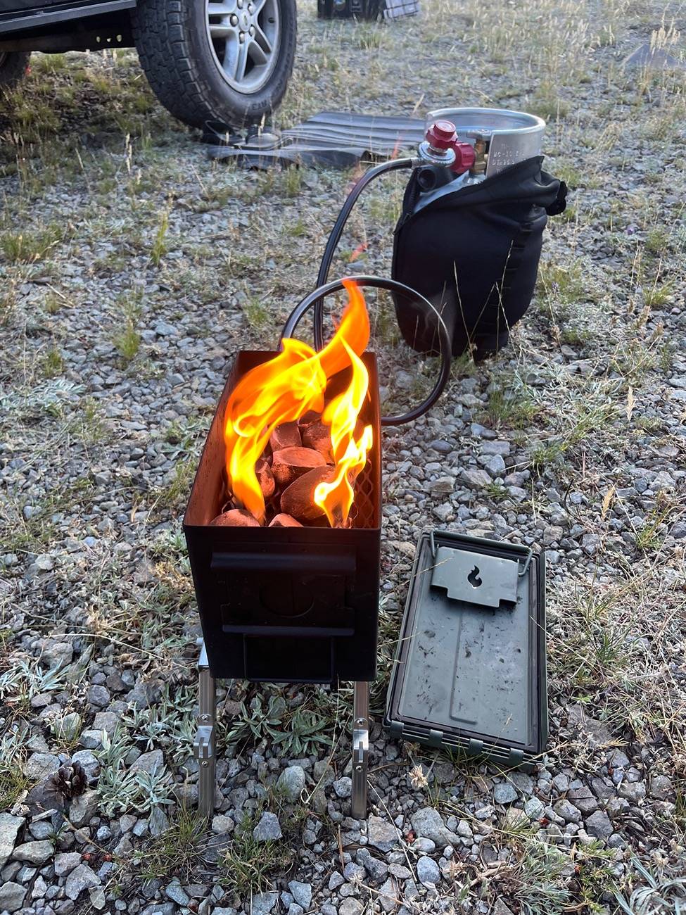

Well here are the results of the brand new Lavabox they sent me. Same issue as the first box. I set the level and after 10 minutes there's barely a flame. Looks like both of these boxes are getting returned. Such a bummer.

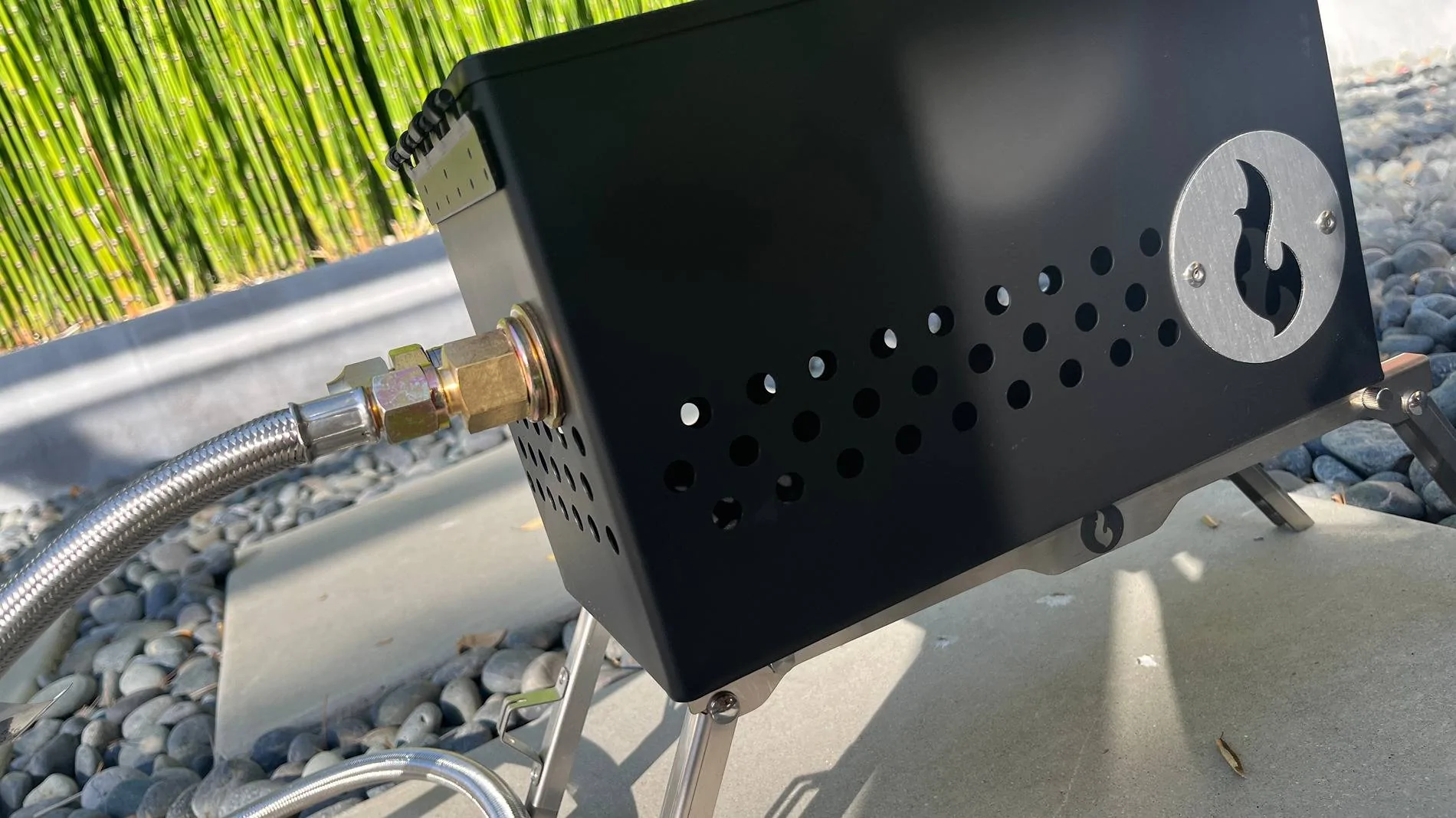

Here are some pics:
There are holes on all sides below the burner. Science wise it makes sense. The flame is getting starved out. I just don't know how to make that not happen.

That should be more than enough air intake… maybe it’s not making a good chimney to start sucking in air. Just guessing here. Thermo-fluid dynamics are not my speciality. Any way to take the burner out if the box and see if the same thing happens (just sitting on your grill or something)? I also understand if you’re just done with trying to get it to work.

Well I gave it one last ditch effort. The owner of Lavabox was willing to jump onto a video call to see if there was something I was doing wrong in the process of lighting the box. I ended up just making videos to send to him and we corresponded via email. I did 3 tests. The first 2 were with my Ignik propane tank and using different regulators each time.
That showed it was not the regulator so he asked me to try a different propane tank thinking it had to be the tank that was faulty. I then hooked up my larger BBQ grill tank and got same results. Flame dead after 10 minutes.
So not regulator, not tank, has to be air flow of the box to me. He said he has never seen this before on their boxes and was very apologetic. They will be sending me a return label and giving me a refund.
