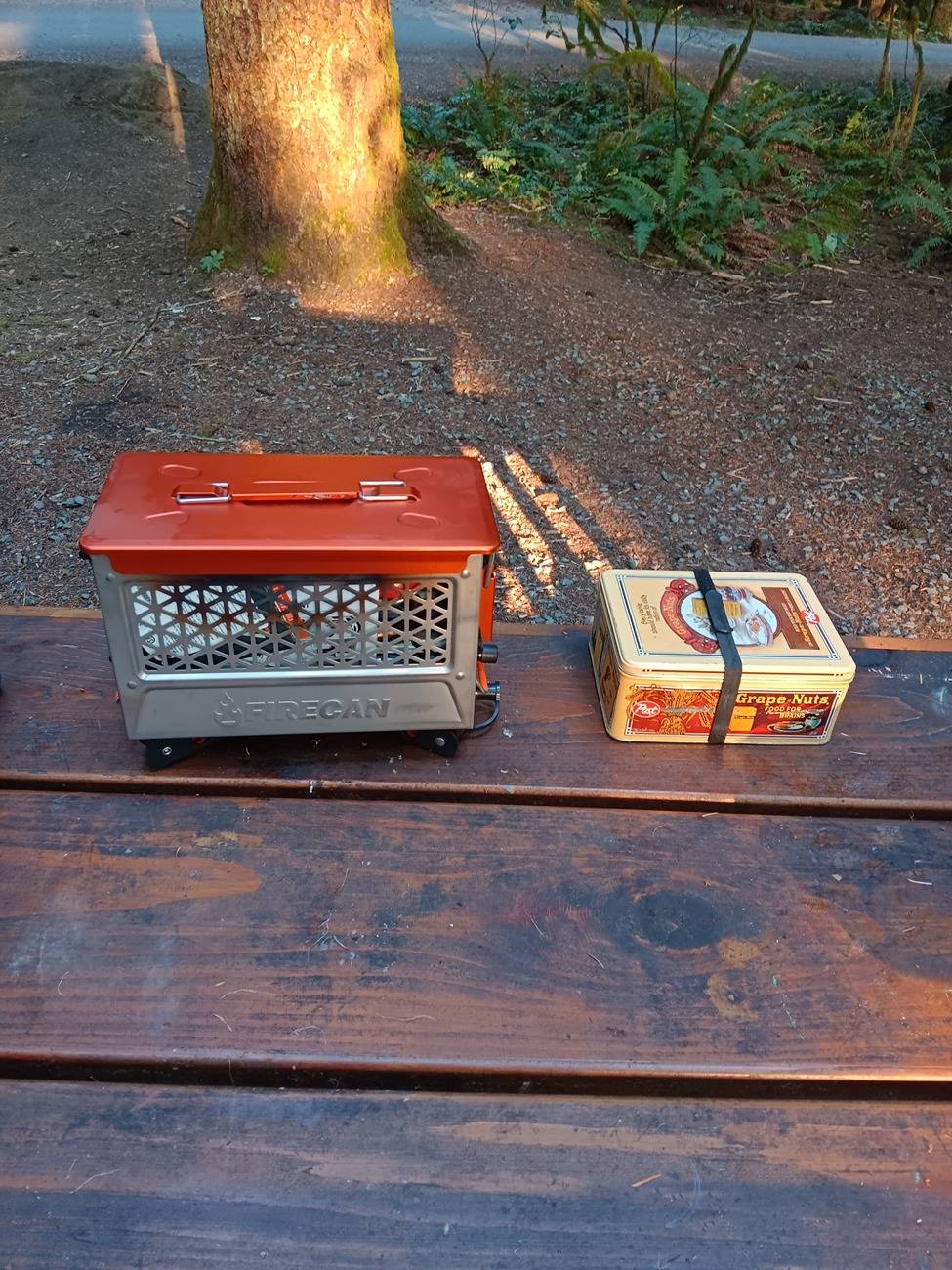

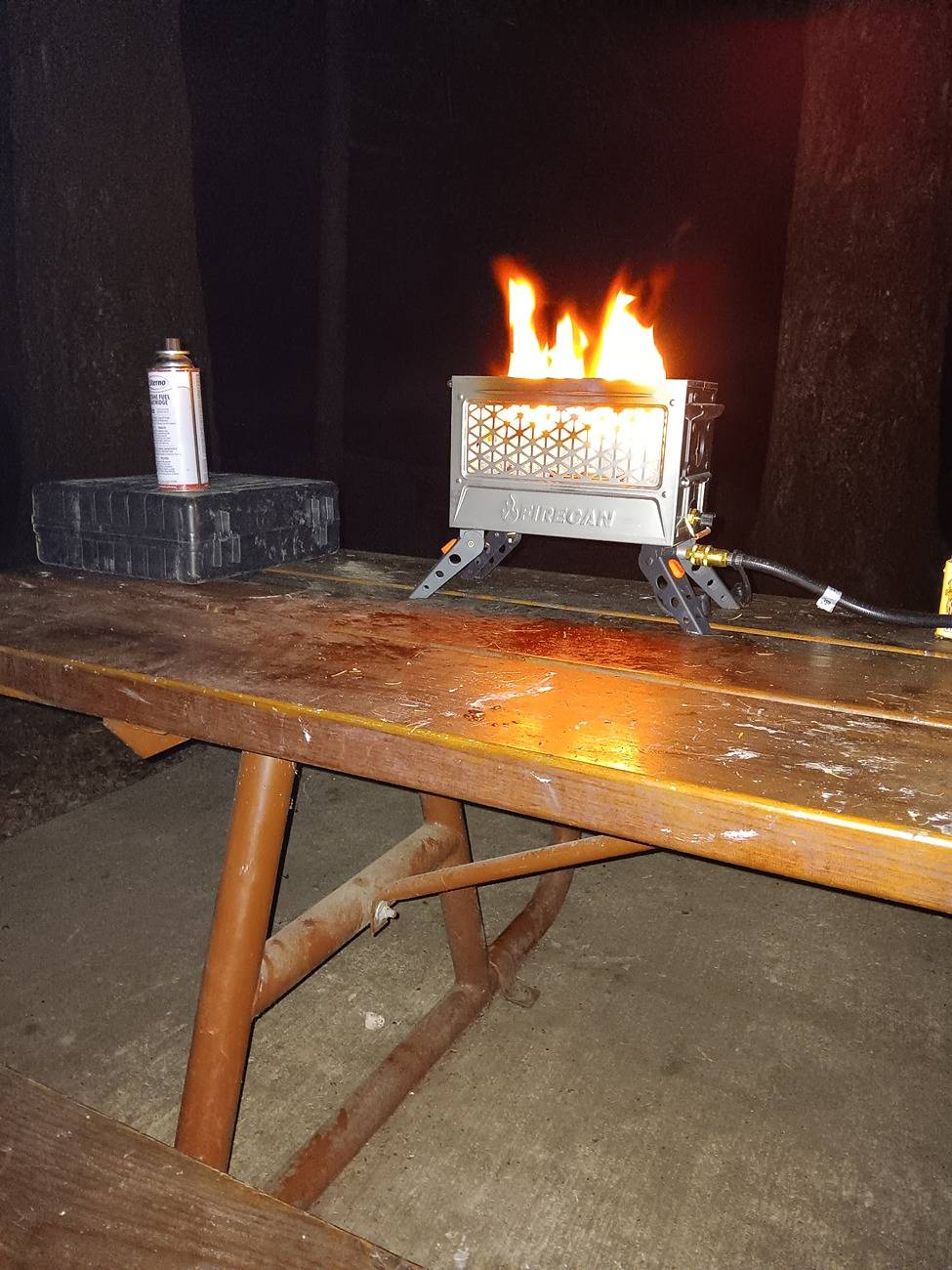

Just came back from running the Vancouver Island Grand Loop. Got to try out my new Ignik Fire Can.
Jeep Wrangler JL Propane Fire Pits 20240906_080356
Jeep Wrangler JL Propane Fire Pits 20240905_204154
The Grapenuts tin holds the lava rocks. Used with a 5lb propane cylinder. Worked great. Nice and compact, easy to pack.
