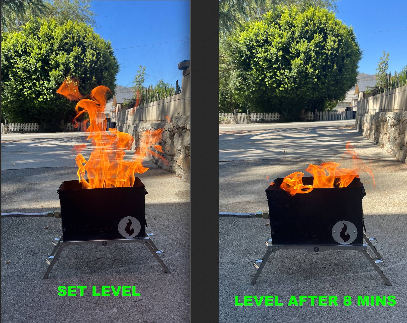

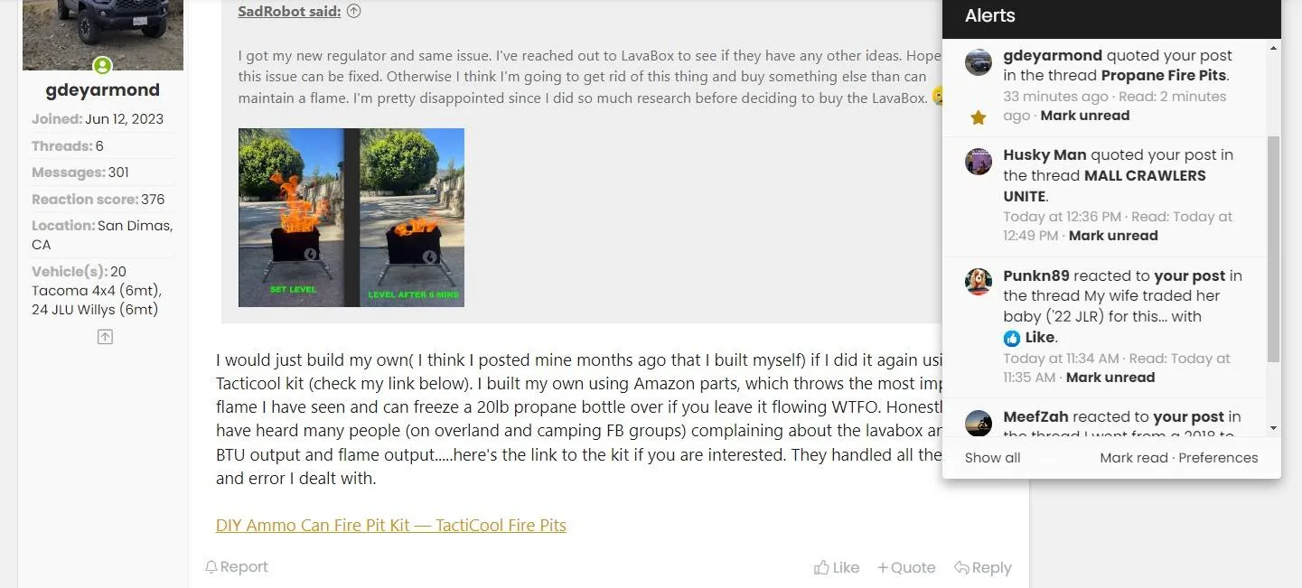

I got my new regulator and same issue. I've reached out to LavaBox to see if they have any other ideas. Hopefully this issue can be fixed. Otherwise I think I'm going to get rid of this thing and buy something else than can maintain a flame. I'm pretty disappointed since I did so much research before deciding to buy the LavaBox. 😢
Always a punch to the gut when you research and your chosen product disappoints. But it happens... I think we have all been there. Don't blame yourself...just move on and let it go. Happy with my Ignik FWIW.

Forgive if I missed it, but what size propane bottle are you using? With 1lb, 5lb, and even my 10lb, eventually the bottle starts to freeze up which reduces propane flow. Next time touch the bottle and see how it feels. You can also pour a bit of water on the bottle when the fire level drops and you'll see the flame spike back up for a bit. Only on 20lb bottles have I not seen this occur. Also, it doesn't seem to matter which fire pit you have, all mine do it sooner or later with anything less that 20lb bottles and the ones with the higher BTU do it faster.

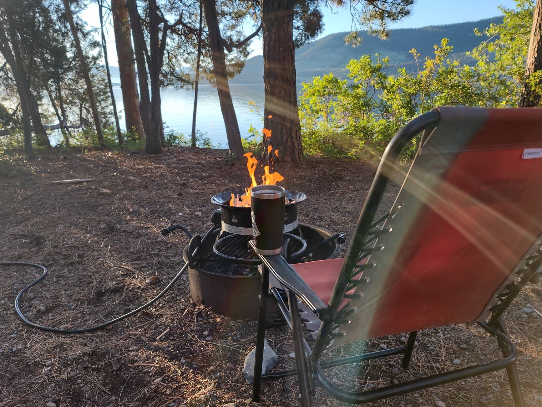

we have been using a propane fire pit for years. cheap one I got on sale at sportsman's warehouse. I even use it when there are no fire restrictions.

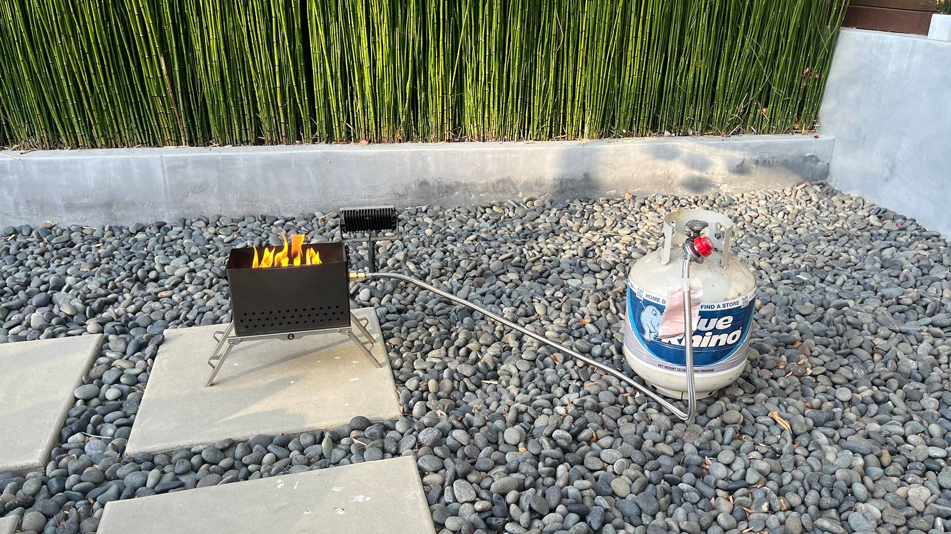

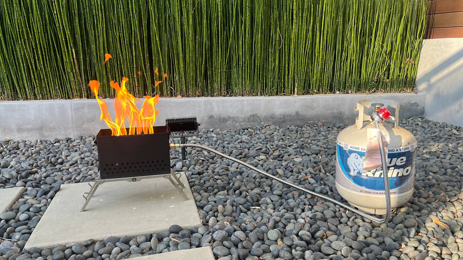

Give it a try on your 20lb from your BBQ or run it off the 5lb and then throw some outdoor temp water on it when the flame drops. Let us know!
Just did a test. My tank from my grill turns out is 15LB. I got the same result, actually maybe even worse. Flame died a few minutes earlier than the 5LB. The temp of the 15LB tank was warm not cold.
I haven't tried putting water on my 5LB tank because that seems like in a camping scenario to be worse than just leaning over and turning up the regulator.
Set height:
Jeep Wrangler JL Propane Fire Pits IMG_3873
Level after 8.5 minutes:
Jeep Wrangler JL Propane Fire Pits IMG_3877
