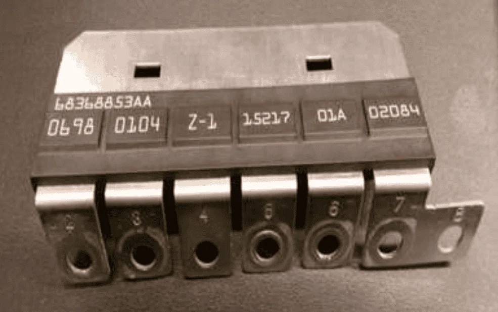

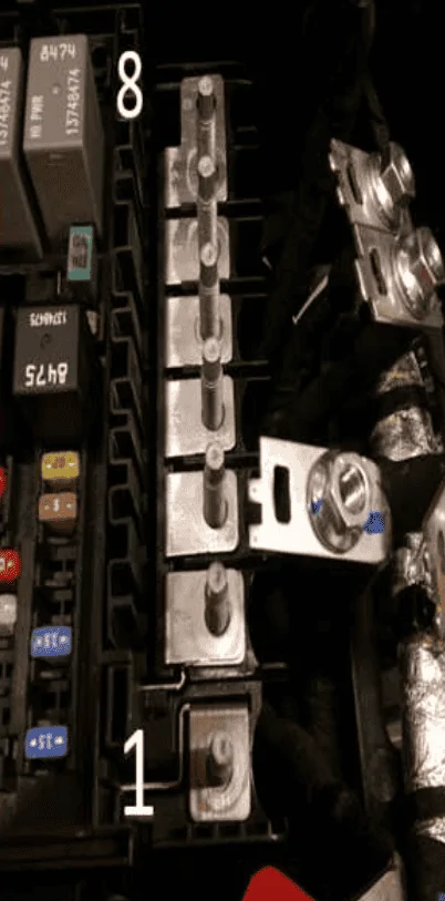

High current fuse array - charges aux battery, is fuse for alternator, powers EHPS, fan, if N3 in that array is blown, without a jumper feeding N1, the electronics don't get power either.
See my point about checking the high amp fuse array's fuses for continuity.
