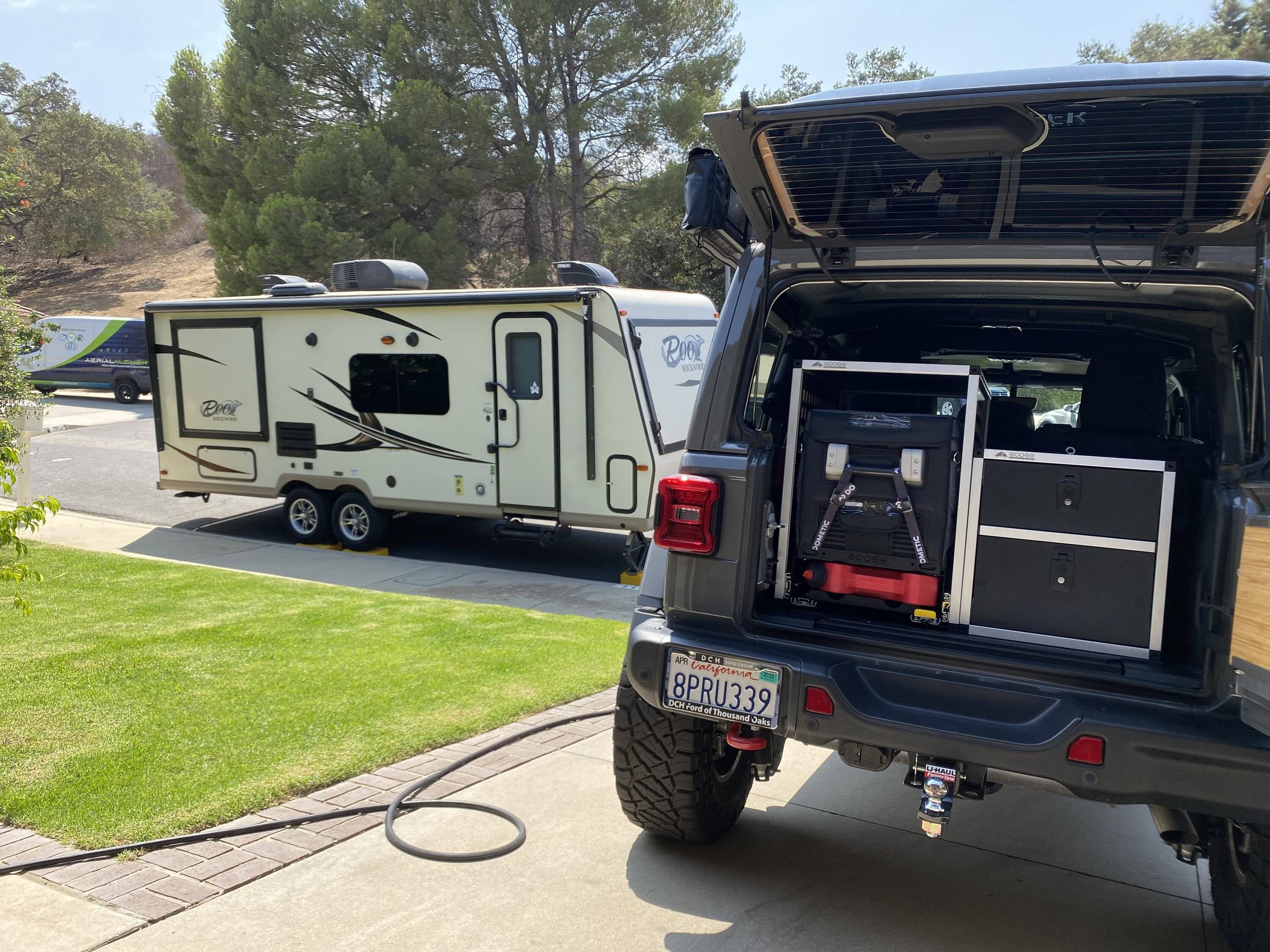

I don’t know how big my Dometic fridge/freezer is but as others have said, I’ve never had an issue with it draining the battery in the three years i’ve used it.

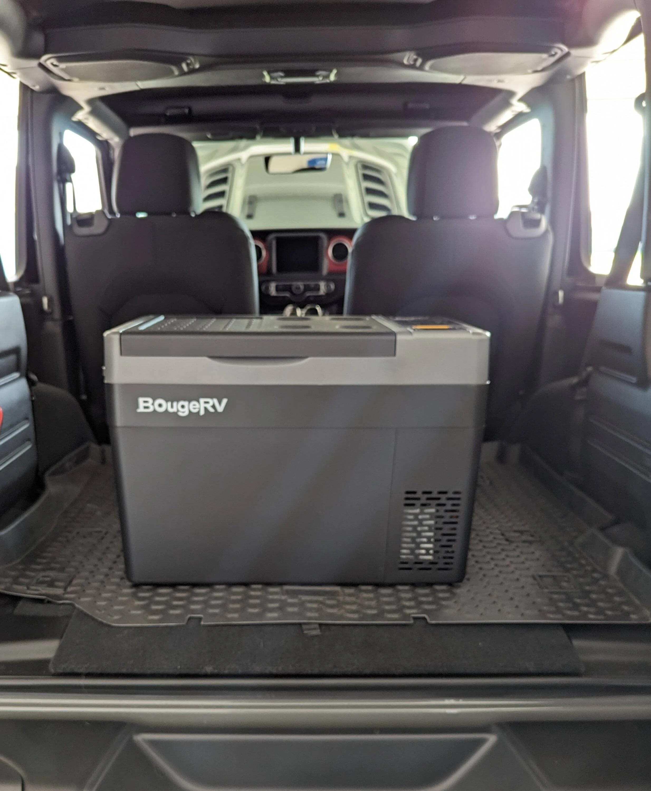

I have the BougeRV CRPRO 30. Really impressed with the performance. I use a portable power station that kicks in when the Jeep is not running.

what brand/model cargo mat is that? Looks great!
Quadratec Tru-Fit cargo liner part# 14259-1104. Looks like they are on sale right now. Some descriptions say it's for the unlimited, but it also fits the 2-door perfect with seat removed. I trimmed the lip facing the tailgate to make sliding camping gear in easier.
