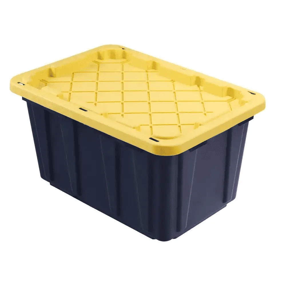

It took about two hours to cut everything to size and assemble it. It works great with these totes.
